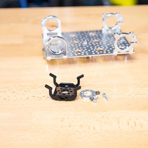

Step 2: The Magnets & Chassis
We started with an Actobotics® patterned plate for the base

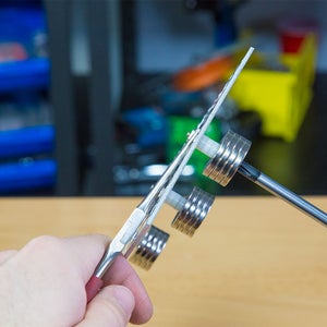

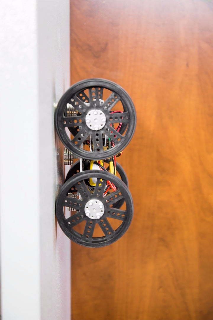

of our robot chassis. After some trial and error we found that of the designs we conceived of and tested, just having a few stacks of magnets on the underbelly of the bot was the most reliable method. We ended up with three stacks of four 1” diameter magnets. Each one is very powerful and has the power to ruin your day if you are not careful. Each magnet is rated at over 13,200 Gauss and can hold over 11lbs. So a dozen seems like overkill but we want them a safe distance from the surface they are being attracted to and they need to hold a moving object to a vertical surface. We made the stack in the middle spaced out a little further giving it more hold than the front and back stacks… this was to make turning a little easier as well as make sure the front and back stacks did not get in the way when transitioning from floor to wall.

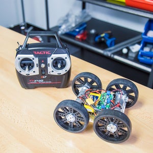

The electronics in our setup is pretty simple. We used a transmitter & receiver, motor controller and battery.

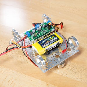

We used a breadboard mount to hold the battery (it turned out to be a very nice fit). We put a 1/8th hub spacer on the underside of the “battery” mount to space it up a bit and then mounted it to the floor of the bot.

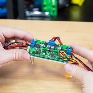

Next we mounted the motor controller (with some nylon spacers) to the top of a flat channel bracket, and used a rubber band to mount the receiver to the bottom of the same bracket. Then we used some 1” standoffs to mount that assembly to the chassis.
Channels 1 & 2 on the receiver connect to IN1 and IN2 on the motor controller. Then just connect the battery to the motor controller and connect the two motors on the left to one M1A and M1B, then connect the two motors on the right to M2A & M2B.
Step 4: The Motors & Wheels
Now I should note that Kyle and I work in R&D at
RobotZone® (RobotZone makes Actobotics parts and is a parent company of ServoCity.com). Because of this, we are fortunate enough to have access to some pre-release prototype parts. This is good because I really wanted to use our new little econ motors in this project and the new motor mounts that go with them are just shy of being released. So we used the pre-release motor mounts; that is why the front two motor mounts are different from the back two (since we had a limited number of them). Normally you’d want to use the same on all four. We attached the motor mounts to the patterned plate, clamped our motors in place, and our chassis was ready to roll.

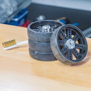

Since we were using wheels that had been in R&D for a long time, we roughed up the rubber tires of the wheels with a wire brush, then washed them off. Over time they had acquired an almost old-eraser type of smooth hardness that this process removed and gave them much more traction. We attached the hubs to the wheels and used 1/8” hub spacers in place of individual washers on the outside… that part is optional, mostly we liked how it looked.
Step 5: Prep for Launch

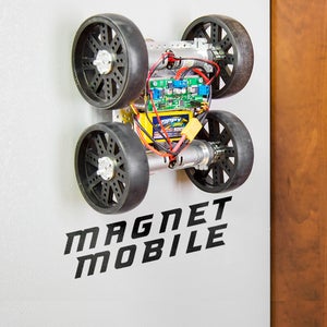

The surface you are climbing will make a lot of difference. The type and amount of ferromagnetic material you are crawling along is going to make a big difference in how much holding power your magnets have. A thin layer of steel will not have has much holding power as a thick plate of steel. Also the smoothness will make a big difference in traction of course. Dust is your enemy and will steal a lot of traction. To stack the deck in your favor make sure the surface is as clean as possible.
During testing we used an old air mattress as a safety net, it may be good to have something soft like that (such as pillows, insulation, foam, etc.) to cushion the blow should you disconnect from the crawl surface.

Once you’ve considered your surface & traction situation,
and confirmed your wiring is correct, it is time to start testing.
Good luck, and happy crawling!
