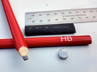

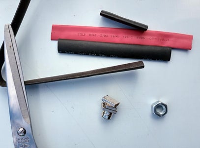

- Pens, pencils, paint brushes or anything similar of similar size you wish to add a magnet to
- electrical heat shrink tube - approx.15mm wide if flat - any colour you wish
- magnets - approx. 8 or 10mm wide, 3 or 4mm thick - depends on the strength you need
- scissors or a sharp blade
- heat gun or a candle flame
- M8 nut....but not really required (why? you're thinking)

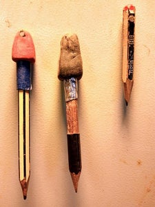

Step 1: Previous Versions
So years ago I used to drill a 3mm hole through the top of a pencil and glue a 3mmx10mm rod magnet in it. But they are hard to remove. Then I designed a 'Wegi' made from 'sugru' (air dry mouldable rubber) which was a magnet encased in this, moulded around a pencil top and in a wedge shape. The idea was the wedge shape positioned the pencil off the surface to improve pick up (I also wanted it so if you always had it on you you could place it under wobbly chair or table legs but that's another story...)
That needed some sort of consistent mould but it never came about...so time moved on.

I still wanted to magnetize my pencils, the key ingredients being a pencil- a magnet and something rubbery or flexible between. That's when it occurred to me to use heat shrink electrical tube!

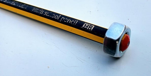

Initially I thought the tube wouldn't seal around the pencil end so I used an M8 nut to thread the end to create a more grippy surface (weird I know but why not). You can jump this stage as it seems to to hold just fine without it - unless you have particularly slippery pencils!

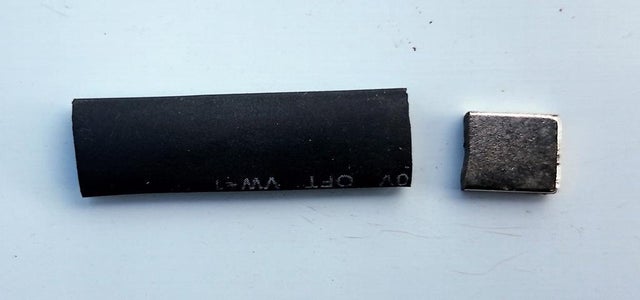

Cut some heat shrink - approx.50-60mm

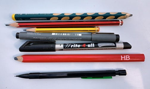

For the magnets I had some rectangular ones that were broken in half as well as disc ones.

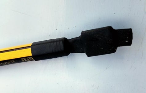

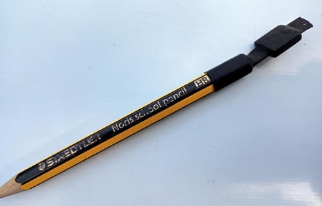

Basically assemble together - push the tube over the pencil end approx.20mm, push the magnet in but leave a gap. You want to end up with enough gap in the tube so it seals up around the magnet at both ends.
To be honest you can experiment to what suits you but I like the flex this gives.

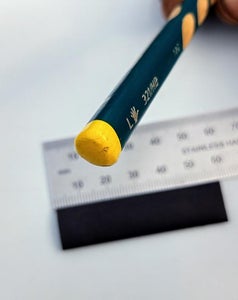

Step 3: Hot! Hot! Hot!
PLEASE BECAREFUL!

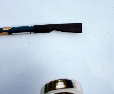

I know ...how hard can it be? Just heat the tube, it shrinks, you're done!

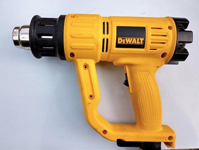

That's not the issue. If you are using a heat gun then it has a metal end - this is magnetic. You get it too close and your magnet is strong enough it'll shoot straight onto it - so be warned.

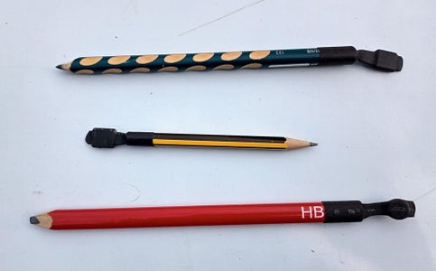

Basically your aiming to heat the tube enough so it seals around the pencil and the magnet. The excess on the tip of the magnet you want to pinch flat, preferably not your fingers, a bit of wood will do. If you miss it first time just heat the end a little more. Then you can trim the end with scissors. The photos show a couple of examples.

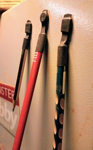

Step 4: My Pencils a Different Shape?
This is OK, they all work in the same way.
So I tried this out on carpenters pencils with an oval end and also a triangular one which is my left handed pencil.
("Left handed pencil!" I hear you cry... I know amazing... basically there's shaping in the sides to aid kiddywinkles in writing ability)
All are satisfactory.

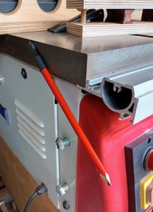

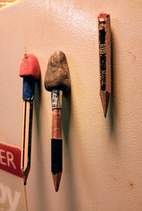

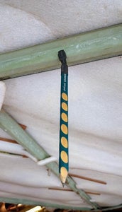

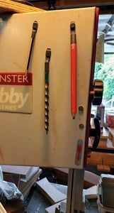

Step 5: Where Can I Use This?
That's a decision for you alone my friend.

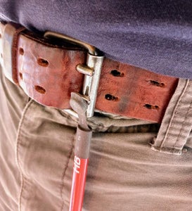

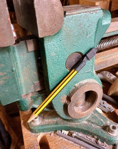

But here's some pictures of examples. We also have one on the fridge door - just need a magnetic note book...
I never did examples of pens but the principles the same. You could also use different colour heat shrink to indicate if the pencil is a harder composition, for example 3H or softer like 2B (if you use different ones). Also the advantage of the plastic covering the magnet if it ever picks up metal filings its a lot easier to remove than direct to the magnet.

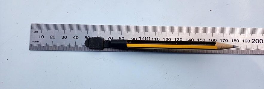

That's it, simple enough, about 2 minutes per pencil and they're pretty tough. Of course the magnet is reusable so it doesn't matter if its not correct first time or you've worn out your pencil, just do over.
