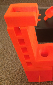

Step 2: Step 2: Assemble Marble Tower
The picture shown and the attached stl files are for the Marble Tower. Parts include: Next Top, Mid Lifts (x4), and Very Top. The Marble Tower is used to carry the marbles to the top of the Marble Ramp
I made this section of the system after the Piston Box and is easier to assemble because of the male and female connectors that I designed into each part.
Start by connecting the four Mid Lift pieces together and connect them to Next Top.
Finally connect the Very Top piece the the very top of the highest Mid Lift.
(Note: Some parts may need to be glued together to stay in place.)

Step 4: Step 4: Assemble All 3D Printed Parts
It is as easy as 1, 2, 3.
Connect the top of the Piston Box (from Step 1) to the bottom of the Marble Tower (from Step 2). Then connect the top of the Marble Tower to the topmost part of the Ramp (from Step 3).
Everything should now be connected as shown in the picture, and ready to use in the preceding steps.
