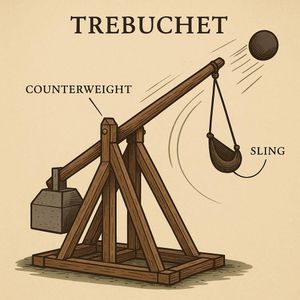

The trebuchet (also known as a trabuchet) is a type of gravity-powered catapult. Unlike earlier catapults that used tension or torsion (like the Roman onager), the trebuchet used gravity via a heavy counterweight to launch projectiles over long distances.
Main parts of a trebuchet:
  1. Swinging arm: a large beam mounted on a central axle.
  2. Counterweight: a heavy mass at one end of the arm (stone, lead, or a box filled with sand/rocks).
  3. Sling: a rope with a pouch at the long end of the arm that held the projectile.
  4. Base or frame: a sturdy wooden structure that kept the whole system stable.
  5. Trigger mechanism: a device that allowed controlled release of the arm and counterweight.

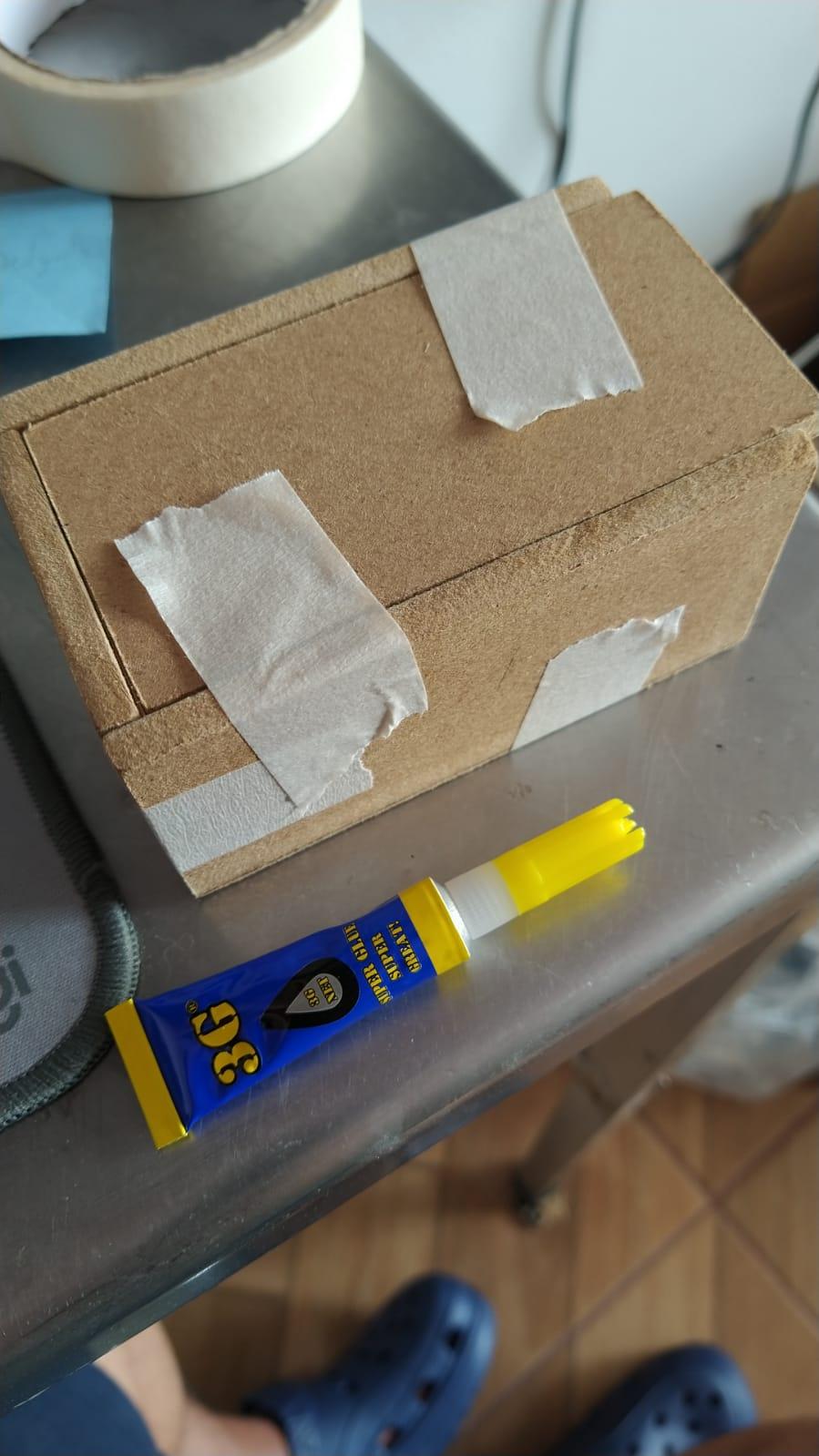

Step 4: Assembly Part 1
I divided the assembly into 3 parts to allow time for the glue to dry.
Part 1 is the counterweight box; for this, I also used tape to hold the pieces together and then fastened them with quick-drying glue.
