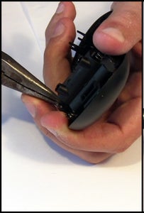

Open up your mouse. Mark the button with permanent marker, so you don't get confused later.
You should be able to remove battery connectors without soldering the cable. As I mentioned before, I did unsolder it because, I was not sure what shape this project is going to take.
See how good it fits your chosen case.
My case did not shut, because of mouse wheel encoder/sensor.
I bent it to shut the case.

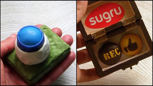

I mixed 4 parts of yellow and 1 part of blue, to get a greenish Sugru.
I attached the neck of the bottle on top of the tube.
I covered the thread with some electrical tape to keep it clean and neat. (Was not necessary)
Then, I Sugru-ed rest of the case, apart from the bottom and one side.
I wanted to be able to see the blue light when button is on.
I opened the case and tidied the edges. You want to be able to change the batteries.

As the plastic is soft and smooth, I was able to push the Sugru button out of the ring (with Sugru being set)
I did it so I can change the skin.

I also made other designs.
