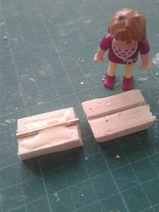

Building the barrel:
  1. Cut 2 units of balsa wood to the following sizes: L 2.6 X W 2.5 X H 1.4 (cm)
  2. Using a drill with a suitable head (see image), make a straight groove along the 2 units.
  3. Place a brass tube (see metal accessories image) in the center of the groove of one of the units, apply glue on the surface of one the units, and attach the other one to it. Wait a few minutes, then clamp gently the glued units (with table clamps) for at least 2-3 hours (see Image).
