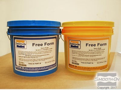

Use nitrile gloves to scoop out and make a baseball size ball of Smooth-On's Free Form Air part A. Remove gloves and put on a new set of gloves, as to not contaminate part B, and scoop out and make the same size ball of part B. Nead equal parts A and B until it is all a light gray color (completely mixed). Keep a small bucket of water handy and a spray bottle of water as the epoxy will stick to hands, with or without gloves, and it will make it easier to sculpt and smooth.

Using Free Form air sculpt out the mandibles and fangs. I pinch off a small amount and roll the dough in my palms. Lay the pieces on wax or aluminum foil to dry over night. Free Form takes 12 to 24 hours to harden. For sanding wait 24 hours.
