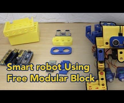

Introductions to Blocky Codes components.
I suggest you watch the video series below so you can understand the function of all the components. All the components are still in active development. So what you see on the video could be different from what you get.
We also have some others components that are still under development, such as bolts and screws, stackable LEDs, and lots more.
