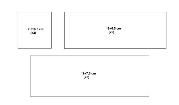

Step 6: Mark/Cut/Drill Wood to Make a Box
We're going to make a rectangular wooden box to place all the electronics inside.
Cut 2 pieces measuring 19 x 7.5cm each.
2 pieces measuring 19 x 6.5cm each.
2 pieces measuring 7.5 x 6.5cm each.
Sand and clean up the sharp edges.
![](https://content.instructables.com/FGG/DTOG/J7ARFVRR/FGGDTOGJ7ARFVRR.png?auto=webp&fit=bounds&frame=1&height=620&width=620)
Now for the front panel, you need to place the LCD and the button circuit we soldered in the last step. So measure and mark the placement of both the parts and cut off the required amount of wood such that they fit properly. Also, drill two holes for mounting the LCD using screws.
On the right panel, drill one small hole for the horn wire to pass through. On the left one, drill one small hole and one bigger for the wires from servo motor and battery.

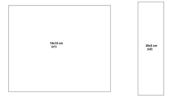

Step 12: Make a Stand for Water Spilling Mechanism
This part will be kept separate from the main box with all the electronics. The mechanism consists of a wooden base with two rectangular panels connected together, with the other one tilted such that water from the glass falls directly on the person lying below.
Cut a square base measuring 15 x 15cm and two more rectangular panels measuring 20 x 5cm each.
![](https://content.instructables.com/FBH/LE3Q/J7ARFVOK/FBHLE3QJ7ARFVOK.png?auto=webp&fit=bounds&frame=1&height=620&width=620)
You can paint all the wooden parts. I covered them using white paper.
Place the first one on the base using a metal clamp and screws. The second one has to be fixed over the first at an angle of 45 degrees. Now place the servo at the top. A big hole has to be made on the servo attachment. Finally attach a plastic cup of water to the servo shaft with a small wooden/metal piece (refer the images above).
The glass should be facing downwards when the servo is at 180 degrees position.
