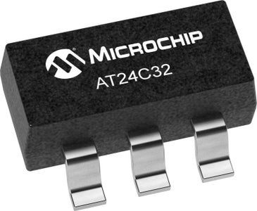

Step 2: Device Addressing
As most good projects begin, we are going to start by studying the AT24Cxx datasheet. I just want to make a quick note: If you are trying to understand how to use a device, you are going to need to put some quality time in with the datasheet. I've read this datasheet over and over, and somehow I kept on missing very important bits of information. It is helpful to know what to look for yes, but also don't slack on the datasheet studying.
Device Addressing:
This device has 3 configurable address pins, A0, A1, and A2. If we take a look at Figure 1 we can see which bits they are referring to.
Figure 1:
"These pins can be configured high or low to change the device's actual address to add up to 8 AT24xxs on the same I2C line." You can see by the binary table below in the green columns how we can configure the AT24Cxx hardware to add up to 8 different device addresses. Remember, everything we talk about is zero-indexed.
The datasheet continues, "These bits must compare to their corresponding hardwired input pins. The A0, A1, and A2 pins use an internal proprietary circuit that biases them to a logic low condition if the pins are allowed to float." i.e. if the pin is LOW, the corresponding bit needs to be low and vice versa.
Let's take a look at the hardware. Based on the board I bought, I can tell that pins A0, A1, and A2 are pulled up to VCC through 4.7K resistors, meaning that their corresponding bits will need to be high. I found this out by probing the circuit board with my multimeter in continuity mode. It looks like this:
Also we cannot forget this small line in the datasheet: Page 9 says, "The device address word consists of a mandatory one, zero sequence for the first four most significant bits as shown." With this information, we can determine what our address is. Simply start with the mandatory sequence, 1010 and add the 3 high bits from A0, A1, and A2. Our address is going to be 01010111 which when put into a binary to hex calculator it equals 0x57.
Now here is something that is very important. If you're like me, you studied up on how I2C works, and you know that I2C only uses 7- or 10-bit addresses, so why does the datasheet keep saying "8-bit address"? This is technically incorrect terminology. There's one sentence on page 9 that took me 15 reads to finally see, "The eighth bit of the device address is the read/write operation select bit." Okay so instead of calling it a 7-bit address like everyone else, they call it an 8-bit because they are including the R/W bit. Thanks for following standard terminology! This means that we can only use the 7 highest bits of the device address byte for the device address.
