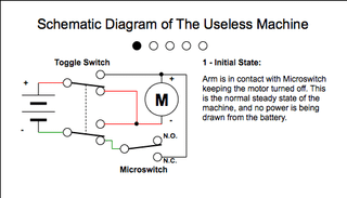

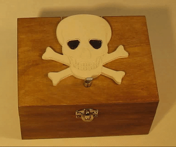

Step 2: How Does It Work?
Inside the box is an geared motor powered by double A batteries and two switches: a toggle switch on the top of the box and a micro-switch inside. That's it.
The switches are positioned to be limit switches for the motorized arm. The toggle causes the motor to reverse, while a micro-switch powers down the circuit when the arm finishes retracting back into the box.
When idle, the circuitry is fully powered down. The toggle is “Reverse” direction, and the micro-switch is being held in the off position by the servo arm.
Keep in mind the micro-switch is wired up so that it works completely opposite from a normal switch like you would find in a doorbell. By using the common pin and the normally closed pin the micro switch is “OFF” when it’s button is being pushed.
When a person turns the toggle switch to the forward position, it also provides power to the motor causing it to rotate the arm towards the toggle switch.
As the arm moves away from it's off position it releases the micro-switch providing the backup power needed for the motor to retract after the toggle switch is turned off.
When the toggle gets switched “OFF” it actually reverses the motor’s direction. The arm reverses direction returning towards it's 'OFF' position. When the arm runs into the micro-switch it stops.
The toggle switch needed is a Dual Pole, Dual Throw (DPDT) toggle switch. This type of switch is actually a pair of switches which operate together (Dual Pole) and both are On-On (Dual Throw).

Step 5: Wiring Diagram
The diagram above indicates how you will wire the motor, micro-switch and battery pack to the pins on the toggle switch. This is called 'Dead-Bugging' and is a prototyping method from way back.
It's a very simple circuit but it's easy to mess up the wiring. Follow the directions carefully or purchase the Useless Printed Circuit Board from us to speed up and greatly simplify the wiring process. And a cool LEDs to the circuit too.
Wire the gear motor to the indicated pins.
A short length of wire connects opposite pins on the toggle.
Another wire connects the other outside pins on the toggle and this wire has the microswitch in-line.
The battery pack goes to the other remaining pin on the toggle.
If you find that the motor is running in the opposite direction from what is needed, simply reverse the wires going to the motor.
tydarby posted the great graphic below, showing how wire up a modified servo . The pins to use on the micro-switch are the common (C) and normally closed (NC). Nothing should be connected to the normally open (NO) pin.

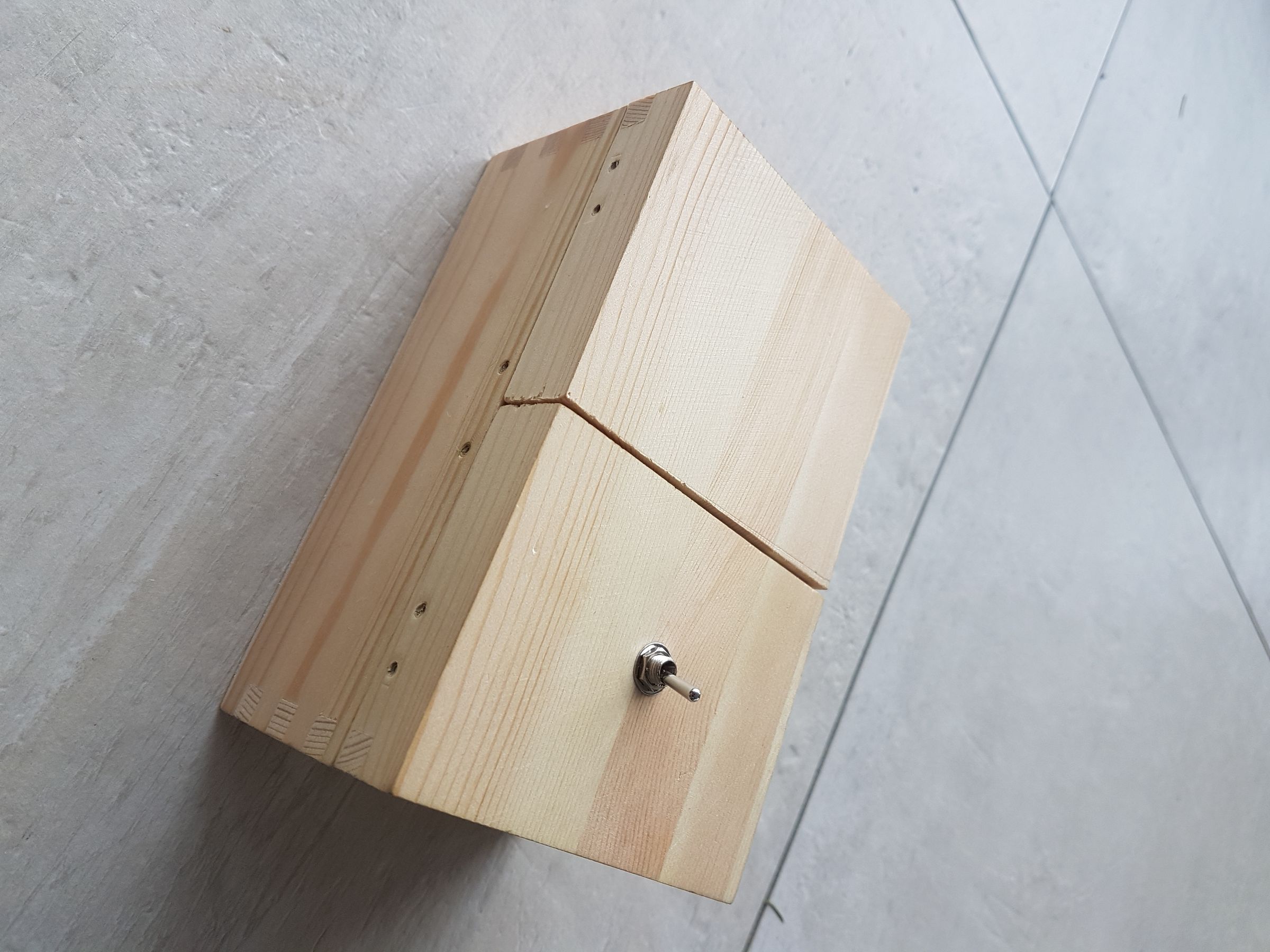

Step 10: The Box
I don't have much skill in wood working so I was fortunate to find a ready made box at the Dollar store.
Also, you can get really fancy wooded cigar humidors that make for a great box.
The box you use need only be big enough to fit a battery pack and servo. The one I used was about 5x4x3 inches.
I removed the latch that came with it. The lid was carefully cut down the middle and the hinges were move from the back to the side. A hole for the toggle switch was drilled in the other part of the lid about an inch from the cut side.
Step 11: Putting It All Together
The micro-switch will only shut off power when the toggle switch is in the OFF position.
Before you start installing the parts in the box, you'll want to make note of the direction the motor turns and in which position of the toggle switch is off.
Mount the toggle-switch and now you can align where you are going to mount the motor and design the shape of your arm. Design the arm so that when it's in the off position, it will hold the micro-switch OFF. You may need to build a stand-off for the micro-switch.
Before you put in the batteries, manually move the arm to check that it will rotate between hitting the toggle, and hitting the micro-switch.
If you are using a standard servo and 555 circuit the idea is the same. The only thing to keep in mind is that the servo arm can only rotate at most 180 degrees.
Once you have the parts installed and aligned there is some fiddling.
Power up the circuit but leave the arm off of the servo. Flip the toggle to the ‘on’ position and the servo “axle” rotates to the on position and will then stop.
Now take the batteries out of the circuit and flip the toggle to the "OFF" position. Now put the plastic actuator (with the wooden arm) back on the axle so the ‘hand’ is touching the toggle switch.
Put the batteries back. The servo will return to it’s “off” position.

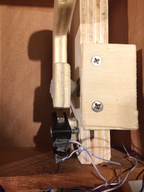

Now you can see if the arm is fully retracted back into the box. I had problems with the arm sticking up to high, not allowing the lid to fully close. Or having the arm hitting the bottom of the box.
At this point I had to tweak the shape/dimensions of the arm.
Once I had the arm switching the toggle, and retracting back into the box I mounted the micro-switch so that when the servo is in the "OFF" position it is holding the microswitch down.
At this point you should have a working Useless Machine.
