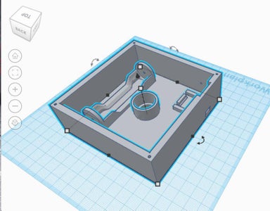

My drill weights 3 kg and runs at 1000 W, it is very impractical for these operations (I don't even need half my drill's power to apply thick wax on my car). I came up with the idea of the motorized sponge and luckily I had some motors, batteries and switches sitting on my work shelves. I immediately opened Autodesk's Tinkercad and started designing.

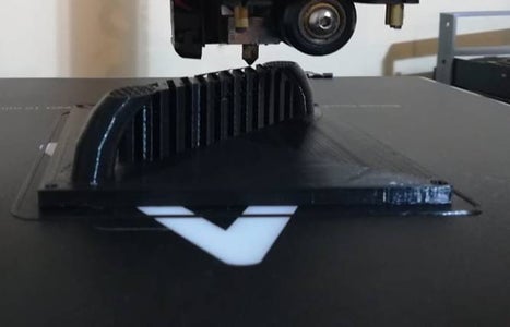

Step 1: 3D Printing

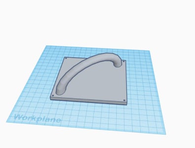

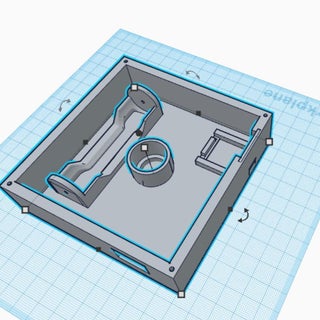

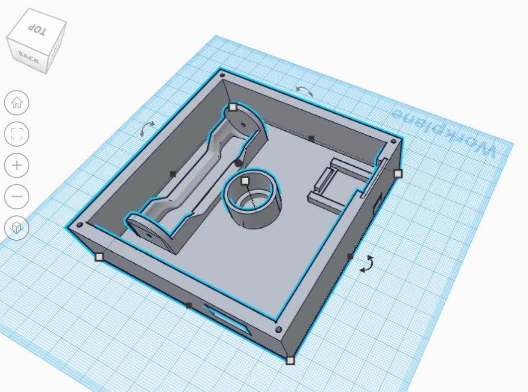

I designed the Motospog to be consisted of 3 parts:
- The sponge case "Motospcase"
- The electronics enclosure "Motospenclosure"
- The handle "Motosphandle"

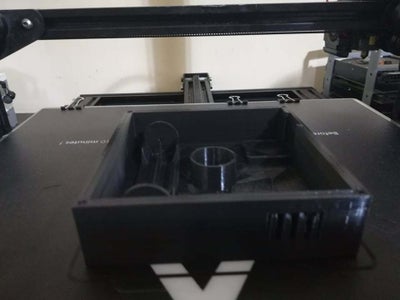

I printed all 3 parts with black PLA since it was the one I had available. However, I would use PETG for the sponge case and PETG/ABS for the handle. Follow these instructions:

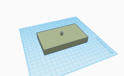

- Print the sponge case with supports and less than 20% inflill. You want the sponge case to be a light as possible so it has the power to spin. You also want the sponge case to be water resistant, flexible and durable so you would better use PETG.
- Print the electronics enclosure with supports, the infill or the material doesn't matter so much here. However, you can make the case somewhat strong and flexible for the electronics to snap-fit and to match the handle bolts.
- Print the handle with supports and more than 50% infill. You want the handle to be strong so you would better use PETG/ABS.
- You can try to print the electronics case and the handle without supports but I wouldn't suggest it.

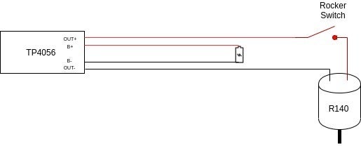

Here's the schematic of the project.
- Connect the OUT+ of the charger to the rocker switch and the OUT- to the motor.
- Connect the other end of the rocker switch to the motor.
- Connect the B+ of the charger to the positive end of the battery.
- Connect the B- of the charger to the negative end of the battery.
- The motor will either spin clockwise or counter-clockwise depending of the polarity you choose. Choose whatever polarity you like.
- The polarity of the rocker switch doesn't matter.

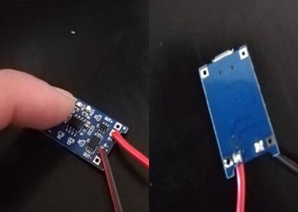

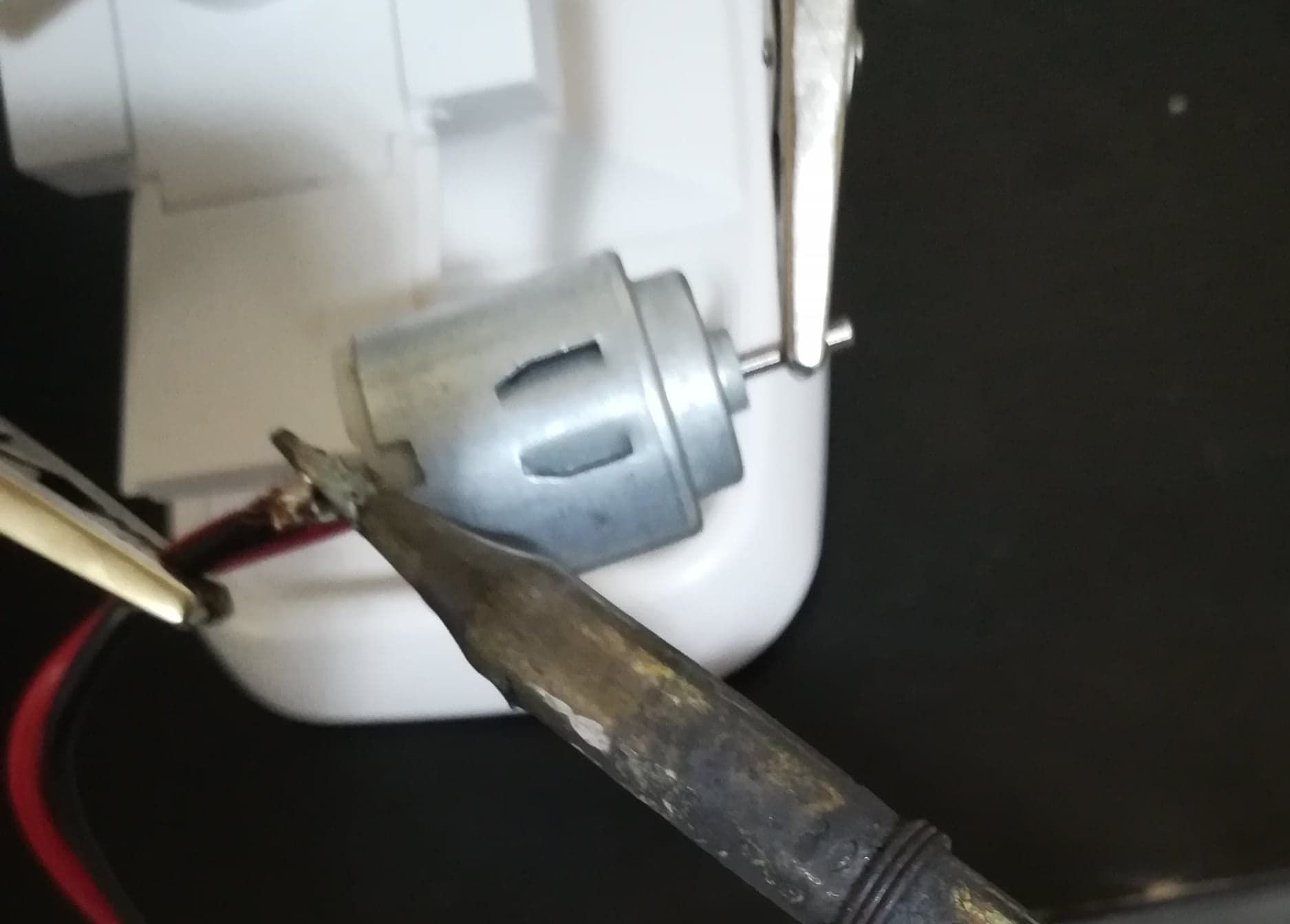

At this point you can start soldering wires to the motor and the charger. Don't solder anything to the battery or the switch just yet!
Install the wires "from the upper side" of the charger so they won't interfere with the construction (the charger would snap fit to the enclosure).
Step 3: Assembly

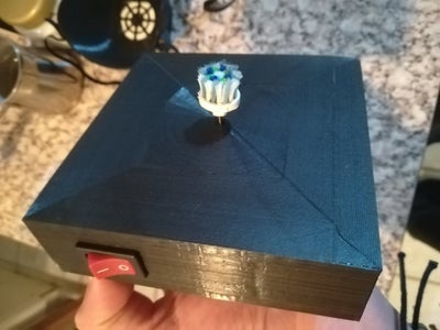

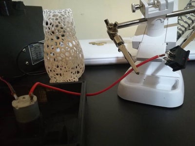

The reason why you shouldn't wire the switch yet is because the switch fits to the outer wall of the enclosure and the motor can't fit through the hole. Considering that we have already soldered wires to the motor, fit the motor to the enclosure and run the wire through the (switch) hole. It should look something like this:
Solder the wire to the switch. Repeat the process for the charger (OUT+ -> switch), the charger can fit through the hole so it's not necessary to do it in the box. Fit the switch and the charger to the enclosure, don't forget to fish the wires from the upper side of the charger.
With the switch set to 0, install two 2.5 mm bolts and nuts to the holes of the battery case. If you power the charger now, you should see a bright blue led which means that there is no battery to draw current.
Place the battery into the case and make sure that it is locked between the two bolts, wrap the wires around the bolts and trap them between the nuts and the case. Make sure that everything is firmly locked in, you should see a red led.
This means that the charger is connected to the battery and the battery is charging (there is a hole in the enclosure so you can monitor if the battery is charging or not). There is a slight chance that the battery is connected but the charger still shows a blue led, this is because the battery is full and draws no current. Turn the switch on, if everything is connected properly the motor should be spinning.

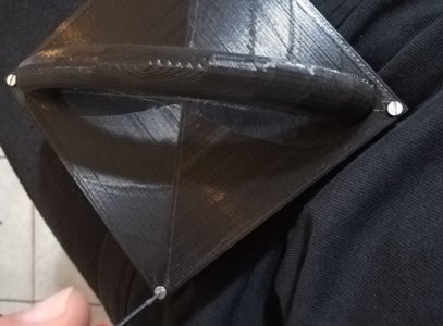

Attach the handle to the enclosure with 2.5 mm bolts.

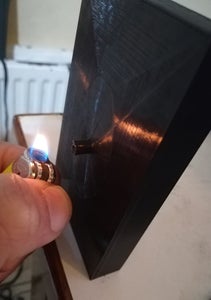

Attach the sponge case to the motor. Be careful, I designed the hole on the sponge case to be a little smaller than the shaft of the motor so the motor would fit with just a little bit of pressure. You don't want to break the case and you don't want the shaft of the motor to be loose (it will spin around itself). If the motor doesn't fit, my suggestion is to heat the hole and before the plastic starts to melt snap the motor into the hole. When this may seem like an overkill, it is a very important step to ensure that there is no power lost from the motor.
Last but not least, you have to fit the sponge into the case.

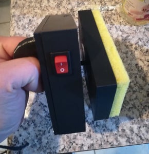

Voilà, the Motospog is complete!
