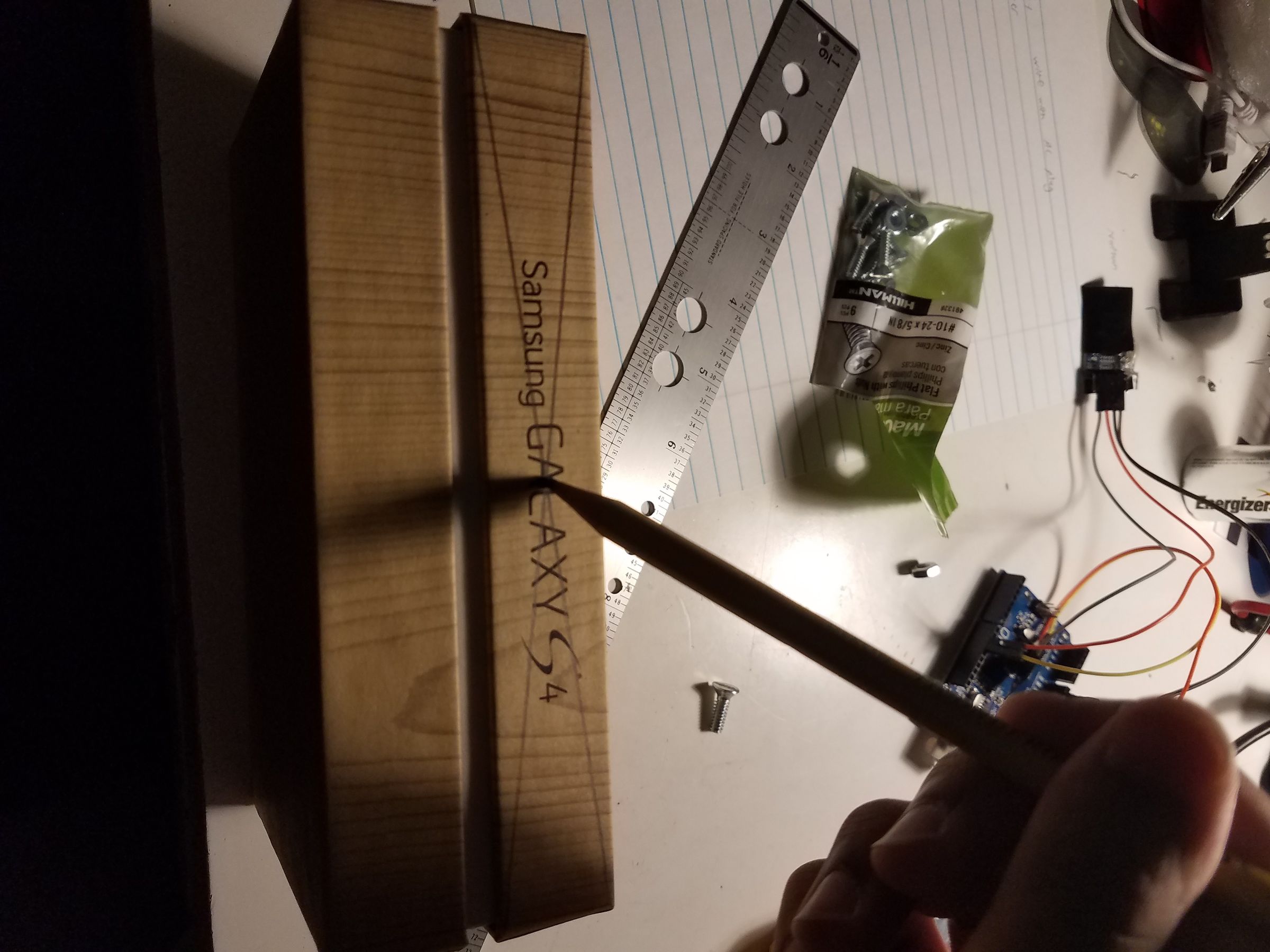

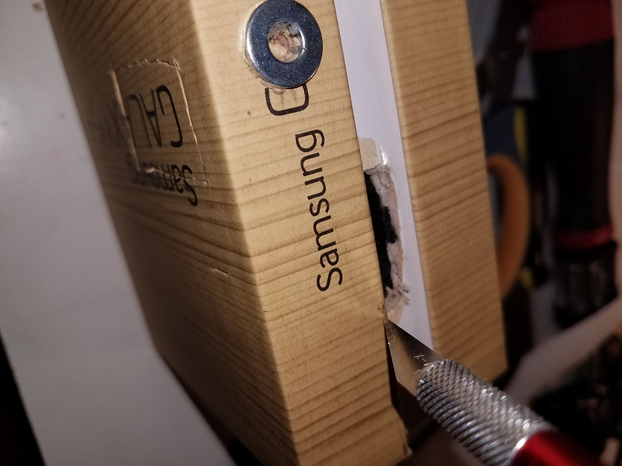

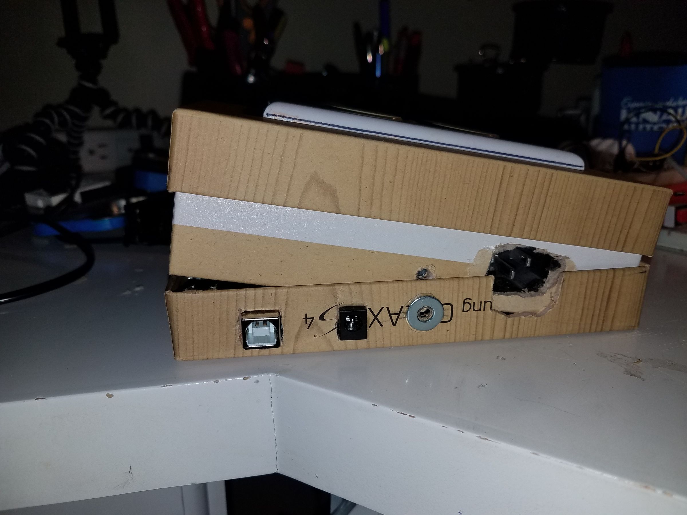

  • An empty cell phone box(6.6 x 3.9 x 2.1 inches), with a lid, bigger than the size of the Arduino Uno board, which is 7 x 5.5cm.
    • Make sure it has a removable lid
    • Make sure it has a sleeve(This is the part of the lid that is allowing the lid to hold onto the box through friction and air suction)
  • You could use some other container to pack all the components in, but make sure it isn't made of metal because we will be dealing with Alternating Current(AC).

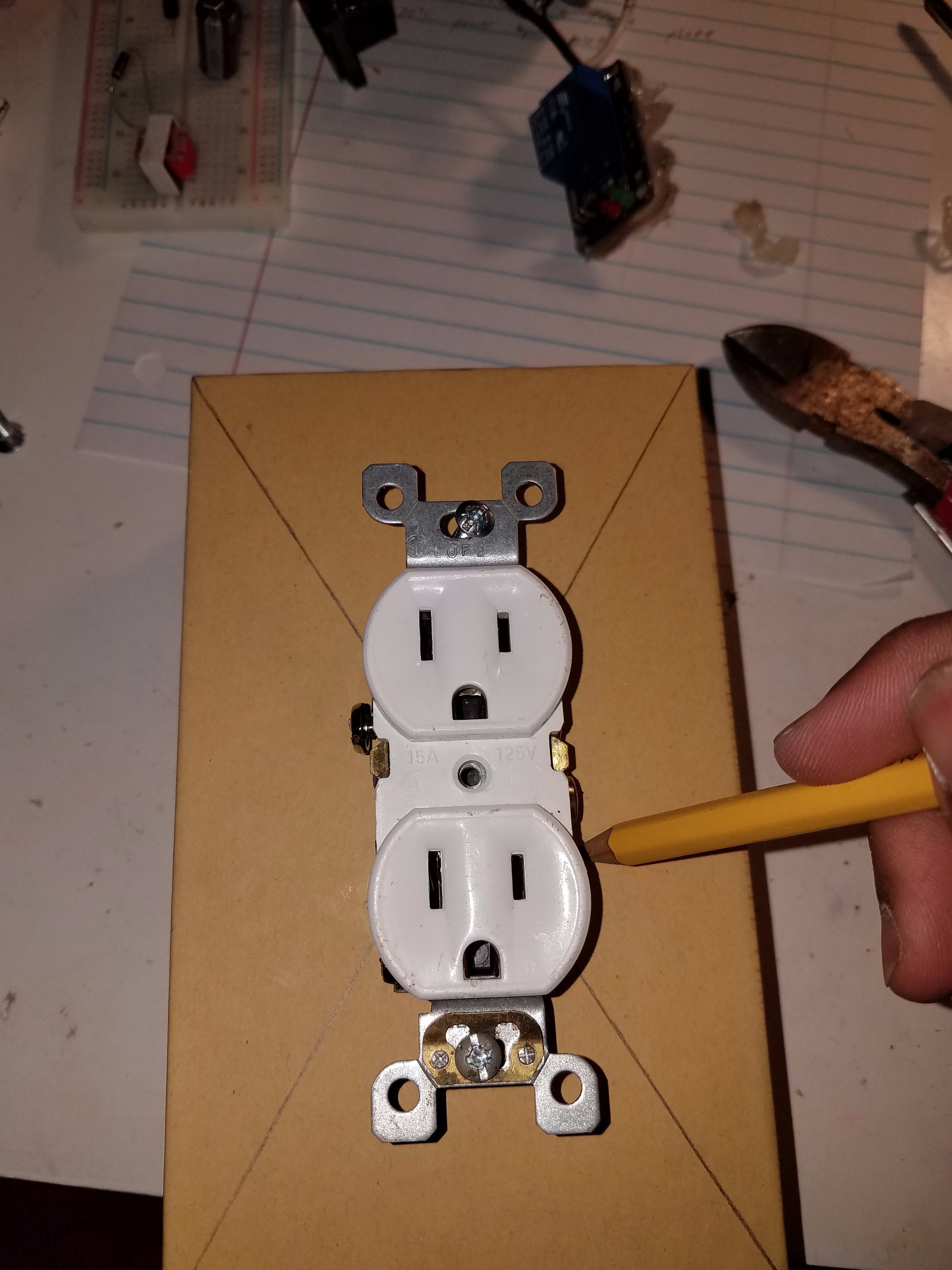

  • A wall outlet with frame plate

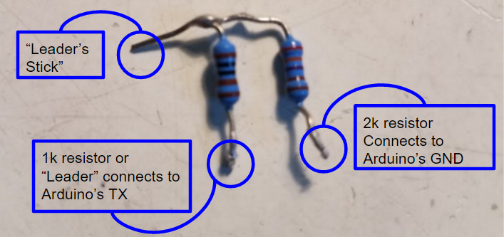

The formula for voltage dividers is(Vout=Vin*R1/(R1+R2)). We want to convert 5V to 3.3333...V and that is why we use 1K and 2K resistors. So you could use a 2k and a 4k or a .5k and a 1k. To learn more about voltage dividers check out this link.
  1. Simply take the 1K resistor and bend it in an L shape, make sure one of its legs are longer.
  2. Now, take the 2K resistor and bend a shorter leg. Solder the bent leg to the bent joint of the 1k resistor.
  3. Next, take some jumper wires and connect!
    1. Here are the Pin Locations:
      1. Arduino's GND goes to HC-05's GND.
      2. Arduino’s 5V goes to The HC-05’s VCC(+5v).
      I messed up the next two steps in the pictures but corrected it with the last three pictures. Don't worry, the steps below are still correct.
      1. Arduino's D10 goes to HC-05's TX Pin.
      2. The Arduino's D11 goes to the voltage divider which goes to the HC-05's RX Pin.
        1. The 1k resistor can be identified as number #1 or the "Leader" because it is first in line and it holds its tiny "Leader stick". The leg that isn't bent should connect to the Arduino's TX pin, which is pin D11.
        2. The 2K resistor is the resistor on the right with no stick to lead the way. The leg that isn't bent should connect to the Arduino's GND.
        3. Finally the last leg, or the "leader's stick" should connect to the HC-05's RX pin.

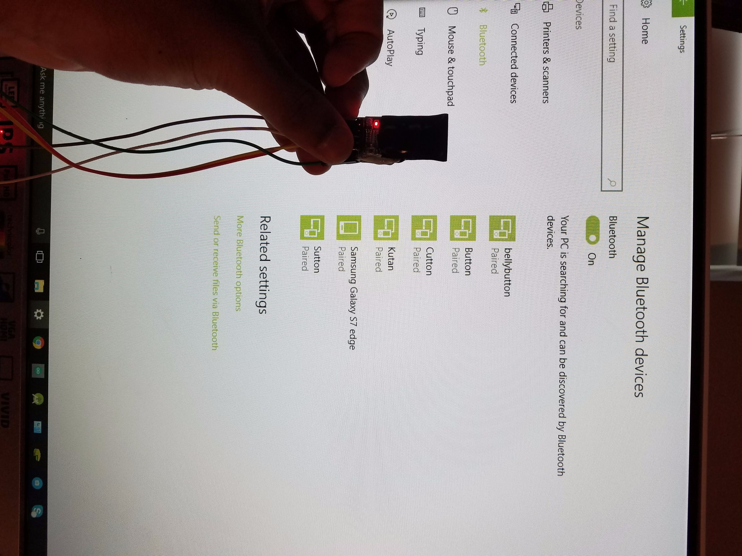

  6. Make sure your circuit is still unchanged from the previous step(HC-05's TX to pin 10 and HC-05's RX to pin 11 through voltage divider)
  7. Click upload and wait until it says "Done uploading" at the bottom of the screen.

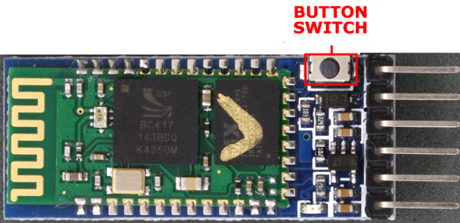

  8. Now disconnect the HC-05's Vcc(5v).
  9. Press the button on the back of the HC-05 and at the same time plug in the Vcc(5v). The LED should start blinking every 2 seconds.

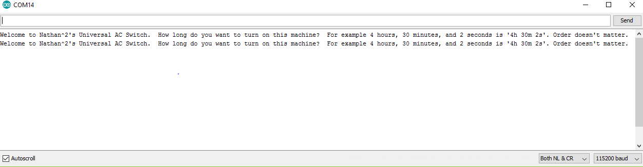

  10. Click Serial monitor at the top right-hand corner(it looks like a magnifying glass)
  11. You will see a blank white screen, but then it says "Enter AT Commands:"
  12. Make sure the settings in the bottom left corner of the serial monitor says "Both NL and CR" and a baud rate of 9600.
  13. Enter the following AT commands after getting an OK response for each command(Enter the 6 commands below. AT+NAME and AT+PSWD are optional).
  • AT
  • AT+ORGL(reset HC-05 to default factory settings)
  • AT+ROLE=0(slave mode)
  • AT+POLAR=1,0(Built-in LED setting)
  • AT+UART=115200,0,0(This is for Arduino UNO. For example if you had Nano you would say 57600,0,0)
  • At+NAME=(whatever name you want) For example, I said AT+NAME=Mutton(It will not say OK for this)
  • AT+PSWD=a 4 pin code(default password is 1234)
  • AT+INIT(starts Bluetooth)
You have just created a wireless programmer! Now let's test it.

  4. Now to use your wireless programmer you need to connect to it first.
  5. Get your Windows or Mac computer over and go to Bluetooth settings.
  6. Plug in power to the Arduino via USB to a power bank, or another computer, or use a 9V battery through the DC jack.
  7. Wait until you see the name, the one you gave your Bluetooth module, comes up on the devices list.
  8. Click on your device, in this case, mine is "Mutton". You should wait until you see the LED on the HC-05 start blinking every 2 seconds(accidentally said 1 second in the video); it means it is connected.
  9. Disconnect the Arduino's power, and then reconnect it.
  10. Click on more Bluetooth settings and click on Com Ports.
  11. Locate your com port that is labeled with "name" 'Dev B', For example, my port is 14 because it says Mutton 'Dev B'.
    1. You can delete the incoming signal for the Bluetooth device because you won't need it.
  12. Launch Arduino IDE and open the Blink example. File->Examples->Basics->Blink
  13. Go to tools and make sure the board is correct and the port setting is the one you found. For me, I will click port: 14 and Board: Arduino Uno.
  14. Hit upload and it should work! If it doesn't work keep clicking upload(It may be a timing error, but it rarely is with the circuit I made).

  1. Put the cover on the non-conductive box.
  2. Take the non-conductive box, with the cover attached, and use a pencil to sketch all four sides' centers of the Cover(use diagonals to find the point of intersection, which is the center). Draw one hole at each center for all 4 sides(NOT including the top and bottom of the cover)(See picture).
  3. Use a power drill to drill 4 holes with the cover still on.
  4. Now remove the cover.
  5. Take a screw and plug it into the box from the outside. Place the nut on the screw from the inside. Using a screwdriver, screw the screw while holding the nut.(You should get a tight fit. Look at pictures)
  6. Take the hot glue gun and glue all over both the nut and the screw, except for the bottom of the screw(The end facing the middle of the box)
  7. Continue this for the remaining 3 holes.
  8. Next, take the cover and glue a washer on each of the four holes on the outside.
  9. Now, put the cover back on.
  10. Then, screw in a screw for each hole to make sure it fits and to get rid of the excess glue.
  11. Erase pencil markings.
  12. Finally, it should look like the final picture.

  1. Put the wall outlet on top of the bottom and at the center of the box and draw an outline around it.(Look at pictures)
  1. Now cut out the closed area (which we made in the previous step).
    1. I used a power drill because I didn't have a rotary Dremel.
      1. Just drill a bunch of holes along the outline you drew with a small gap between each drilled hole.
      2. Then, using pressure, pop out the closed drilled area.
  2. Put the wall outlet, with the series circuit, inside the hole you cut out.(Look at Picture)
  3. Drill two holes for the two screws to hold the wall outlet in place.
  4. Take the plastic washers and glue them on the surface of the two holes from the inside view of the box.
  5. Screw in the two screws into the holes, and finally mount the face plate.
  6. From the inside point of view of the box, glue all over the wall outlet so that it won't fall out.
  7. Apply electrical tape underneath the relay module and around every metallic object inside the box.
    1. That includes putting electrical tape(from the inside) around the 4 screws that hold the cover in place.

  2. Place the Arduino on the top of the bottom of the cover. Make sure the inlets are facing in the same direction as the cutout of the PC's Power inlet.(Check Picture)
  3. Use any utensil and sketch an outline for the USB inlet and DC-Jack.
  4. Cut out the outlines with X-ACTO knife. To check if they are big enough just stick the Arduino's inlets through the corresponding holes.
  5. Using hot glue, place the Arduino into the area you wanted. At the same time, make sure the USB inlet and DC-jack are going through the cutout.
  6. You will find a problem with putting the cover back on the box!
    • To fix this, you will have to make another cutout, but this time, you will make a cutout on the box(not the cover)! Check the Pictures

    5. Make sure HC-05's RX(through Voltage divider) goes to Arduino's TX(D1). And HC-05's TX goes to Arduino's RX(D0).
Step 12: Your Status and Uploading the Code
Alright guys,
just unzip the zip file and upload the code from the bottom. Don't forget to include the Time Library .(To see how to add libraries, check out this tutorial)
Now, click upload, and sit back and relax as your Arduino receives HEX files streamed via Bluetooth.
Finally, download the following app from Google PlayStore- "Arduino Bluetooth Controller" by Giumig Apps.
IMPORTANT******If you want to upload again, make sure the Serial Monitor is closed before hitting upload***

Step 13: Conclusion: Tips and Tricks With Complete Manual
  1. The first step is open your Bluetooth devices and find your device.(Remember, your password was set when we were in AT Command mode-mine was 1234) "The Default password is 1234"
  2. Second, open the Arduino Bluetooth Controller App.
  3. Third, click on your device and make sure no other device is connected to it. Also, make sure the Arduino is plugged in via DC jack or USB.
    1. FYI: The USB port is unavailable because the Bluetooth module has turned your Arduino into a wireless receiver, so you can't program via USB, but you can power it via USB and then program wirelessly(As if you were programming via USB, but you are not).
  4. Click on Terminal Mode.
In the beginning, "The Final Countdown" timer will ask you how long you want to turn on your machine.
  • The annoying thing is that when you plug in your Arduino with power, the Serial spits out the Intro paragraph(which can be deleted in the Setup()).
      1. The Serial repeats Setup() every time a new device connects
      2. So every time you enter the program via Bluetooth after plugging in the Arduino's power, you will be given the Intro paragraph twice!
        1. To avoid this, enter terminal mode twice(just exit out of the program and click on your Bluetooth device again). You only have to do this once every time you give the Arduino power.
        2. This unavoidable bug happens only for the first time when your phone connects to the Arduino.
          1. There are no consequences if you enter terminal mode once or twice(It's just less annoying).
***************************************************************************************************************************** Complete Manual
  1. Timer commands
    • If you wanted a timer for 1 hour and 29minutes and 30s, you would type '1h29m30s' and the order doesn't matter. And if you really wanted to mess around you could say ' 29am 1 wh 3q,0wes ' and still get the same result; as long as the number of hours/minutes/seconds is always before the letter that stands for the unit of time, it is a valid keystroke. Except for the letters 'y' and 'v', since they have the potential to activate when the timer hasn't started yet(look below).
    • Let's say we want a Ninja smoothie maker to run for 1 minute and 30seconds
      1. We would type in '1m30s'
        1. If you don't type anything after your input, the Arduino will assume you are confused and will give you a hint. For example "Hint: Type 'v' to view timer." means when you type 'v' the Arduino will talk back to you and tell you how much time you have entered. It's kind of like an Advertisement. These are just one of the benefits to multitasking.
      2. These commands only work when the Timer hasn't started(for safety reasons)
        • How to view timer?
          • Type 'v' //You don't have to type v to start the timer; it just ensures you if what you typed is correct or not.
        • How to start the timer?
          • Type 'y' for yes.
            • A beep will follow after you start, and the LED will start to fade at a faster rate.
      3. These commands only work after the timer has started(for safety reasons, such as someone's baby clicking 'y' too many times on your phone and sets the timer for infinite(or greater than 50 days :] ))
        • How to pause/resume timer?
          • Type 'p' //spits out the time a pauses timer
        • How to reset the Timer?
          1. Type 'r'
        • How to end the Timer?
          1. Type 'e'
        • How to watch the amount of Time Remaining?
          1. Type 'w' //spits out the time and does nothing else
      4. These commands work at all times(Because it's safe either way)
        • How to turn off Buzzer(Sound)?
          1. Type 'b'
          2. How to toggle the Light? //Say you don't like the light because it's too bright. Well, you can turn it off and the timer will still do its job! Isn't multitasking beautiful!
            • Type 'l' to toggle light from Off->On->Fading
            • When paused, the LED will blink every second.When resuming, the LED will continue at its normal faster rate.
          3. Tricks
            • Let's say you wanted a time of "1m40s" but you accidentally typed "1m0s". Well, it is quite simple to fix. All you do is type "40s". Then, when you type 'v' to view your timer, you will see the Arduino say 1 minute and 40 seconds.
            • Combos:
              1. Say you are too lazy with talking with your Arduino friend and you just want to get the timer started. Well, now you can cut Arduino off.
                1. Say you just want to cook that salmon for 1 hour, 20 minutes, and 5 seconds. All you have to type is "1h20m5svy"
          4. You probably noticed that you can't type a time above 1 hour and 30 minutes. This is because I wanted to add a safety feature to this product.
            1. Ex: Say someone's baby accidentally types in '100h'. This would last 100 hours which probably wouldn't be good for the machine and your electrical bill!
            2. If you want to change this limitation, go to the "Final Countdown" Timer Code and type CTRL+F. Now search for 'maxLoad'. Now, above maxLoad you will notice three int variables.
                1. Right now, the max run time is 1 hour and 30 minutes.
              1. But if you want a maximum run time of 4 hours, you would say:
                1. int hr=4;
                2. int mn=0;
                3. int sec=0;
