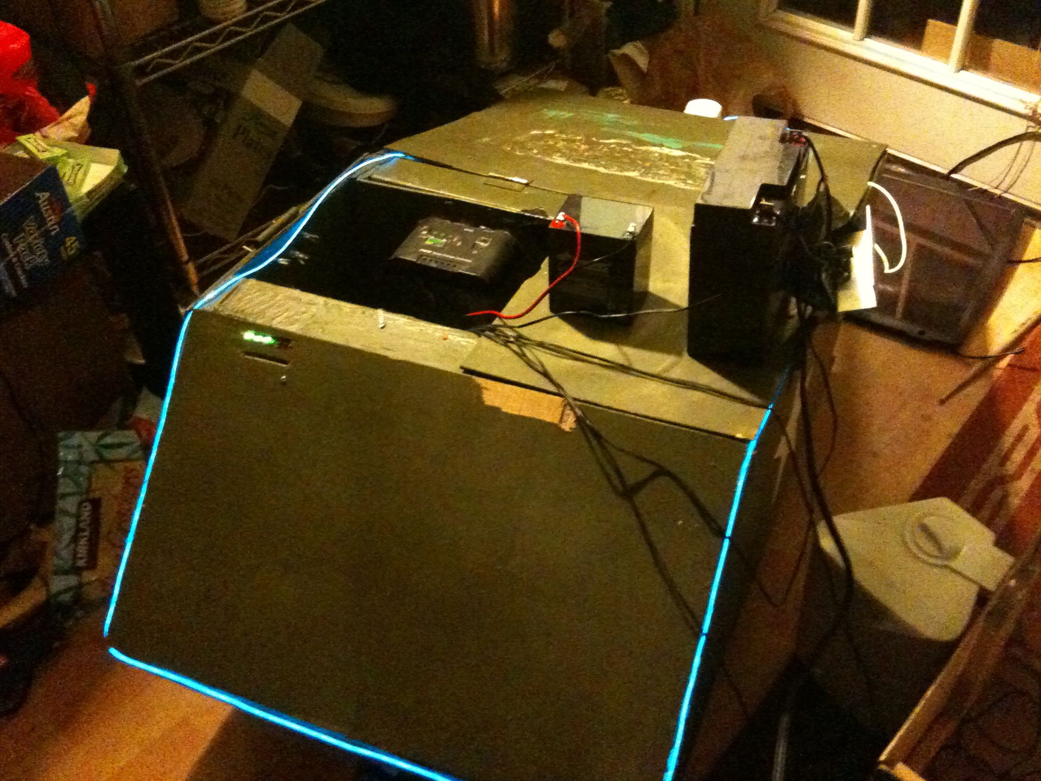

Step 2: Start the Base Structure
Much like a float in a parade, the MusicTank is constructed from a strong wooden structure covered in 3/4" plywood. The base structure was created out of 2 X 3s held together by metal supports at the stress points.
*The wood and other materials I chose to build with was influenced by the future weight of the Tank; I needed to be able to lift the Tank into and out of the car by myself so i used multiple layers of softer wood vs Treated wood or metal
Begin: by cutting out pieces necessary
1. Cut 30" of 2 X 3" wood (x 2)
this is the length of the base
+ 18" of 2 X 3" (x 2)
this is the width of the base
2. Cut 10" of 2 X 3" wood (x 4)
this is the height of the base
3. Cut 14.1" of 2 X 3" (x 2)
\---> cut the ends of these to a 45 degree angle
this is for the front panel
4. Cut 17" of 2 X 3 (x 4)
pieces for trunk
5. Cut 20" of 1 X 3 (x 2)
top support for width of base
6. Cut 21" of 2 X 3 (x 3)
this is the lower base support
Plywood
7. Cut the 3/4" plywood paneling out (x 2)
the base is 3' 6", the height is 10", top flat part is 1' 2", angled front side is 14.1", butt end is 6" high ** see picture 2 for dimensions
8. Cut the inside panel walls / Electrical housing
23 1/2" wide and 10" high (x 1)
**with a hole 2 1/4" high and 3 1/4" wide centered at the bottom of the panel wall**
-for front wheel structure support
**No hole
9. Need Steel Mending Plates:
Flat (x 6)
90 degree Steel Corner Braces (x 6)
Begin construction of the Base Structure:
Lay out the pre-cut 2 x 3s (Length and the Width of the base) with the width on the inside of the layout.(ex. picture 3)
- Connect them by applying a generous amount of liquid nails and drilling down small flat Steel Mending Plates(see pic. 4) on both sides. 2 holes drilled on top and 2 on the bottom stager the screws so that they do not hit each other -----> that means 4 drill holes on each side 16 in total. This is the base support for the whole tank and it needs to be strong!
Next liquid nails and place (x 4) 90 degree Steel Corner Braces on the inside corners of the base structure. drill screws into the Length 2 x 3 only. not the Width because there will already be to many screws from the Steel Mending Plates
[Pictures will come when i rebuild the tank]
Move up: add the Height to the base structure
place the first two of the 10" 2 X 3s go 12" back from the front of the structure, flat against the sides of the structure perpendicular lengthwise to the front. *Use 90 degree metal frame supports to secure the 10" 2 X 3s in place
the second two 10" 2 X 3s go 22" back from the front of the structure, oriented in the same direction as the first two *Use 90 degree metal frame supports to secure the 10" 2X 3s in place
Add the top support for width of the base
Take the 20" 1 X 3s and orient them so they are perpendicular and flush with the vertical 10" 2 X 3s
once you have this mark it with a pencil on the vertical 2 X 3s and place a 90 degree metal frame support under each 1 X 3 and drill it into place
*remember must be flush with the top of the vertical 2 X 3s or else the turret of the tank will sit securely
Finally set in place the plywood panel wall / electrical housing
-align this flush with the inside of the front vertical 10" 2 X 3s and MARK it with a pencil on the wood. **!!Do NOT nail this in yet, if you do you will have trouble setting in place the front wheel structure!!**
-but it is necessary to mark where to begin placing the lower base support (the panel might need to be sanded to fit, you want it to be snug)
-the plywood panel with the hole in it is to be placed in the Front
-the plywood panel without the hole in it is to be placed in the Rear
Next add the lower base support / electronic housing:
1. From where you marked with a pencil place the first of the 21" 2 X 3s
2. Place the second and third of the 21" 2 X 3s flat next to the first
*refer to the 7th picture for placement
3. Secure these 2 X 3s with a combination of nails and liquid nails
-put liquid nails in all of the crevices and angles making the wooden structure a solid and strong unit

Step 3: Hinged Door to Electronics and Trunk
The final part of the tank base construction is creating the hinged top and trunk. This provides protection for the electronic components while offering access and storage.
The top hinged door has pretty simple construction, using two 2 1/2 " x 3 " nickel plated hinges (or 4 for more stability) the hinge is positioned at the center of the plywood side paneling. The plywood top is cut into 2 pieces which open out
*place small blocks of spare 2 x 3 wood on the other side of the plywood when you drill these hinges into place (for support), you do this because the hinges and plywood top will not be able to support the weight of the tank (its too thin)
the trunk is created using the 17" pre-cut 2 x 3 to make the base structure longer. You need to align the 2 x 3s in pairs (as shown in picture 3) The bottom 2 x 3 should lay flat and the second should sit vertically on the edge of the 2 x 3----> this should look like a capital L ! (see picture 3) these will sit on the base structure of the tank, flush against the back plywood wall
Set these 2 x 3s in place with liquid nails and allow to cure
once the wood is cured together you should nail the lower trunk support into place one or two medium size nails evenly spaced should make sure they never come undone :)
The plywood base of the trunk rests atop three 2 X 3s spaced 6" apart from the edge of the trunk see picture 4 and the note in the base construction section of this instructable.
TRUNK:
- the trunk opens upwards so that you can store the ipod dock for travel as well as whatever else will fit; this is made possible by having the top of the plywood trunk attached to the base structure with 2 sets of nickel plated hinges (the same as was used in the Electronics door)
- the flat area of the trunk door is 18.4" x 24", cut this out of a plywood sheet
-also cut 2 more 17" 2 x 3s and set them with liquid nails a half inch from the 18" edge of the plywood cutout
-once the wood is set you can drill into place the hinges, allow enough space when placing the hinges so that the trunk can open smoothly and without trouble. Make sure the side with the 2 x 3s is facing down, the 2 x 3s will guide the movement of the trunk better.
**check out my Google Sketchup 3D model of the musictank for more info**

Step 8: Upgrade the System to Mk.III
The third upgrade to the invention the MusicTank, the Mk. III if you will features cosmetic upgrades galore as well as batter circuitry for a more "mature" circuit.
New features to the Mk. III:
- Bigger more powerful Battery Well
- Total control of electronics through the trunk
- On / Off toggle switch and a protected circuit
- Household power ! by the means of a 2 plug 400 watt inverter
- Arduino controlled light system
ready for it....
-A firing cannon
( an electronic air solenoid cannon )
It's KING, but with Great power comes Great responsibility :)
