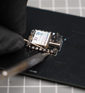

Step 4: PCB Assembly
I used the hand soldering method to attach an LED to the PCB. First, I melted some solder on one pad of the PCB and placed the LED on it while keeping heat on the pad. After that, I connected the remaining pins. This made soldering the LED much easier. also, I used the same method for soldering the XIAO

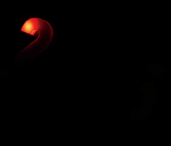

Step 6: Final Test
I used the USB port of the XIAO for powering this PCB. i tried different LED light patters that available on the WLED app
