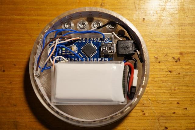

Step 5: Fidget
Now, we will work on the part of the fidget that houses all the electronics, that is, the top part.
Place the top part of the fidget in front of you facing the inside and having the charging towers face left. Connect the cables of the mini USB plug as follows from top to bottom: black, white, green, red; and add one cable to the red cable; there is an extra hole for that. Later, solder this cable to the battery charging breakout board and ground the board on the Arduino.
Use the M3 nuts and M3x4mm bolts to secure the cables. Clean the inside of the towers if there is loose or deformed material inside from printing the overhang. Use a longer M3 bolt to drive the nut into its place, enough so, that you can still push the cable into the hole below the nut. Then drive the nuts down all the way and secure the cables. Make sure there is only blank wire between the nut and the tower. Keep the blank wire short. If it's too long it may curl up around the bold, when fixing it, which we don't want to happen.
Connect the Arduino Nano to the mini USB plug. Push the Arduino inside its proper place. Push the battery charging breakout board into its proper place. Finally push the MPU6050 breakout board into its proper place, next to the battery, on the right side. Have the MPU6050 face up. On the MPU6050 have the X-axis point to the right and left.

Wire all cables around the battery compartment when you solder them on. Make sure there will be enough place for the LED stripe around the inside of the fidget, should you remove the stripe while you solder the rest. Keep the cables as short as possible. Ground all components on a common ground.
Step 8: Battery Charging Breakout Board
As I have mentioned before, at the beginning, solder the extra cable we add to the charging tower to IN+ on the battery charging breakout board. Ground it in the next step. IN- and BAT- are the same.
Solder BAT+ from the battery charging breakout board to VIN and ground the board on the Arduino. If you are using an Arduino Nano 33, bridge the contacts marked VUSB on the back of the Arduino with solder. The contacts are between RST and A7. For more information why this is required, please visit: https://support.arduino.cc/hc/en-us/articles/360014779679-About-Nano-boards-with-disabled-5-V-pins
Make sure your Arduino can run with 3.7V. My Arduino Nano was meant for 5V but it works quite well for a few hours.

Now, solder + from the LED stripe to BAT+, DATA to D6 on the Arduino and ground the LED stripe.
Step 12: Battery
Now, connect the battery to the MOLEX plug and place it inside the fidget.
