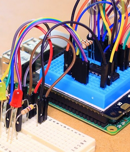

Step 2: Circuit Diagram
This is the circuit diagram for the project.
Resistance with LEDs are optional but safe to use. You can also use only one resistor in the Ground pin of each LED as we are not going to use more than one color in same time.
Add a HC-05 Bluetooth module with the Arduino to communicate with the app.
Connection with Arduino and Bluetooth module:
1. Arduino 5v->HC-05 VCC
2.Arduino GND ->HC-05 GND
3.Arduino Tx ->HC-05 Rx
4.Arduino Rx ->HC-05 Tx

5. Make the circuit as shown in the circuit diagram.
6.Put the LEDs into the holes.
