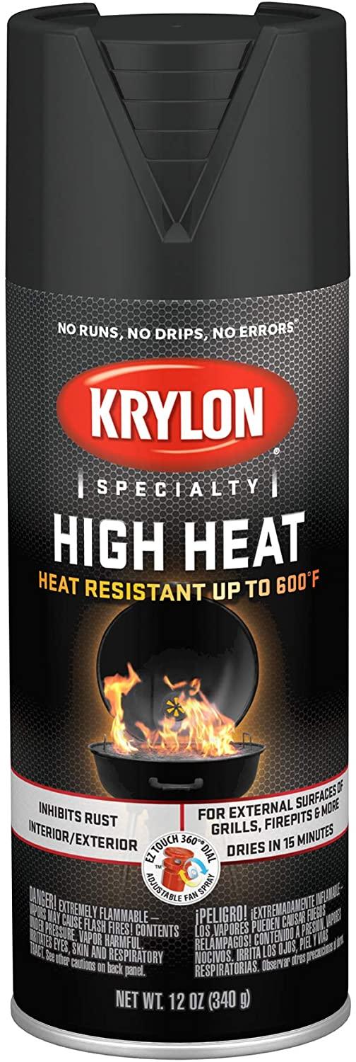

(If you can't find aluminum cookware that is already painted in a dark, matt color then you'll have to chase up some flat black enamel spray paint. Preferably some of the 'High Heat' spray paint. Keep in mind that you're cookware will not get as hot a boiling water, so 'high heat' paint is not a necessity, but it doesn't hurt.)
Flat black enamel spray paint: $4/can.
