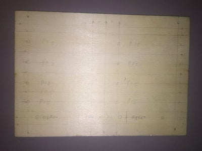

Step 2: Cook the Crust
This display is made out of a 1/8 inch board. It worked OK, but I had trouble with the final lettering. If I were to do this again I would look at either other materials or a different type of ink.
You will need to make a rough layout of where you want the lights and buttons. Using a light colored pencil and a ruler, draw guidelines marking where the lights, buttons, and lettering will go.
Once you have your design laid out you will need to drill some holes. For the LEDs, I used a 3/16 inch drill bit and a 1/16 inch drill bit for the leads of the buttons.
Insert your LEDs and glue them down. I aligned the anode leads to the inside and the cathode leads to the outside. This made it easy to wire everything together. Before you start wiring everything together, write your pie choices on the front of your display board.
