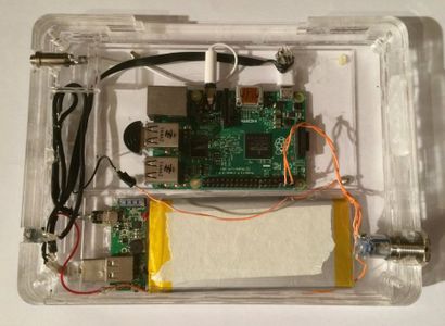

Step 3: The Power Supply
The easiest way to do this is to make use of those cheap usb backup power packs that you can get off amazon for under £20. However being the ambitious person I am I decided to make my own...
I wouldn't recommend this for people who are not experienced or skilled in the art of not blowing up a lipo and general soldering techniques.
For my tablet I decided not to use 18650 li-ion cells and use a 2s 5000 mah battery from hobby king. This is because the battery from hobby king fits perfectly in my case and is a whole lot lighter when compared to an equivalent setup of 18650 li-ion cells.
Most single board computers like the Raspberry pi require usb to power them or 5v at around 1-2A. The battery from hobby king was a 2s meaning it was 7.4v and only 5000 mah so to increase capacity and half the voltage I changed the cell arrangement to be wired in parallel. If you are going to try this make sure when modifying the battery that you don't short the battery or overheat it.
NB:Modifying lipos is like playing with bombs.
After the modifications are complete the new battery will now be a 10000mah battery running at roughly 3.7v. However the Raspberry pi won't take a varying 3.7v input so I used a cheapish charging circuit which does a few things. Firstly it allows for the battery to be charged with a micro usb plug and secondly it takes the varying voltage from the battery and uses an inline regulator to create a constant 5V supply.
Finally I soldered on an opposing battery connector onto the charging circuit while also soldering on the negative lead of a micro usb cable to the negative output on the charging circuit. The positive output will need to be soldered onto the common pin on switch and the positive lead of the usb cable will need to be soldered onto the other side of the switch. Remember to allow enough slack in the wires so the components can be fitted easily in the case.

The top half of the case is where the screen sits and is also where the machine screws will be fitted to fasten the whole case together. For the bottom half, I started from the bottom up. First the parts are test fitted on a jig using the 4 machine bolts to make sure the parts fit well. Next stage by stage, each layer is glued using a few drops of super glue and every layer is checked so that the case is square.I didn't glue the middle layers so that I can easily open up the case if I want to change out the board or change the battery etc.
To mount the pi, first bolt on mounting screws to the pi, apply a bit of super glue to the heads of the screws and place the pi in the recess in the case, and glue the screws in. This means it is easy to mount and unmount the pi in the case and this method will work with any single board computer as long as it fits in the recess.
Next all the ports are fitted to the case. The usb port simply slots into the topside of the case and is stuck in with a few drops of super glue. The charging port, which is the micro usb port, is glued into the little slot on the side, and finally the audio port is screwed and glued into its corresponding slot.
