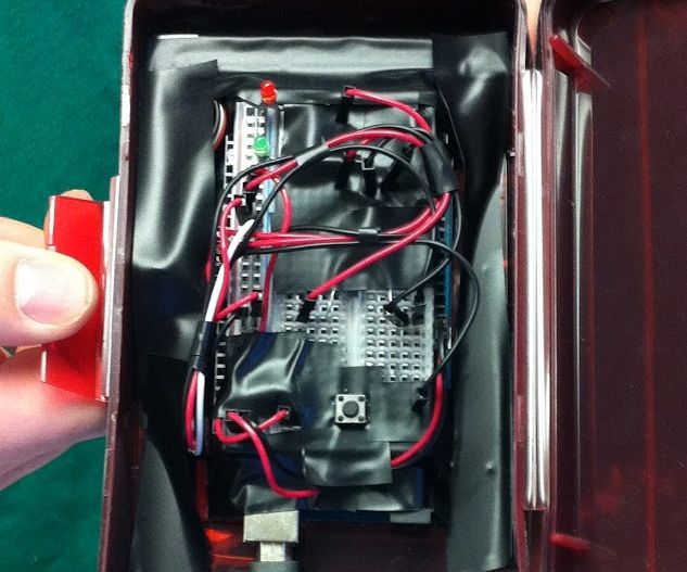

Step 2: Preparing the Enclosure
The first step in the construction of your very own Plant Buddy is to prepare the enclosure (conduit box) for the various LEDs and electronics that will need holes to access the outside. We used a 1/4" drill bit to drill 6 holes on the top ( 4 LEDs, 1 photo resistor and 1 potentiometer), one hole on the left side for the power cord, and two holes on the right side for the servo and soil humidity wires to pass through.

Step 4: Wiring
We have provided a fritzing diagram to assist you with wiring up your Plant Buddy. Wire lengths are up to you in order to suit your personal application. You will need to use 19 m/f jumper wires to extend the components to where they need to go.
We decided to connect the components using jumper wires because it would be very hard to make the project look good if everything was connected directly to the beard board. We also wanted to make sure some of the parts were getting analogue connections, because that was needed for the system to work correctly.
