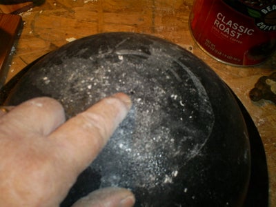

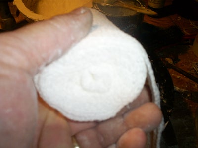

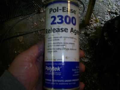

Spray your mold with Slicker Mines silicone based makes it nice and slick mix your plaster and brush the inside of the mold with the first coat after the first coat starts to set up lay in your gauze and mix up another batch quickly brush it in your mold and get ready to mix another batch .
I put 5 layers in my sphere with one layer the 4th layer being a build up on the edge so that when i meet up the edges they have something to rest upon each other just the brushed edges would be to thin to hold up .
