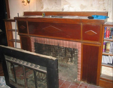

The initial plan: Remove the dark paneling, patch and paint walls, get the chimney swept, reface/redo the mantel ... have some awesome fires!

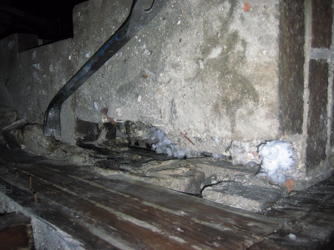

No fires for me: Turns out the firebox was in miserable shape (cracks in both back corners, loose bricks, failing mortar) and there was/is no liner in the huge three story chimney. I resolved the by rebuilding the firebox with my poor masonry skills and converting to a pellet stove insert. I did pay for that installation to be done.

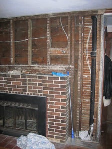

The unplanned demolition: Removal of the paneling revealed several things, which included, but was not limited to the following:
1. Old wallpaper ... some of which would fall off easily ... some which would bring plaster with it.
2. Huge plaster cracks, loose plaster, plaster that immediately fell off the wall, and missing plaster.
3. Smoke damage
4. Loose bricks and mortar at the top of the fireplace.
5. The fireplace actually looked like it had shifted away from the wall over the past 90+ years.
It was going to be easier to just gut the wall than try to repair and patch this nightmare .. messier, but easier.

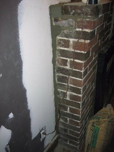

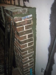

My repairs: I'm no DIY pro, but here is a quick list of what I did:
1. Gutted the entire wall and removed all loose bricks/mortar from the mantel/surround.
2. Lagged the fireplace to the framing to keep it from moving any further then filled all the gaps with concrete.

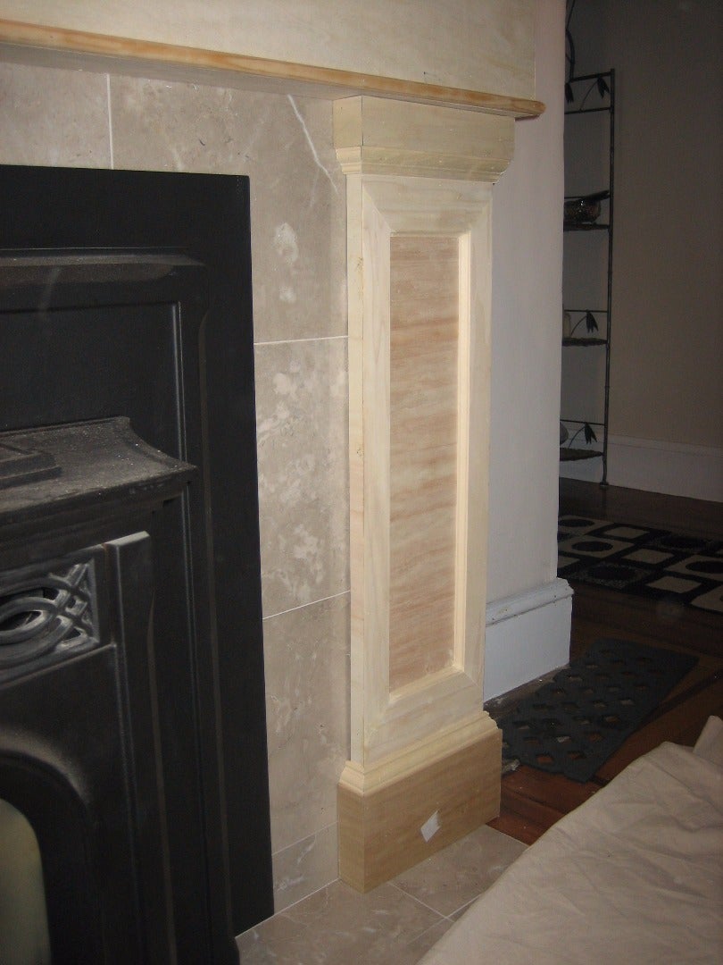

With the prep work out of the way, it was finally time to start fabricating the new mantel. I'm using 1/2" poplar plywood (2 sheets) for the bulk of this project because it's affordable and paints well. In addition to the plywood, I'm using solid poplar for molding and a prefabricated dental crown molding. Total material cost was $117 and $50 of that was the crown molding.
I'm starting with the columns since the header will be sized in relation to them. As previously stated, I didn't have a router, let alone a router table at this time. Stick and cope and raised panels were way above my skill set.

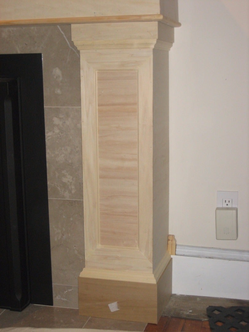

All my measurements were decided as parts were made as I was essential wrapping an existing structure. Since I was starting with the column fronts ... height had to be from the floor to at least 1/2" shy of the bottom of my "subheader." The width had to be 1/2" overhang on the outside edge (to accept the side panels) and wide enough to cover the edge of the marble tiles. No major planning ... that's just what it is.

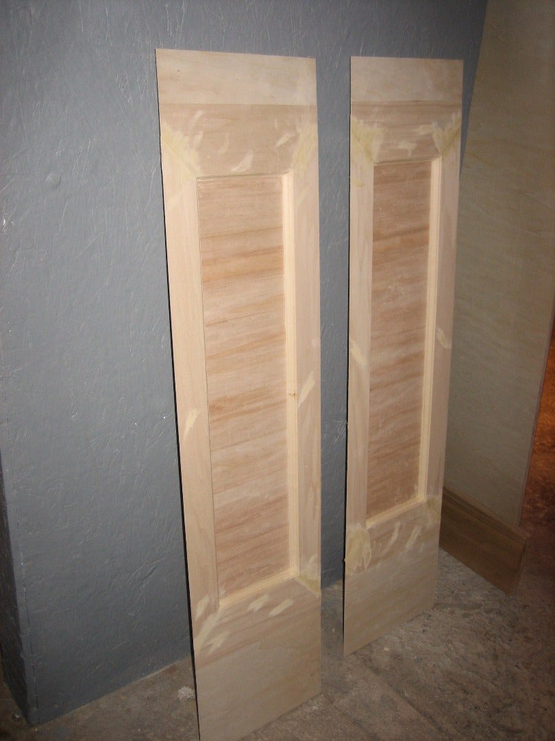

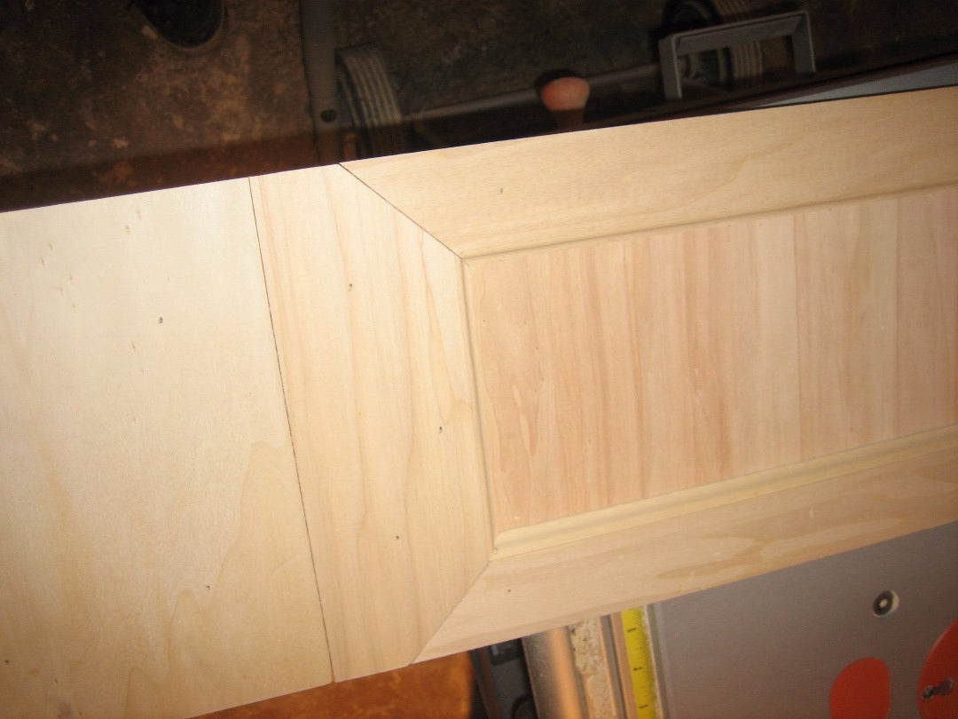

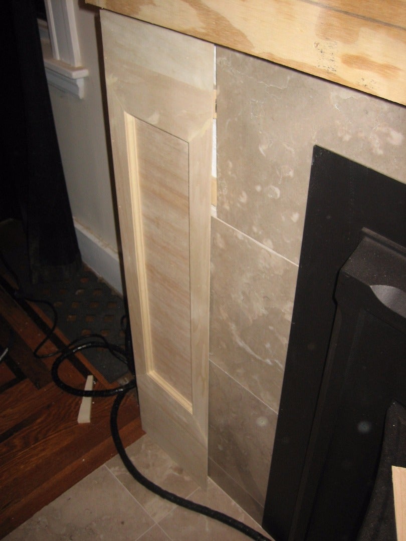

I started with a piece of 1/2" poplar plywood at this determined dimension. On top of this I basically built a picture frame with narrower strips of 1/2" plywood. The sides are 1 3/4" wide, while the top and bottom are 5" wide. Within this frame, I installed some store bought molding. This molding covers the raw edge of the plywood, as well as creates the transition to the bottom panel. What I'm left with is the look of a raised panel. The remaining area at the top and bottom were filled in with 1/2" plywood. The seam doesn't matter as that will be covered by molding in an upcoming step. A 45 degree angle was cut on each long side of the panels and then all nail holes and any gaps were addressed with wood filler.

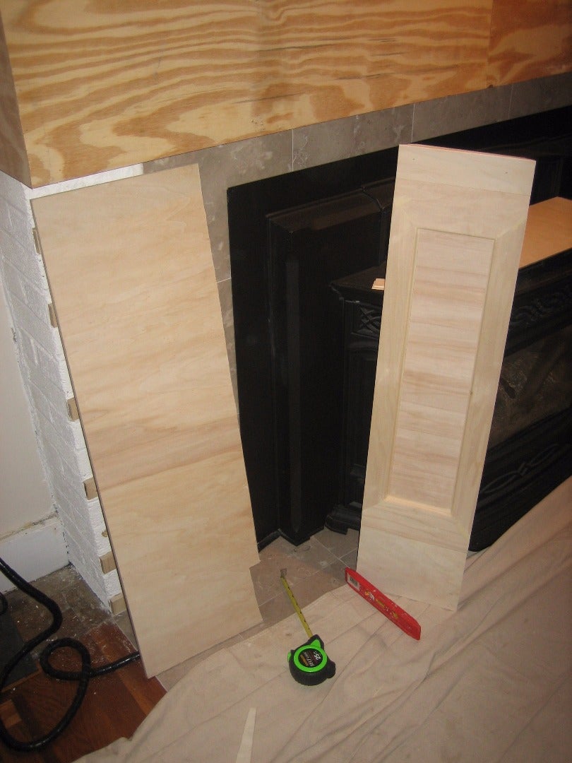

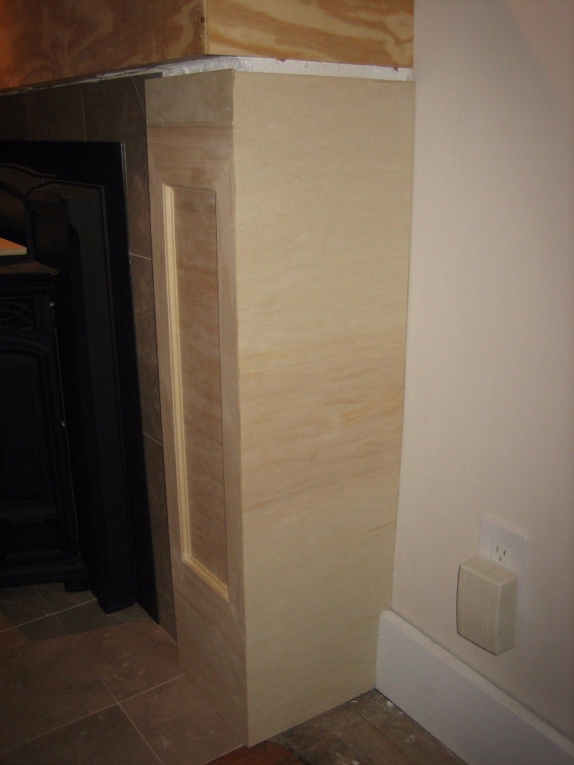

The external side panels presented their own challenge. The back edge had to be scribed to the contours of the wall and baseboard using a compass or what some call dividers. A jigsaw is used to make the cut and any finessing is done by sanding. The front edge gets a 45 degree cut to mate with the front panel ... I snuck up on this cut until the side panel was at the proper width to meet the front panel at 90 degrees. I took several tries, but that's better than cutting it too short.
The front panels were glued and brad nailed to some furring strips, which were attached to the brick using construction adhesive. The side panels were attached using construction adhesive on the bricks, as well as wood glue on the edge miter with a few brad nails.

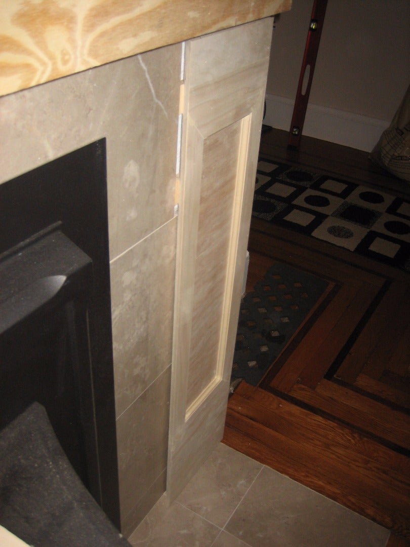

Lastly was the internal side panel. The front edge gets a 45 degree cut to mate with the front panel. The back edge is left straight as it sits flush against the marble surround ... again I just snuck up on that cut until I had the proper fit.

The front panel was cut to size, which in my case was - and includes the 1/2" overhang on each side. In this case, the 45 degree edges were cut using a speed square and circular saw since I had no safe way to do it using the table saw. This panel was secured to the "subheader" with glue and brad nails.

Step 6: Trim
Trim is the stage of the game where you get to conceal prior mistakes, which in my case was saving grace. Any gaps, seams, and plywood edges were about to be covered and forgotten.
The first offender was the exposed plywood edge from boxing in the bottom of the header. This was easily done with a half round molding. I used a miter saw and snuck up on my cuts to get a nice, tight fit ... wood glue and brads to attach.
For the top and bottoms of the columns, I used solid poplar ... 2" wide at the top and 5 1/2 wide at the bottom. I also used the miter saw and snuck up on my cuts to get the tightest fit I could. Next to the poplar boards, I installed a decorative molding to dress things up. Wood glue and brad nails to attach.

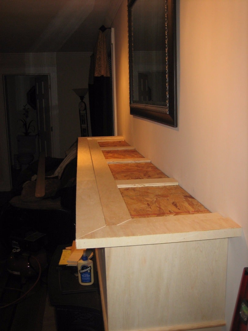

This over-complicated lamination cantilevers the header -" on all three sides and was secured to the top of the header with glue and brad nails. I ripped some 3-4" strips from the remaining plywood and used them to create some supports in the middle cavity ... basically dividing the space into quarters. This was enough to support the top later of plywood to ensure there was no sagging or flex.
The top layer was made by ripping the second sheet of plywood in half, cutting the three exposed edges at 45 degrees, laminating, and repeating the over-complicated triangle edge process. Final depth was cut on the table saw once the glue dried. It's scribed to the wall, but finished dimensions are roughly 85" x 16". As with everything else, this was attached with glue and brad nails.

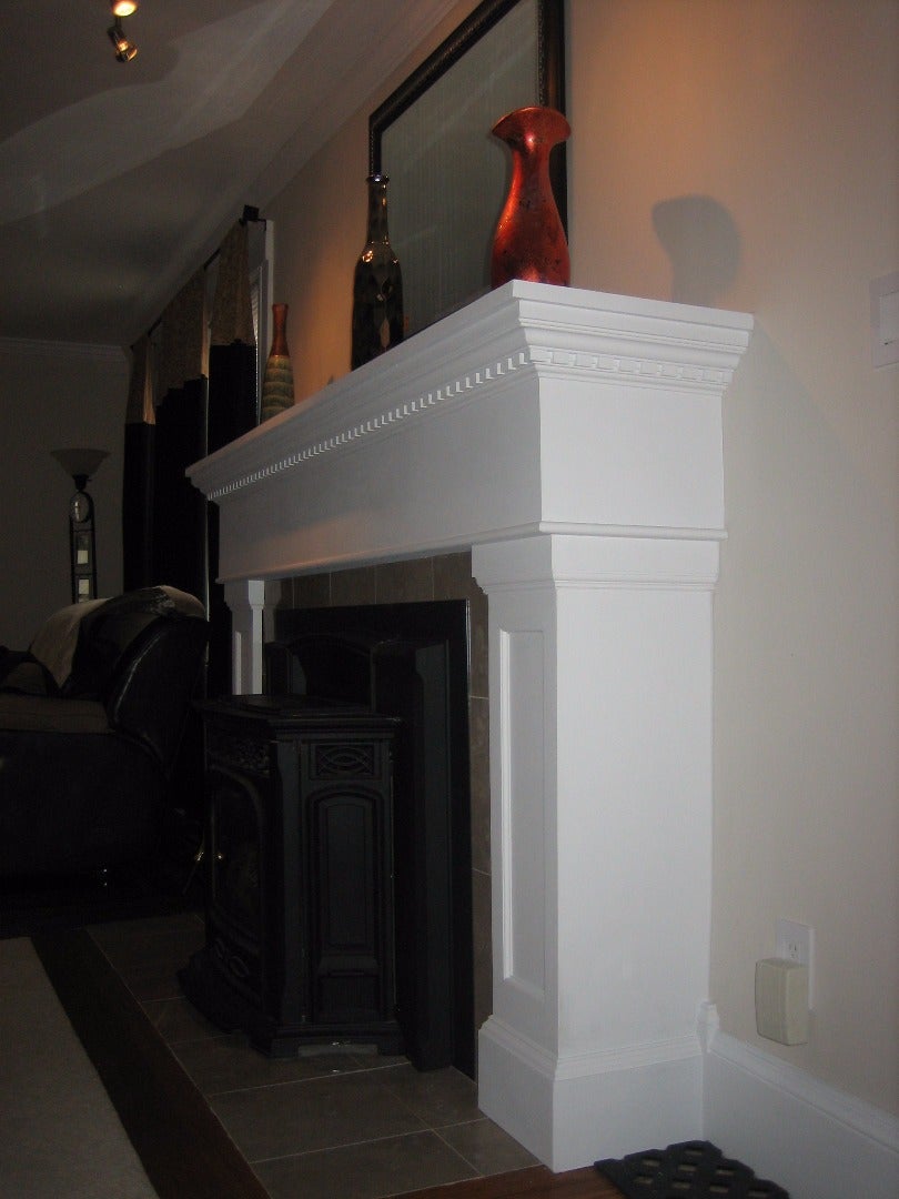

The one remaining detail was the dental crown molding. It took some time to layout because I wanted to size of the dental detail to be equal/symmetrical at each corner. With the help of a friend to hold the molding in place, I got the front section marked and attached.
For the sides, I first made my mitered cut at the edge of a dental detail. I would then cut the length a little long and sneak up on the cut until it fit between the miter and the wall. This took extra time, but I think the end result was worth the aggravation.

I went into this project knowing it would be painted ... that didn't make it any less painful though. I prefer not to paint wood and I don't really like painting in general. Fact of the matter is, the rest of the trim and doors in the house are painted ... that and I used paint grade plywood for the project.
That being said ... I hand sanded all surfaces ... except the dental crown ... I didn't have 27 years to do that. One coat of primer and two coats of paint with a light sanding in between each to smooth/flatten and little nubs.
I'm happy with the results. If I had to do it again ... having all the tools and experience I have now, I'd either edge band the mantel layers or just glue up a few poplar boards into a solid top.
