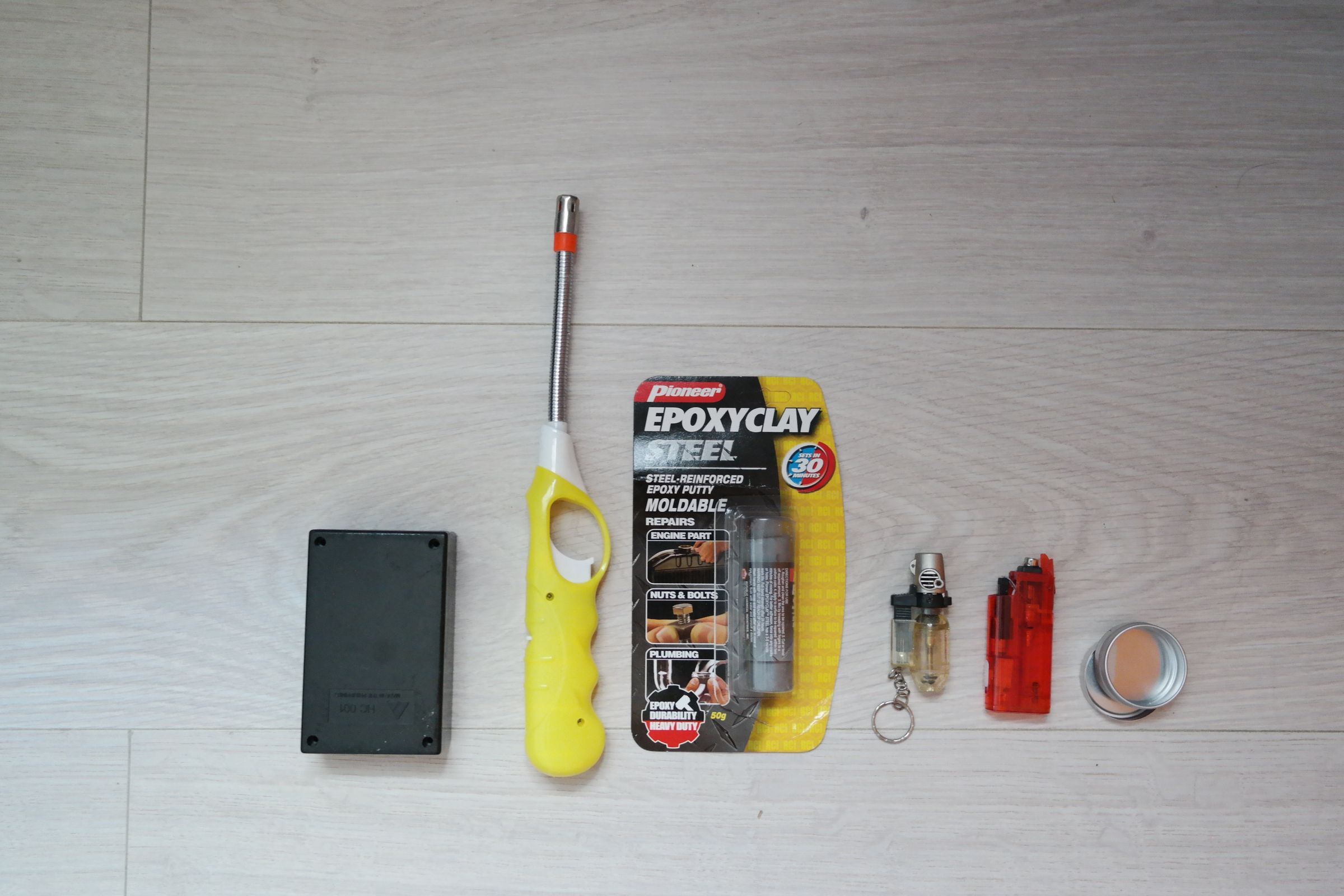

I was in a rush to bring this simple Instructable together so i gathered parts i could find around my room,
Materials:
- Generic project enclosure
- Fireplace lighter

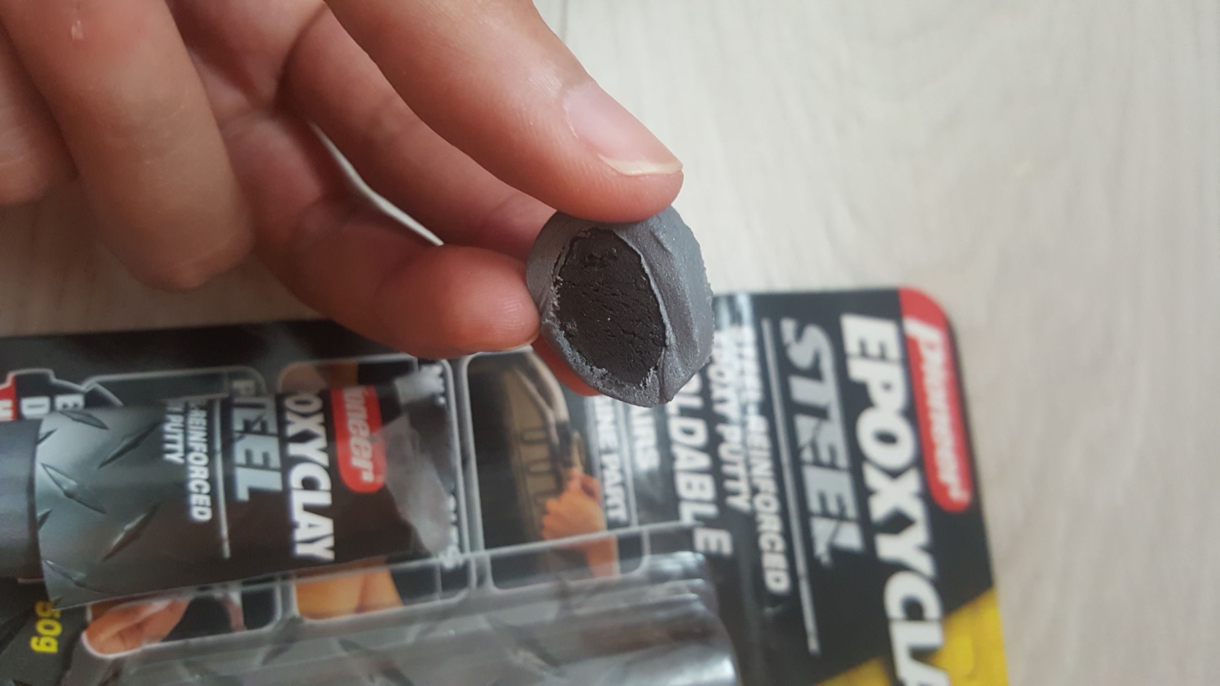

- Pioneer Moldable Steel Epoxy
- Torch Lighter
- Aluminum cream jar

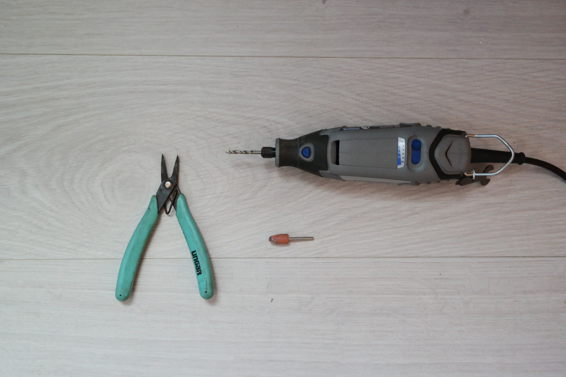

Tools i used:
- Pliers
- Dremel
- Drill bit
- Sanding bit

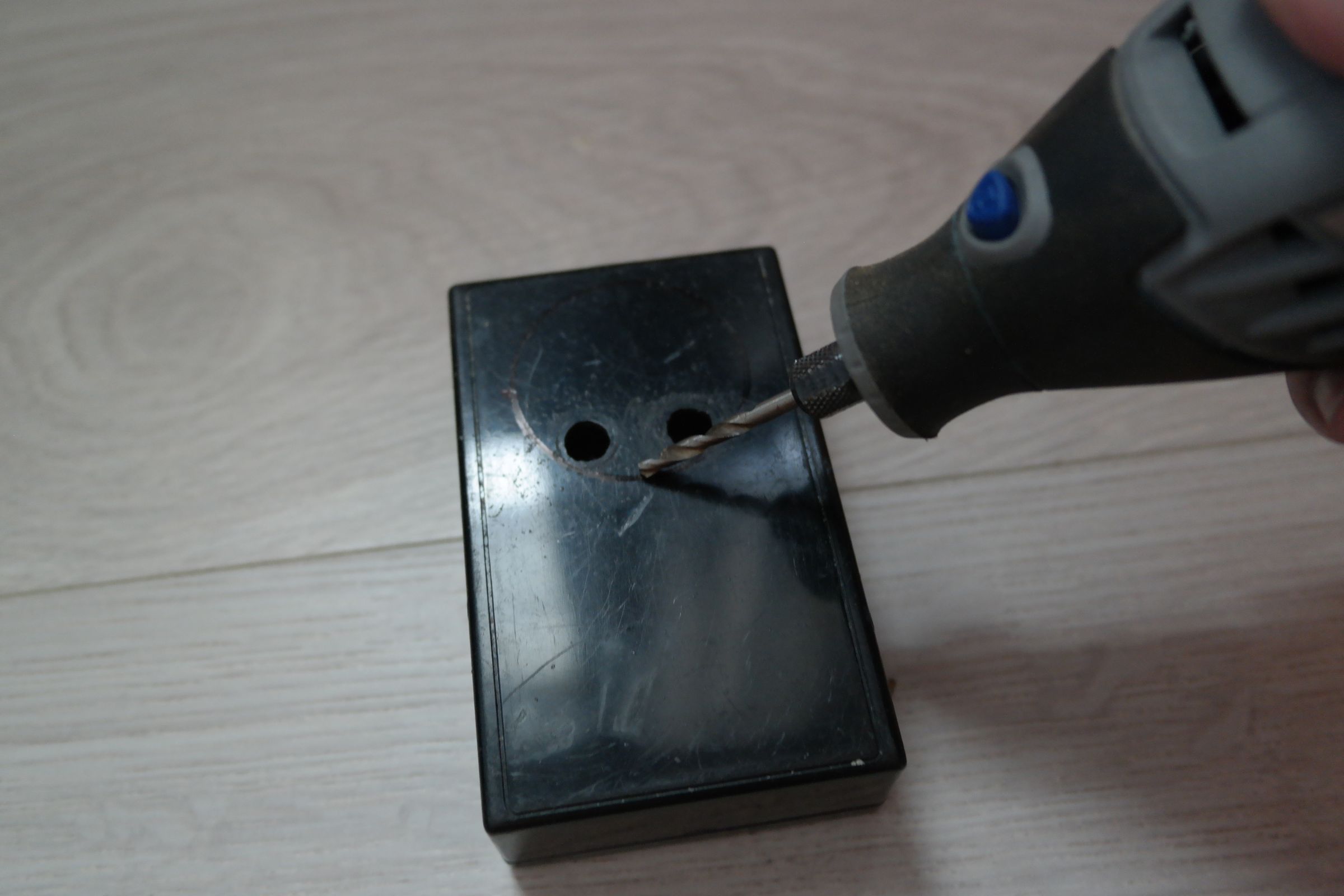

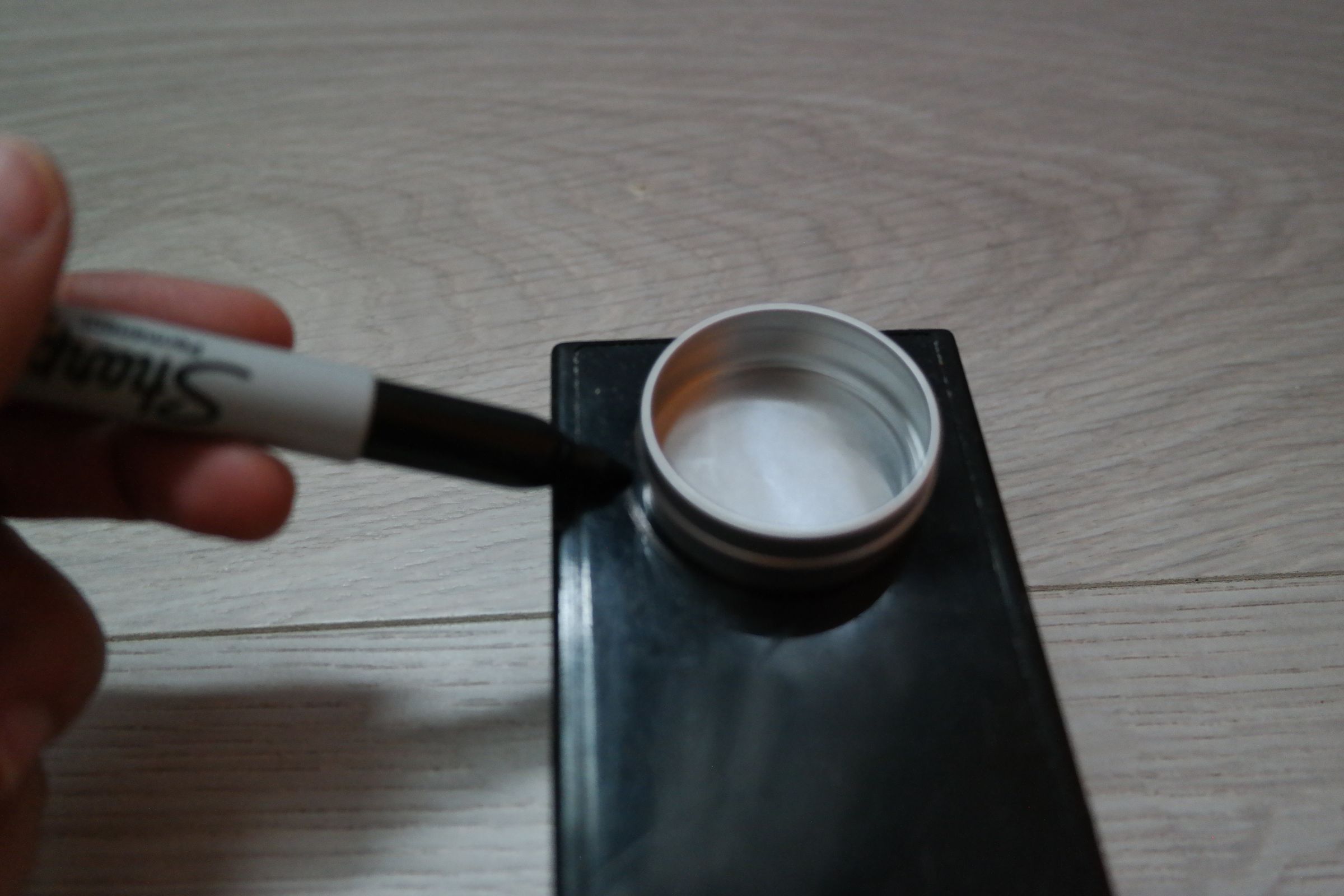

Lay down your Aluminum Cream jar on your project enclosure, We will be using this as the hot plate where the oil or butter is heated for your kernels to pop!

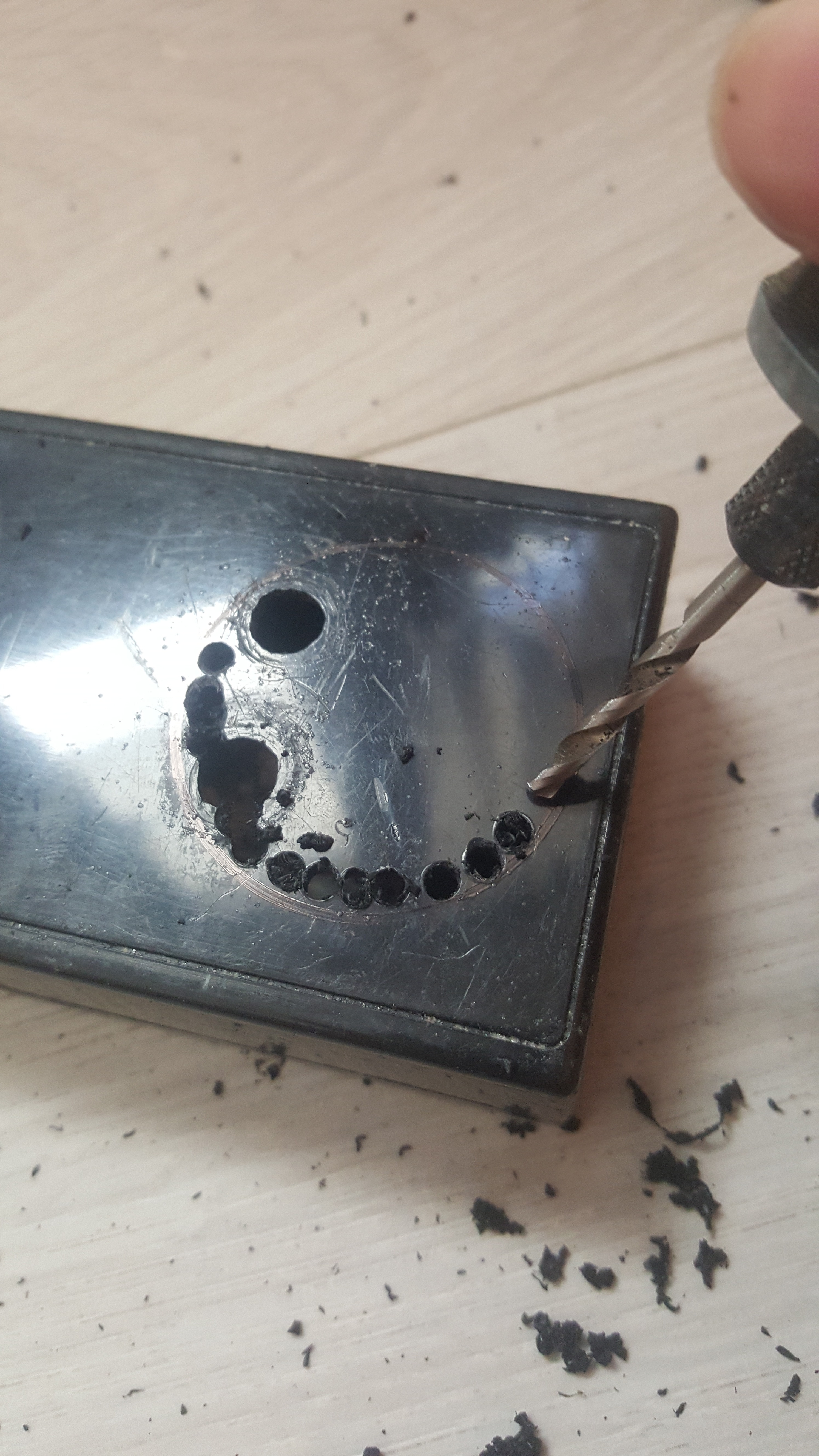

Grab a sharpie and use your jar as a stencil to plot the hole to be drilled for your Aluminum Cream jar, Now that you've got that covered, proceed to drilling holes around that stencilled guide until you form holes around it all.
Now to switch Dremel tips,

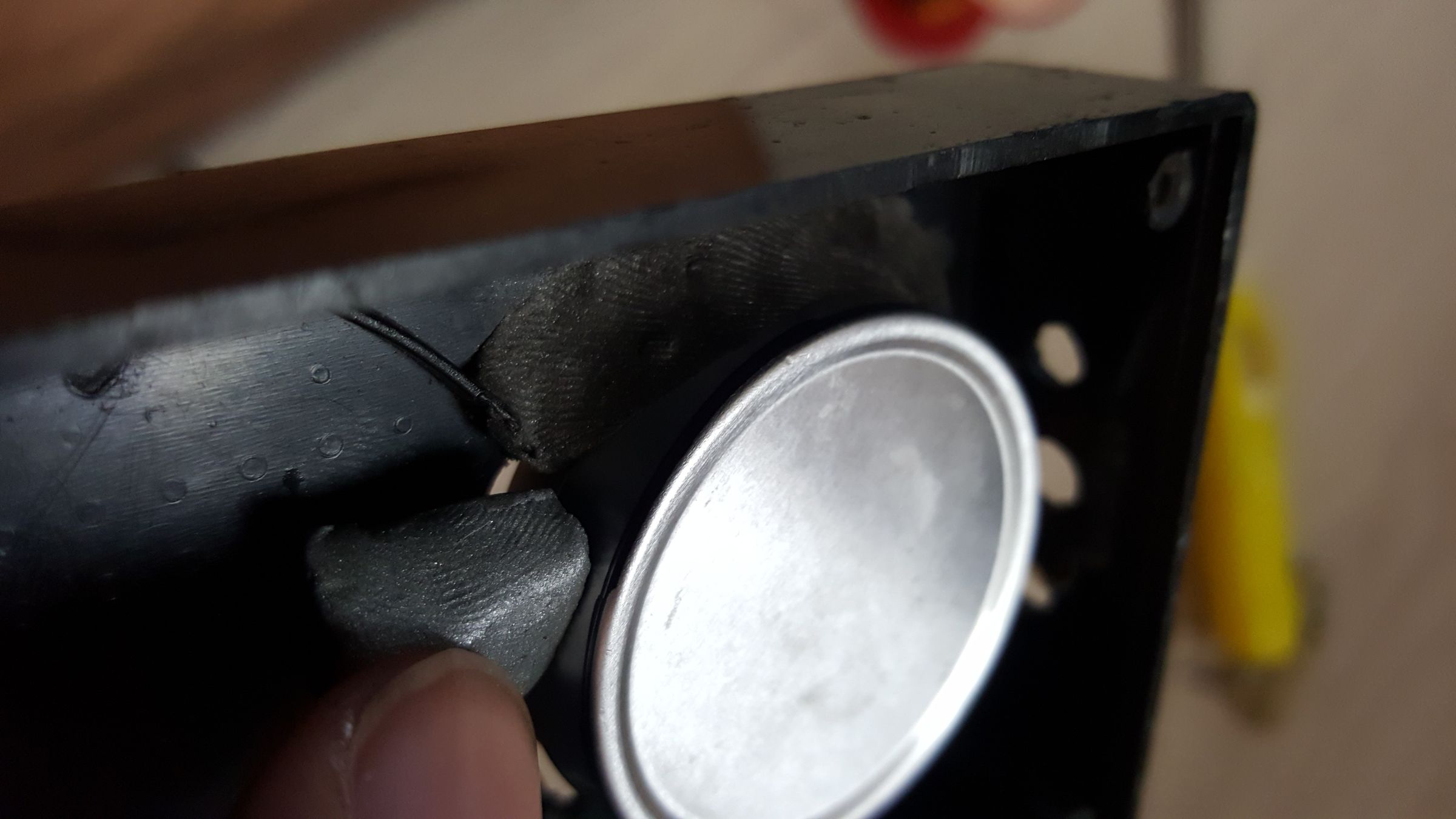

Take your sanding bit to finish off the burrs in the large hole you made, making sure your Aluminum cream jar fits in the hole. With that, take your Moldable steel epoxy and simply fix the aluminum cream jar in place!

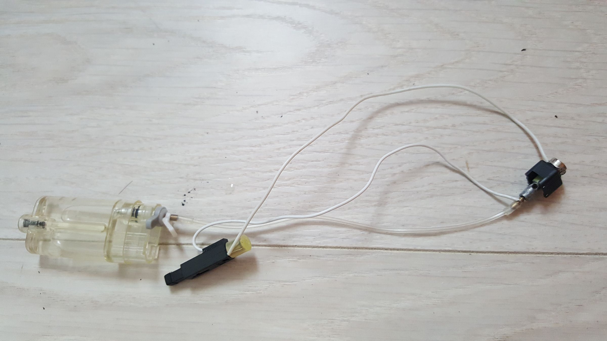

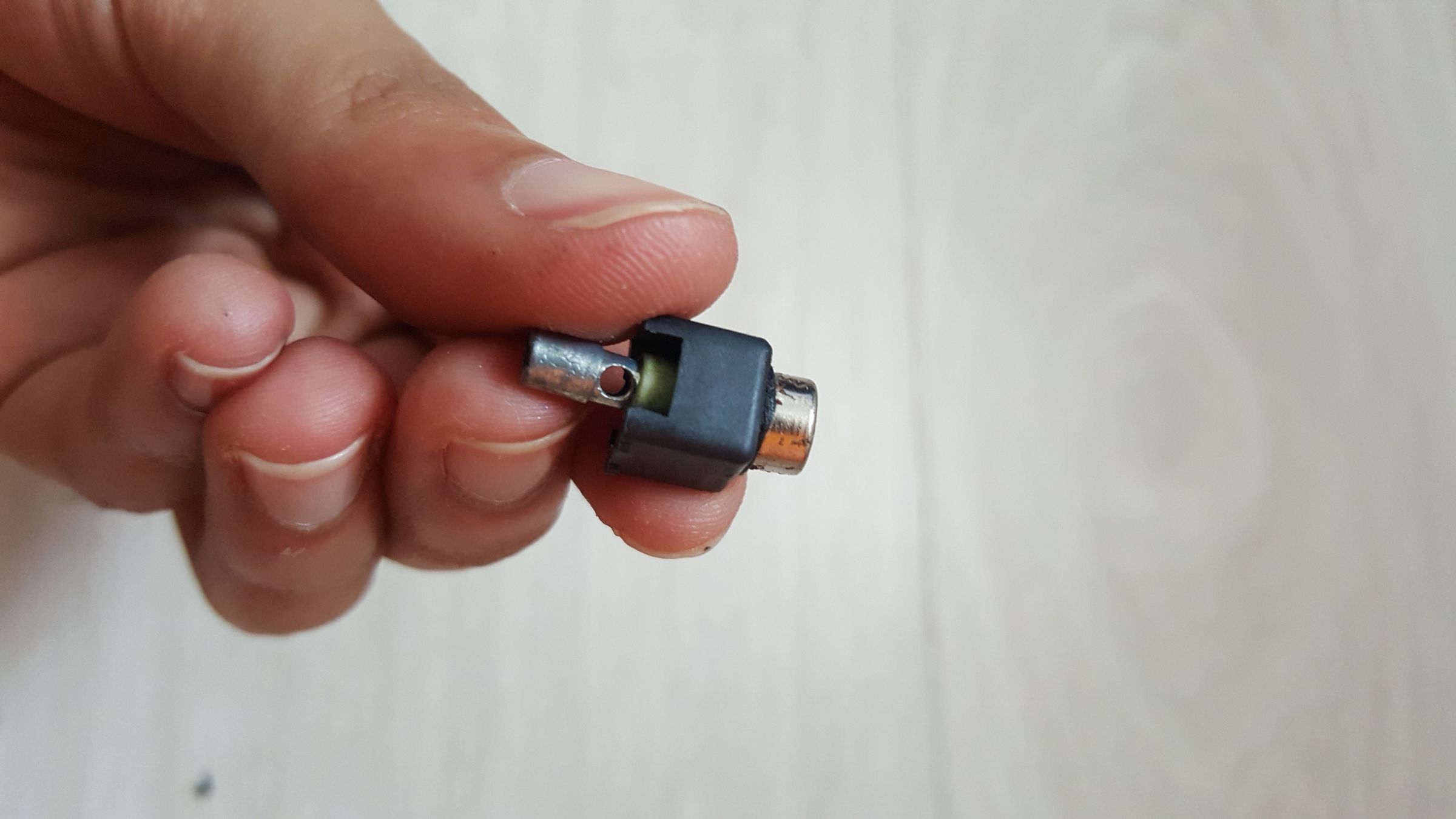

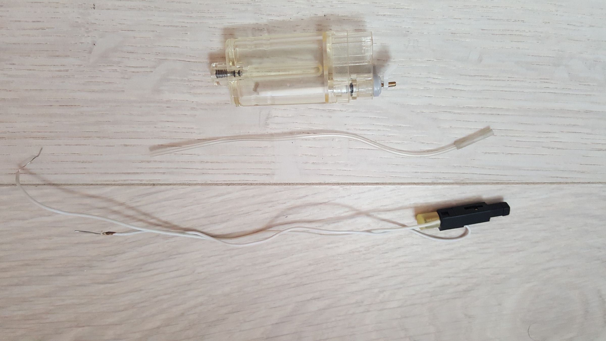

Take your Fireplace lighter and torch lighter apart, we will only need a handful of its parts!
- The fuel tank
- Igniter
- Hose
- Torch head
If you've browsed through my previous Instructables, you'll recognize I've used this heating system in a majority of my Instructables!

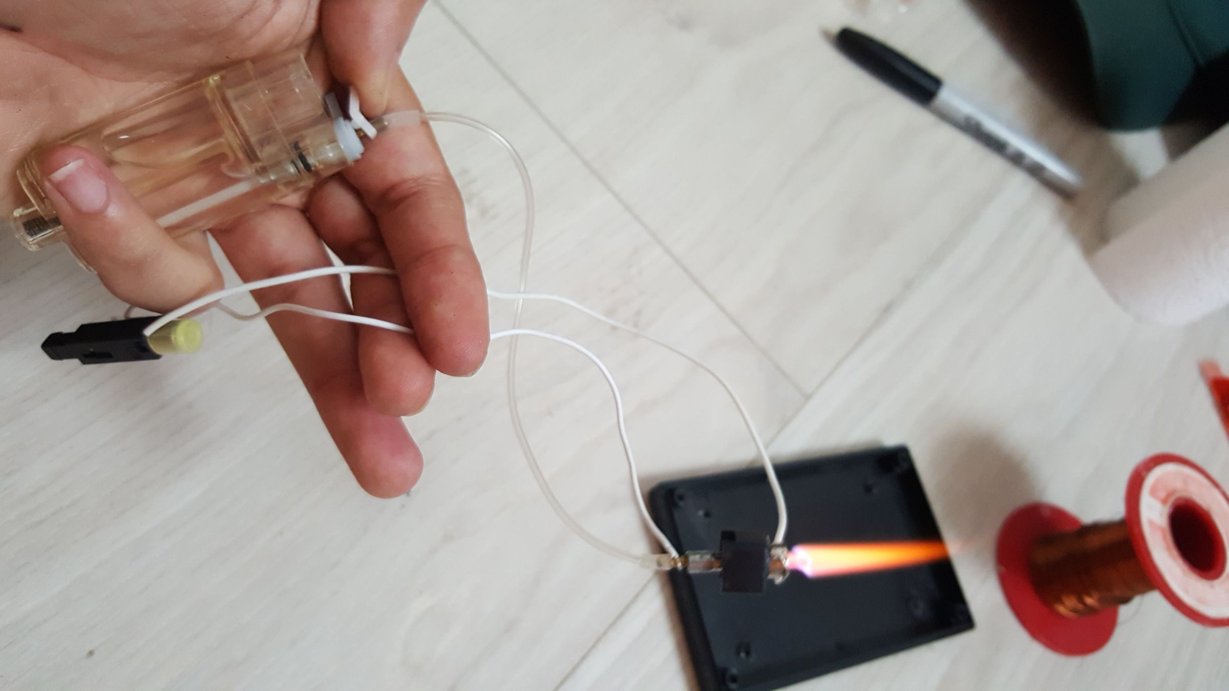

To Assemble the gas tank, connect the hose to it and the other end of the hose to the Torch head. Connect one side of the igniter to the bottom of the Torch head and the other end to the tip of the torch head,
Note: you'll see a spark in the torch head if you got this step simple step right.
You'll have a clearer idea of how to do this by taking a peek at the photo above!
To test if your torch works, press down the gas tank valve and ignite it, you'll see your torch fire up!
Note: The color is orange because of a calcium chloride coated tip if im not mistaken.

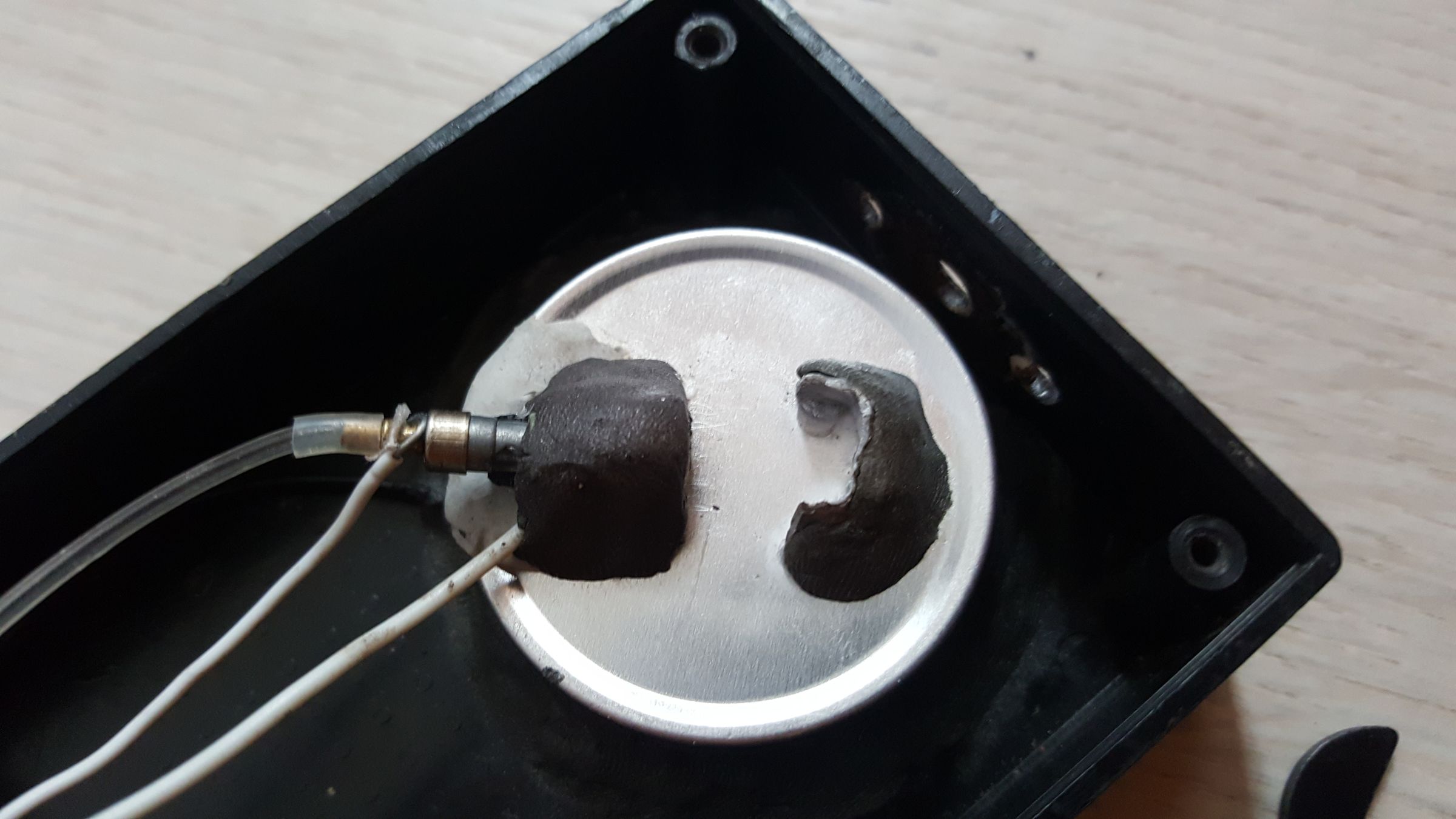

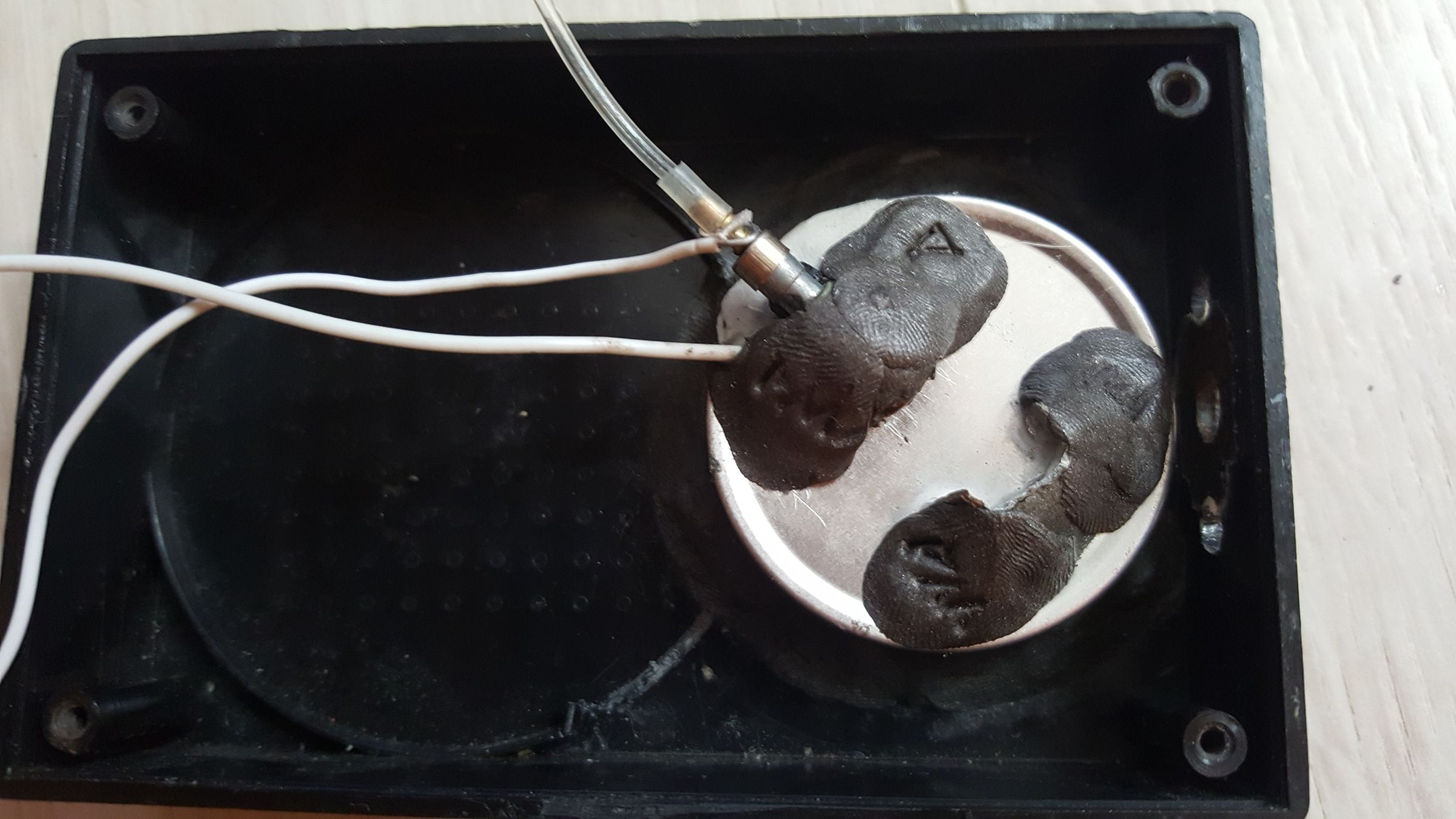

Part 2, Adding the heat concentrator:
It isn't as hard as it sounds, the role of this part is to simply focus the majority of the torch's heat to the center of the hot plate.
Cut off a piece of metal from the cover of the aluminum cream jar and bend it slightly like a "U" shape. Place this near the edge of the bottom of the cream jar and fix it in place with a piece of moldable steel epoxy!
Part 3, Fixing the torch in place:
We're halfway through making some popcorn!
Place some moldable steel epoxy to the bottom of the cream jar, form it at an angle and then place your torch head assembly on that angle you just formed, make sure it faces the heat concentrator and the center of the hot plate. Plop a generous amount of moldable steel epoxy above the torch assembly and the heat concentrator.

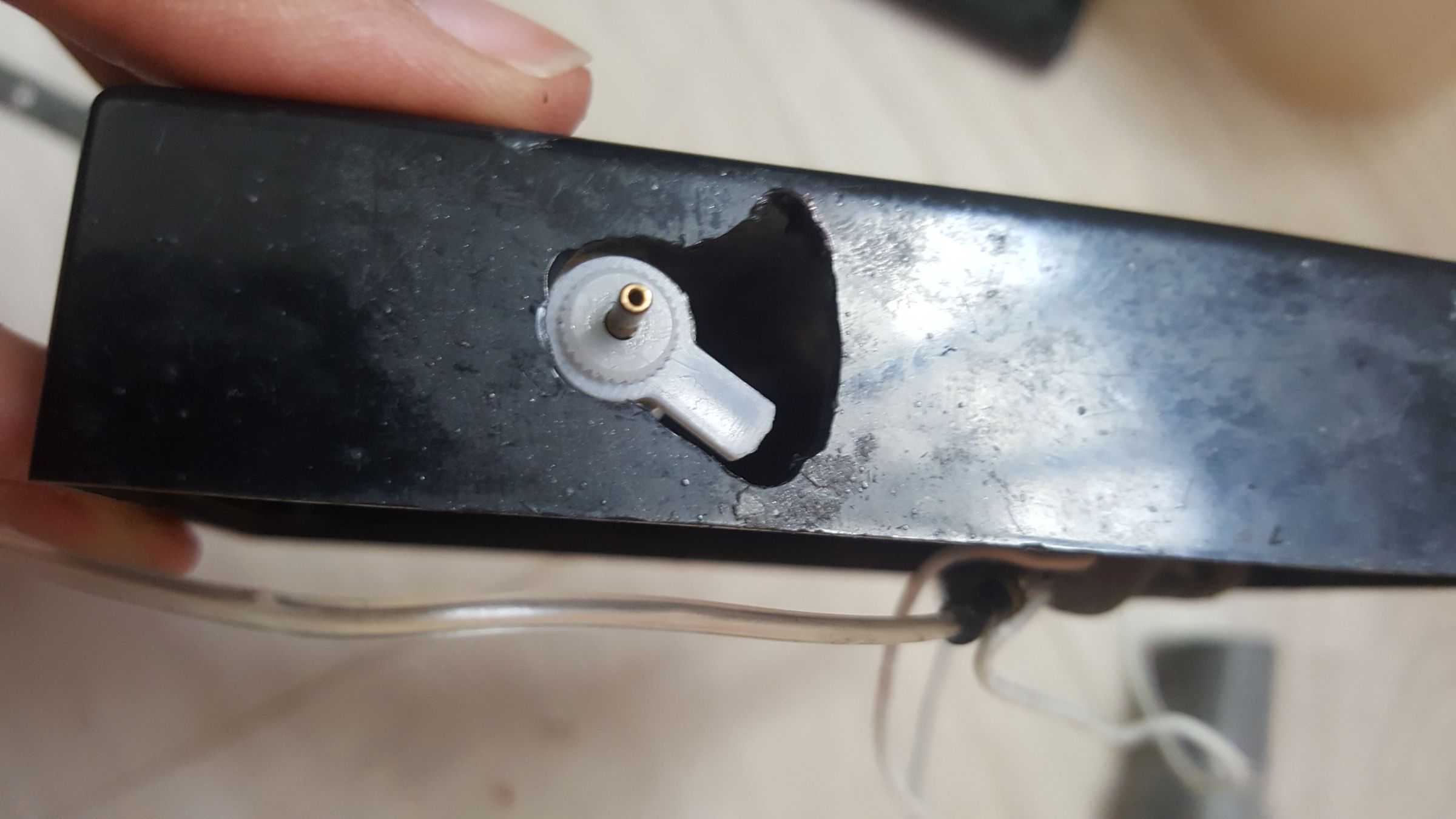

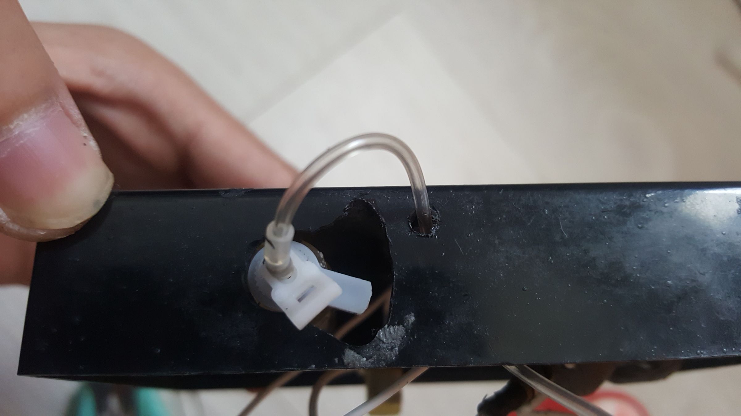

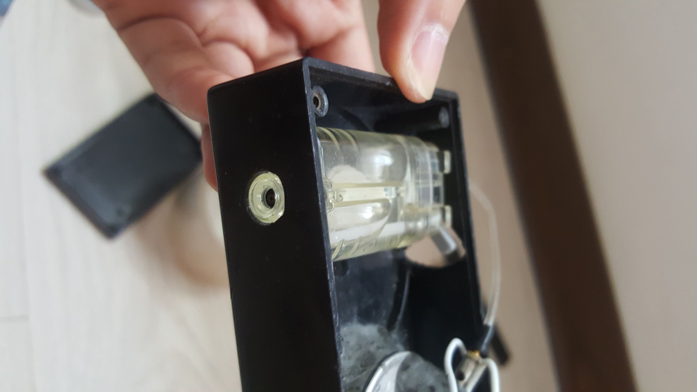

Step 1: Marking the fuel refill valve and the fuel adjuster holes and drilling
This step is quite simple actually, plot holes where the refill valve and fuel adjuster will be fixed in.
Here's a useful tip: Place the fuel tank over the spot you would like to place it in and use the valves as a guide of where you should mark it! (Apologies for the inverted image, the uploader seems to be having issues)
Once you got that covered, proceed to drilling out the marked spots and try to fit your tank on the holes you've just made! Fix it in place with some super glue.

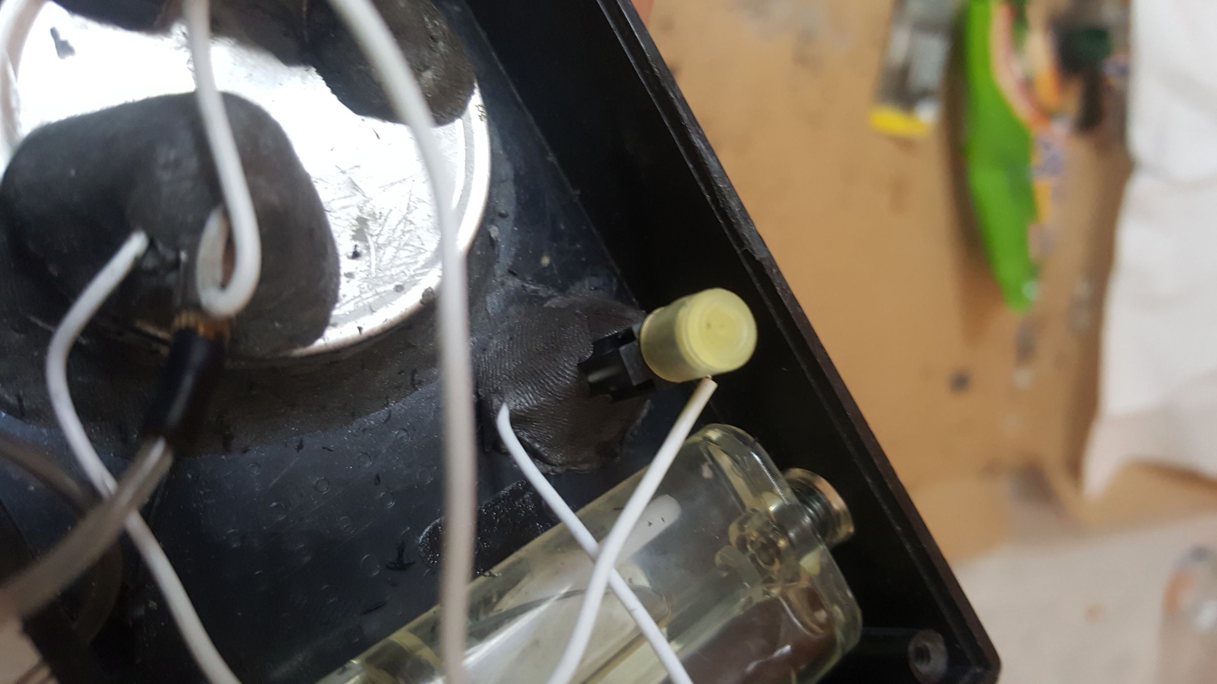

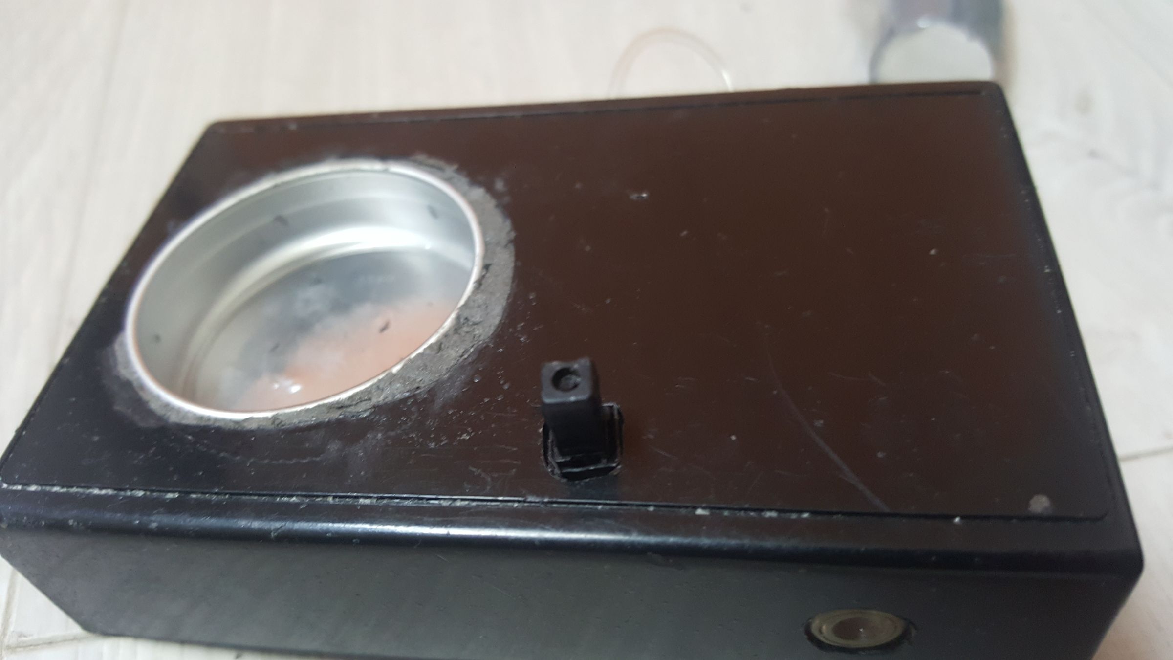

Step 2: Fixing the ignition in place:

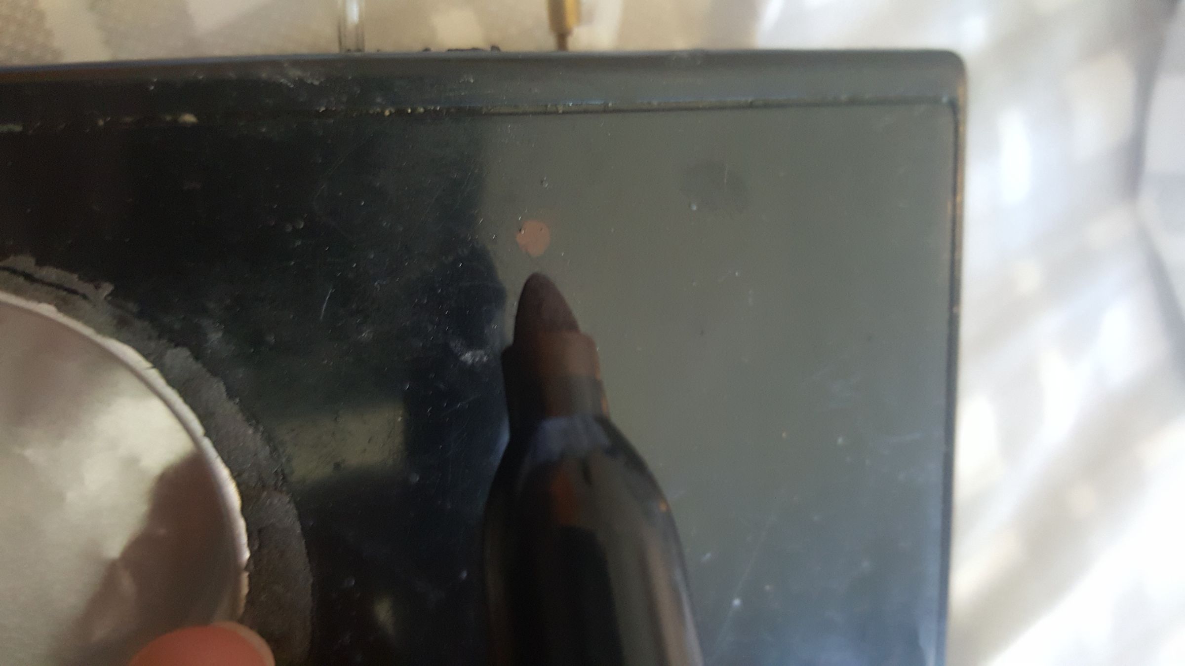

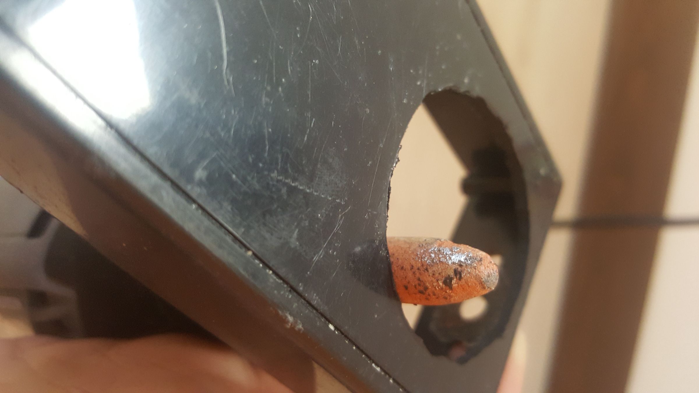

This is the final and simplest part of this step. Mark and drill a hole where you would like to place your igniter.
Once that's covered, place a generous amount of moldable steel epoxy around the igniter to fix it in place!
Here's how the igniter should look like above the box:

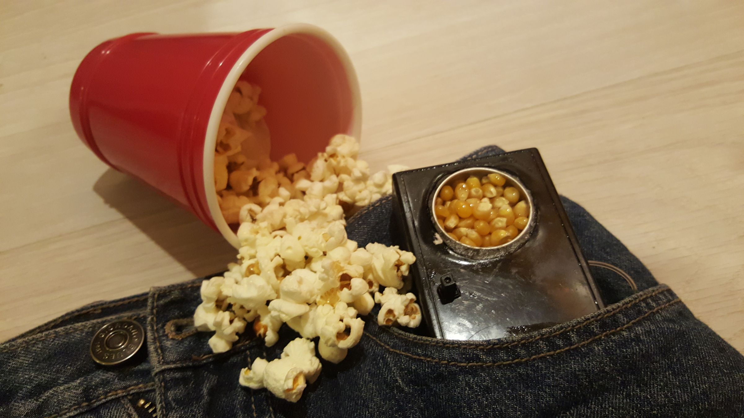

And you're done! "Go forth and make popcorn wherever you can think about making popcorn" -Pocholo Manalac
