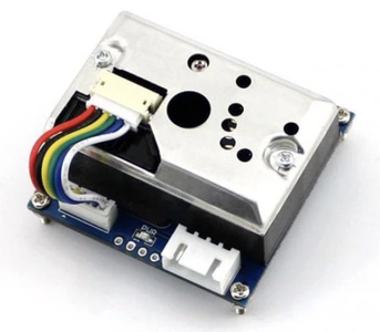

  1. Dust Sensor (Waveshare)

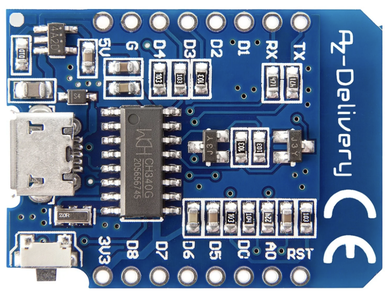

  2. 2x D1 minis

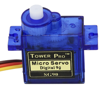

  3. MicroServo 9g (SG90)

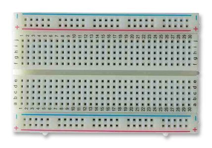

  5. 2x breadboards

  4. Code that sets up the dust sensor
  5. Code that reads the dust sensor and calculates its concentration

When it comes to the circuit, there are a few things to consider. Firstly, ensure the D1 mini is connected to a power supply via a micro USB-C cable. From this, you want to connect the 5V and ground points to the + positive and - negative rails on the breadboard. For wiring up the dust sensor, connect the VCC point to the + positive rail and the GND point to the - negative rail of the breadboard. Make sure to connect the AOUT point to the A0 point of the D1 mini, and if you want to include the sensor's built-in LED, connect the ILED point to the D0 point.

For the circuit, there are some points to consider. Again, the D1 mini has to be connected to a power supply via a USB to micro USB-C cable. The servo motor has three wires: the red wire goes to the 5V supply, the brown wire goes to the GND, and the yellow wire connects to the D4 pin.

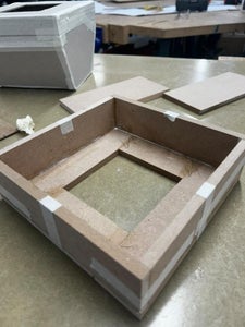

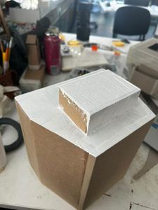

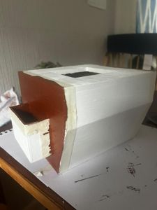

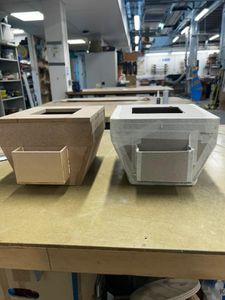

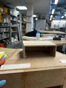

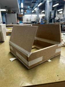

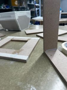

For the wooden pot, the shapes were cut from MDF to the preferred dimensions, as shown. They were then glued together to create the shape. A few layers of white paint were applied to the box. Afterwards, several layers of brown paint were added to give it the appearance of a pot. A final layer of blue/green paint was applied to the top edges of the pot.
