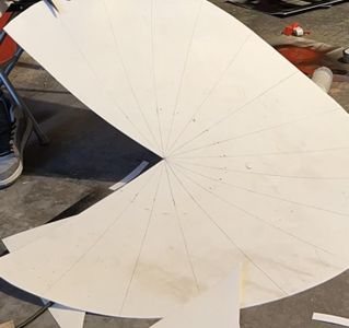

Step 3: Adding the Color Panels to Outside of Wheel
  1. You will need to get one of the 4X8 plastic wall panels and cut it in half to where you now have 2 squares that are 4ft X4ft squares. (It is important to note that one side of the panel is for glue to be on later and the other side is where you will make markings with a pencil in the steps to come. Please look at the picture above with the orange circle with the tag on it noting the side for glue.)
  2. Once you have two equal squares it is now time to find the middle point on each square. Ideally, it should be 2ft to the center from the sides and 2ft to the center from the top or bottom and where the two meet is your center point. It would be a good idea to measure your squares length and width to ensure that they are exactly 4ft X 4ft. Because my circles were 46.5 inches or 3.875ft in diameter, I wanted to make sure the radius (half the diameter) for the panels were at least 23.25.
  3. After find the middle of the squares then it is time to attach a nail to the center point that was just found and attach a string that stretches to a length of whatever your wood circle's radius is. In the case of the circles above the radius is 23.25. With the string tied to a pencil on the other end, you will draw a circle around the plastic wall panel. Now you should have a full circle measuring the same diameter as your wood circle.
  4. The next thing to do is cut out the circle with the large shears. The shears as mentioned in the tools are strong enough to cut the thick plastic panels.
  5. After the circles have been cut then you will take a 2X4 that's at least the full length of your plastic wall panel circle and using the hole the nail was once in at the center of the circle, line up the edge of the 2X4 at that center point and draw a line right down the center of the circle. So you should have two equal halves of the circle at this point.
  6. Using the angle finder you will place the angle find on the center line you have just drawn down the center of the circle. The angle finder's 0 degrees should be on this line and at every 9 degrees using the numbers at the top of the angle finder you will put a mark indicating where you will draw your line. Notice in the picture with the yellow angle finder that there is a red arrow on the edge of the angle finder, as this is not where you want to line up the angle finder to the line draw down the center of the circle. It should be lined up with where the 0 degree is (slightly above the edge where the green arrow points). If not properly lined up it will throw off the angles of each panel. The green circled numbers in the picture are the ones that you will use to go around and mark every 9 degrees all the way to 180 degrees. That will take care half of the circle and after that you will basically flip the angle finder upside down and do the exact same thing on the other half of the circle.
  7. After the angles are marked you will use the edge of the 2X4 used earlier to draw the lines from the center mark of the circle to the outer end of the circle. With a total of 9 degrees each there should be a total of 20 different panels at the end. 10 for each half of the circle.
  8. Repeat the same steps for the other 4ft X 4ft half of the square plastic panel so that you will have a total of 20 for one wood circle and 20 for the other wood circle.
  9. You can now cut out each panel using the shears. (It is critical to keep the panels next to each as pictured in the above photo with the purple oval other as they are cut out to ensure when adhered to the wood circles they fit together perfectly.) There is a picture above of what the full circle looks like with the lines drawn on them and them being cut out.
  10. After each of them are cut out it is time to spray paint. (Keep in mind that You will need to use a respirator mask in a well ventilated area for this) (Keep in mind also to spray paint the side that is not used for the adhesive later as mentioned earlier) You will need the Spring Green Rustoleum spray paint, the Metallic Champagne Bronze Rustoleum spray paint. If you decided to use a white spray paint for the white panels it is up to you. It is optional and not a necessity. You can start with any one of the panels you would like and work your way around painting each of them the colors pictured above. I worked my way around painting them while they were still on the ground as in the picture above with the 2 green and 2 white panels. It is important to keep up with which panels are next to each other as you paint. At the end you should have a total of 2 Spring Green panels 10 white panels and 8 Metallic Champagne Bronze panels for each side of the wood circles as seen in the picture with the baby blue squares.
