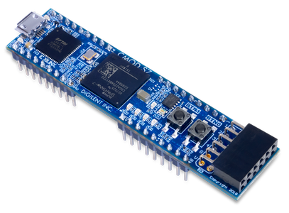

Given that this was a project for the university almost all the components that are used were provided from the university (Except for the PCB itself).
Two of the most important components in this device were already in the university, and we used what's available. Those were the FPGA and the DAC. Provided in the university there was a couple of the CMOD S7 from Digilent and
It featured:
  • 32 FPGA digital GPIO pins
  • 2 Internal analog input (Analog to digital converters- XADC)
  • An external power input rail
  • 4 LED's, RGB LED, 2 Buttons all on board
  • Small factory size
  • USB-UART built in with a micro USB onboard
  • 12 MHz onboard RC Clock
    Perfect!

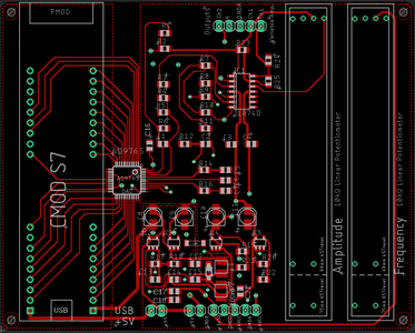

Step 6: PCB Laout
Trying to visualize the PCB layout I drew a quick sketch using LibraOffice, and it included all the sections of the PCB.
The PCB is a mixed signal one. Meaning that it has an analog section and a digital one. This left side of the PCB is the digital part where half of the DAC Input pins, FPGA and PSU- Digital/Input are. The Right side is the analog one, where the Potentiometers, Amplification, Output, and PSU- Digital parts are.
I needed 4 screws on the corners to be able to attach it to a 3D printed case that ill design later for the purpose. The holes should fit M2 screws. The board size shouldn't exceed 100mm in width and 80mm in height (Eagle CAD software- Student Version limitation)
Now moving on to designing!

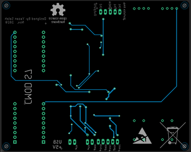

Step 9: PCB Board Design on EAGLE
Switching view on EAGLE from Schematic to BOARD you will find all the elements of your schematic in midair not connected and showing only airwires. Start by changing the board size to your requirements.
Go to -> Edit -> Design Rules and change those according to your manufacturer capabilities. Just like in step five.
Start laying out the components on the PCB similar to the layout in step four.
Connect all the traces, leaving enough space between them and make sure that no trace has a 90degree angle corner/bend it should be either round or larger than 100degrees! This will help the signal moving around the traces at high frequencies to reduce interferences/reflections inside the trace itself.
Once that Is done, and if the manufacturing process allows make a polygon of Digital/Analog ground areas and run ratsnest to connect the grounds to the pads.
Check, double check, triple check your PCB before sending it to the manufacturer!
Check the traces, number of pads/legs, layout, component size/packages, all of labeling and the traces are well-connected (Sometimes a trace can be very close to a pad or another trace and not be connected) use the ESC check tool to make sure that your schematic doesn't have problems and then check again with the DRC tool to make sure there is no airwires or mistakes in your board.
Once done, export it as a Gerber file by going to File -> Generate CAM data ->ok -> Save as ZIP file.

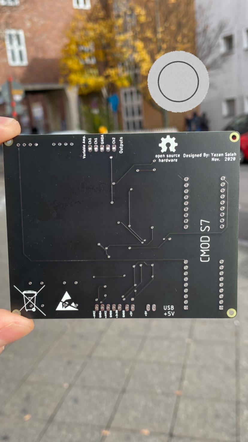

Step 11: Finish It Off!
Congrats! Your PCB is here!
Now all you have to do is have the components ready and get to soldering! Here is a good tutorial!
