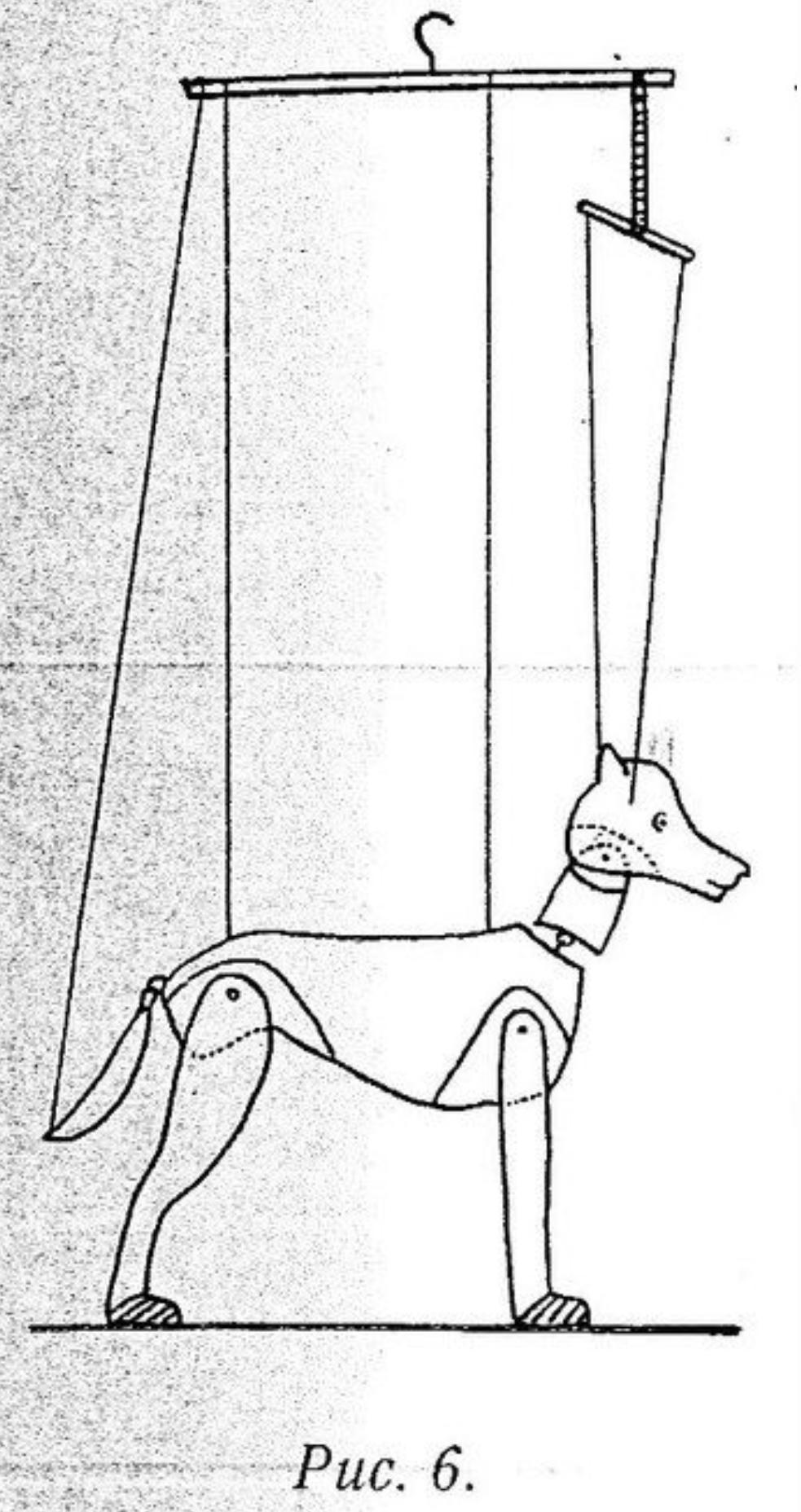

Step 2: Drawing Up a Plan
I drew the shape of the dog on paper, then traced it again so that I could cut out the bits even when they overlapped.

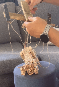

Step 8: Stringing It Up
This was where the project got interesting. Because lifting a foot up is different from a convincing leg movement. I tried a few methods before realising that the back foot didn't need to move. I actually preferred it in the same place whether the leg was up or down. So I glued that in place. I also realised that the length of the body ropes is the difference between feet always being up or never being up. There is a sweet spot in the middle where the legs move correctly.
I also noticed that the back legs would bend in odd directions if the ropes weren't properly in the right place, the legs had tipping points where if they bent too far, I would pull the ropes and the legs wanted to go in the other direction. So I used some staples and hooks to ensure that the ropes were always pulling from the right directions. This took a bit of experimenting to get right.
I also noticed that I got much better results when the strings to the back of the body were connected behind the legs on the controller. I also crossed the strings for the front legs, so that when I tip the controller from side to side, I get a front leg and the opposite back leg lifting up together like a walking motion.

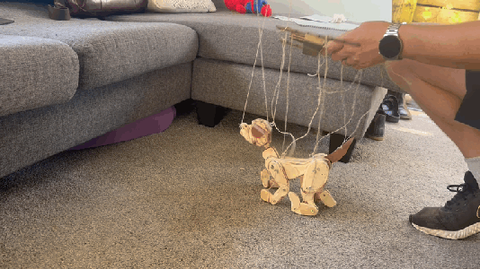

Step 9: Playing With Your Puppy
This is the fun part. It takes a bit of working out, but actually it's all far more intuitive than it seems like it would be.
