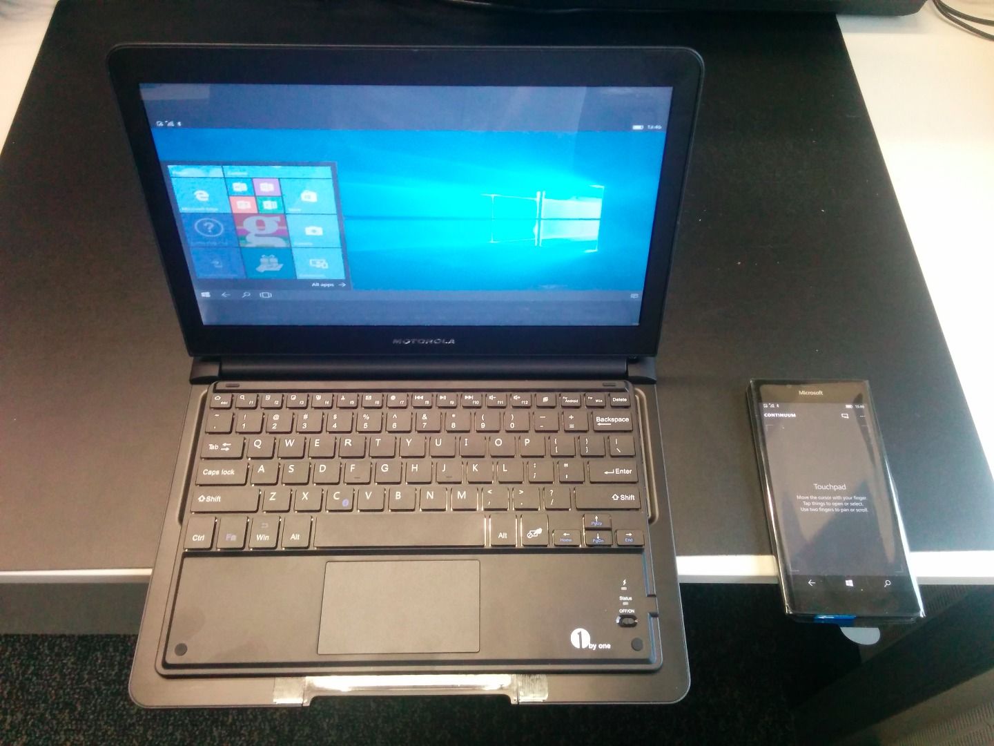

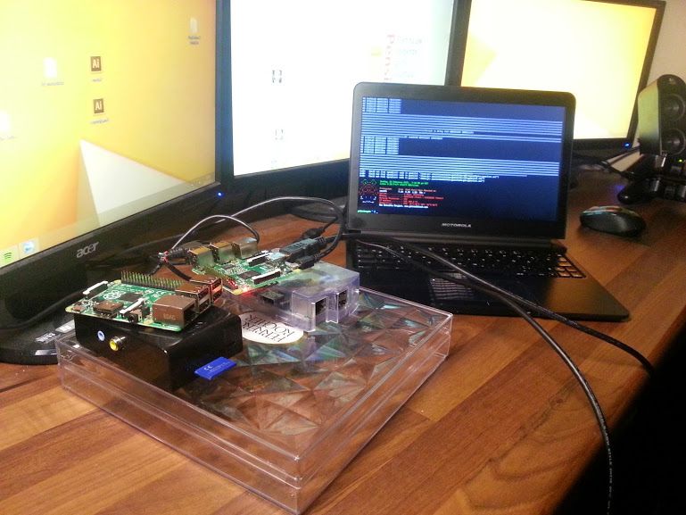

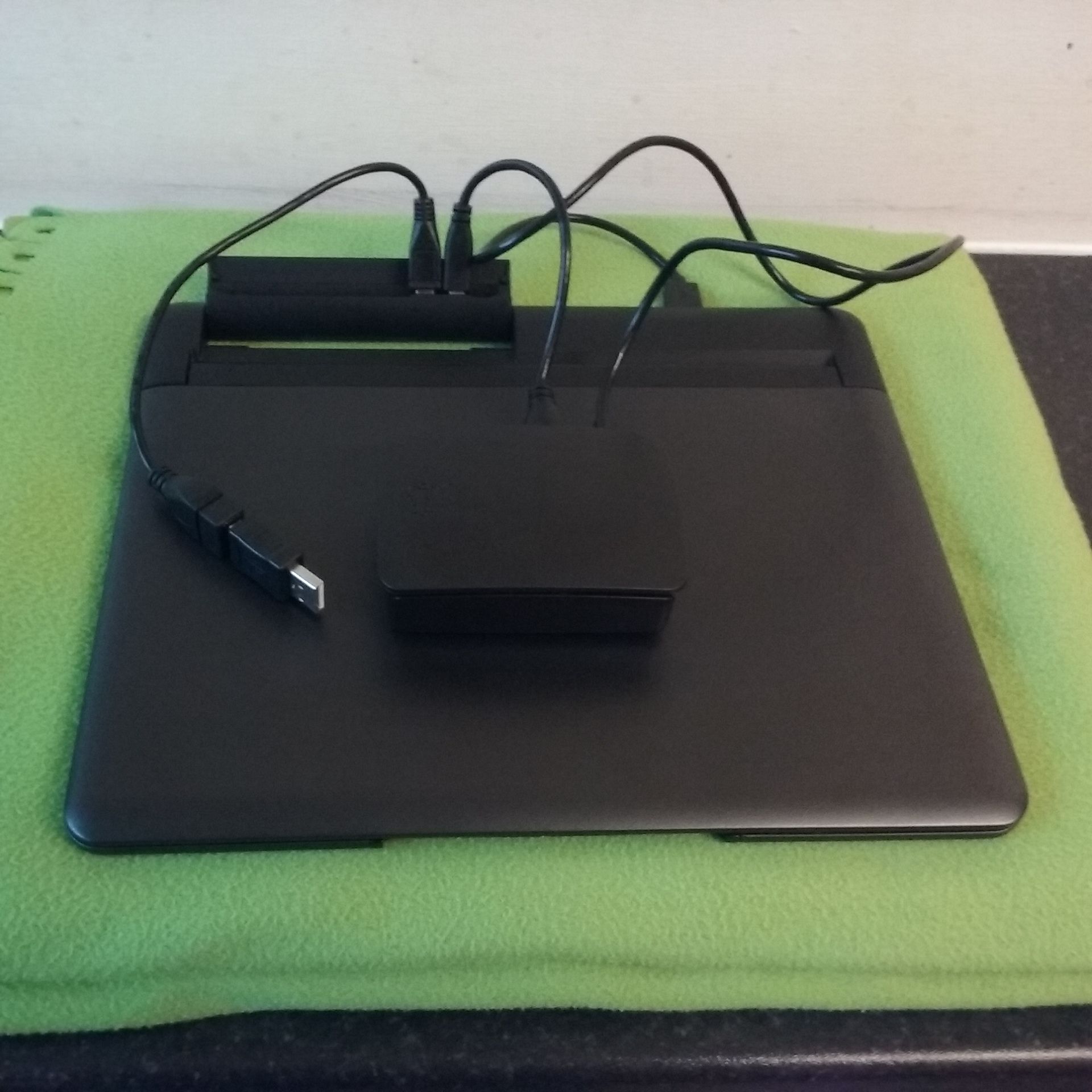

Step 2: Hooking Up
Open up the the narrow panel on the back of the lapdock and take a good
look at the two jacks protruding from it.
The micro-HDMI adapter (or the dongle, if you're using that instead) slips
over the end of the micro-HDMI jack on the lapdock. The micro-female end
of the USB cable slips over the end of the micro-USB jack on the lapdock.
Note that it may be necessary to shave a bit off the micro-female end
of the USB cable if it doesn't go down far enough over the male jack on
the lapdock (refer to pictures).
Now, we'll hook up to the Raspberry Pi.
The USB cable connects to one of the USB jacks on the Raspberry Pi.
Since the cable terminates in a female jack, we'll need either an A-male
to A-male USB adapter or an A-male to A-male USB cable. The A-male
end plugs into one of the Pi's full-size USB jacks.
Our HDMI cable has a micro-male plug on one end, and this goes into the
micro-female HDMI adapter on the lapdock. The full-size male end of the
cable plugs into the HDMI jack on the Raspberry Pi.

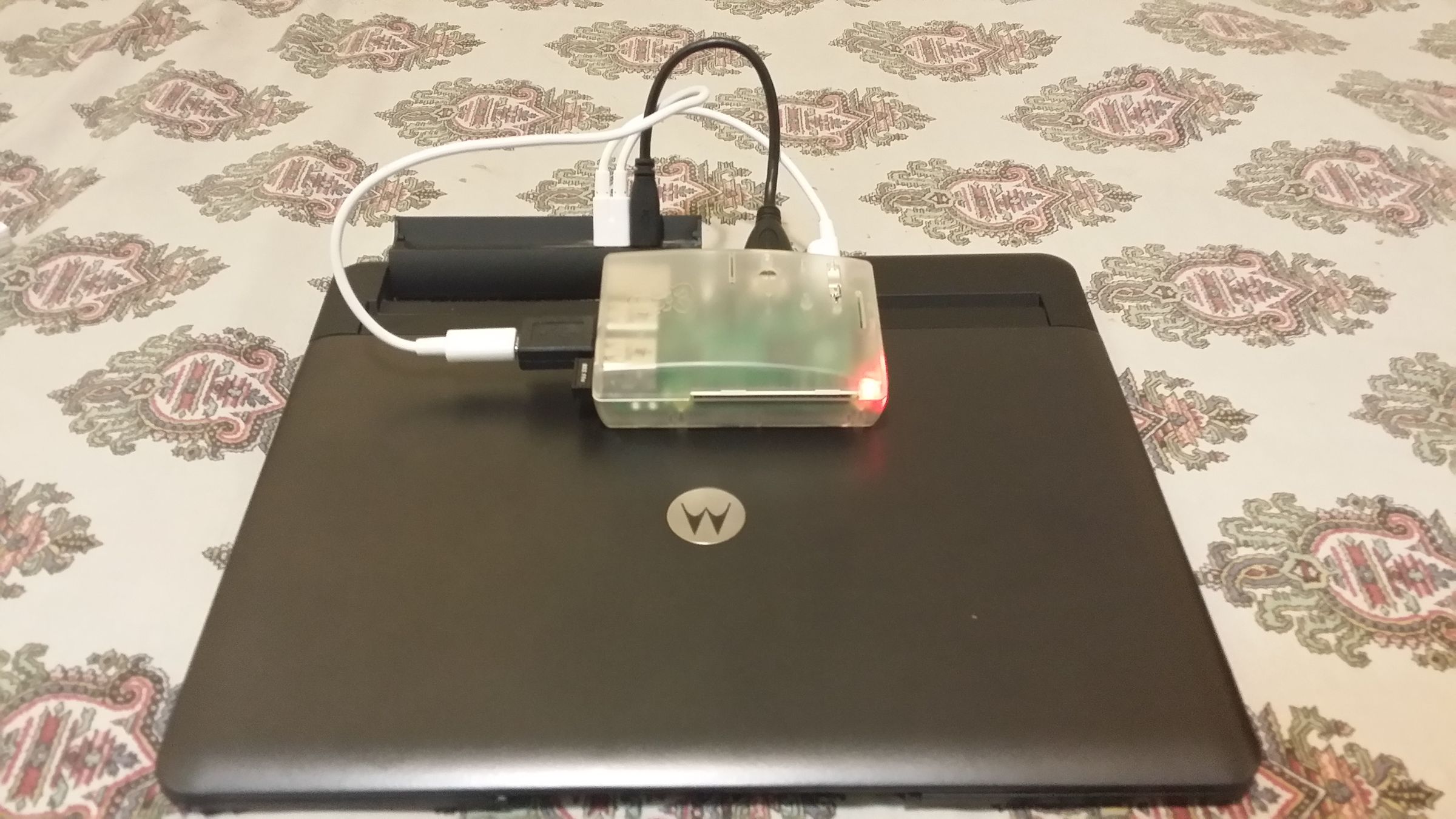

Step 3: An Alternative HDMI Adapter
Rather than a set of micro HDMI adapter cables, as shown in the previous step,
you can substitute a micro-female to male HDMI dongle. This has the advantage
of holding in place the Pi at the back of the lapdock.
You will need to whittle down the dongle on its side and back,
so it will fit all the way down onto the lapdock HDMI male plug,
and to allow room for the USB cable to fit alongside. See pics.
Caution: Take care when plugging or unplugging the dongle.
There's quite a bit of leverage there, and a wrong move could
conceivably break off the lapdock's micro-HDMI connector.
Update: Yet another alternative is the newly available HDMI micro-female-to-standard-male cable
(see last pic). These critters are rather pricey, about $7 each, including shipping.

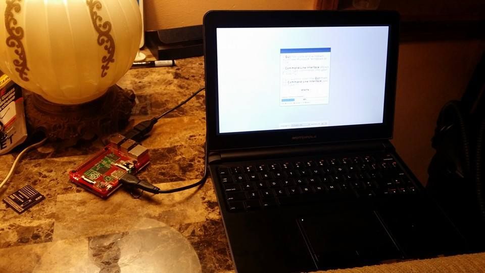

Step 5: Powering Up
Power up the lapdock by plugging in its supplied AC adapter. If the
battery has been charged, then this is optional.
Open the lid of the lapdock. The display will be dark, since there is
no signal coming in yet. Now, hook up the USB cable, with appropriate
adapter if necessary, as previously discussed. The Pi will not yet power
up from the lapdock because . . . the lapdock needs to sense a signal
source attached to its HDMI jack in order to supply power through its
USB bus
. So, we will at this point attach the micro-female-to-micro-female
HDMI adapter (with micro-male end of the HDMI cable inserted) to the
lapdock's micro-male HDMI jack. At this point, you may get a no-signal
message on the lapdock screen. Now . . .
Let's carefully plug the full-sized male end of the HDMI cable into the Pi's HDMI jack.
What's happening? The power and activity LEDs on the Pi board have lit up.
And, look! We're getting the bootup messages scrolling on the screen.
We're up and running.
Note that on your first boot you may have to type startx on the console
command line. After that, you'll be able to set an automatic boot
to X Windows.

I made a Windows 10 version of this. I call it the Litetop. The phone is the PC and broadcasts wirelessly to the Atrix.
You can see it working here: https://www.youtube.com/watch?v=A9-WbmDSlJo

Hey, I noticed your video shows that the mouse trackpad works. But what about keyboard? I am trying ensure that the micro usb at the back of the Lapdock was not required in anyway for Input.
And would it be mircast or widi you connected from your phone?
0
JackF48
JackF48
Reply 5 years ago
I think it was a bluetooth trackpad and keyboard to my phone. So I think the keys probably worked as well.
I plugged this in in the back:
http://www.amazon.co.uk/Microsoft-CG4-00003-Wireless-Display-Adapter/dp/B00J9C2JDG?ie=UTF8&redirect=true&ref_=pe_2105081_82693221_E_ReturnReceived_Asin_Title
I would imagine you could use any Miracast adapter but you'd need to check.
