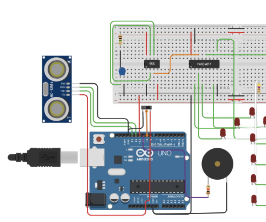

Step 2: LED Tracer Schematic and Creation
It's best to get the easier task out of the way right off the bat. With the schematic being provided above, the task at hand is to use a 555 timer in astable mode to pulse the 4017 Johnson decade counter. Since the LED tracer requires no code and simply runs on its own. Only requiring a connection to power and ground through the breadboard from the arduino. I personally used 12 leds through 6 inputs of the Johnson decade counter, however, you can choose more as you see fit. In addition, the capacitor that is part of the led tracer circuit can be manipulated to change the led fade transfer speed. The white wires coming out of the Johnson decade counter in the tinkercad circuit image above are connected to LEDS which is completely customizable and up to the person.

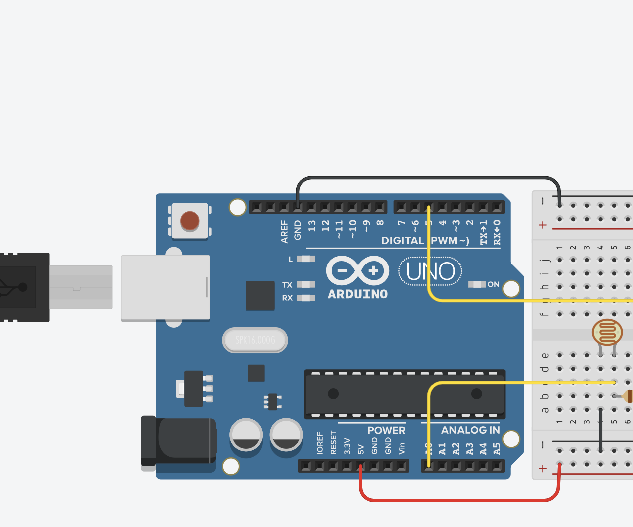

Step 3: Wiring the LCD Monitor
Attached you will see the schematic for the LCD monitor connected to the appropriate pins. Keep you eyes out for these pins later because they will be important for the coding aspect of this game. In addition, you can connect a potentiometer to the LCD monitors CONTRAST pin but that is completely optional and doesn't effect the code.
Step 4: Setting Up the Core Reaction Game Parts
There is also a schematic above for the reaction game and third unique circuit connected to the arduino. The components used are simply the two 10k ohm resistors, one 330 ohm resistor, piezo buzzer, and two push buttons. Be cognisant to properly ground and power the buttons, leds, and buzzer whilst connecting them to appropriate pins.
