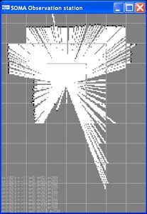

Map Building

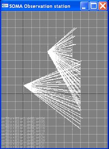

Each robot gathers obstacle data using an ultrasonic ping sensor mounted on a servo motor. The motor allows the ping sensor to gather obstacle data for 180 degrees in front of the robot. Once a reading is made, the data is stored in an occupancy grid: a data structure showing the probability of an obstacle being in space. Each cell of the grid (or pixel, in our implementation) shows the likelyhood of an obstacle being in space. As robots cover the same space, if they agree on an obstacle being in the same location the are turns darker, if they agree that the space is clear, it turns lighter.
The map dynamically grows as more space is explored. The data structure is designed to be paged on and off of an SD card. Each page contains links to nearby pages and new pages are added as space is needed. The local area is stored in an external SRAM and recently unused pages are written to an SD card on each robot.

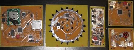

Step 5: The Circuit Boards - Intro
The next series of steps are going to cover the functionality and assembly of the individual boards. This will include a description of the circuits and a suggested assembly order for the parts on each board, as well as methods for testing each board as you put them together. Since this is a relatively difficult project we will assume that the reader has some familiarity with soldering and testing equipment, such as multimeters, power supplies, and oscilloscopes.
Since many of these boards have some small parts (many are surfacemount) you will want a good soldering iron with an un-abused tip to make things easier. We used a decent benchtop Weller for the big stuff, and a Metcal under a soldering station microscope for the small stuff. It is possible to do it all without the microscope, but it will make your life much easier if you have one, and you'll save your eyes.

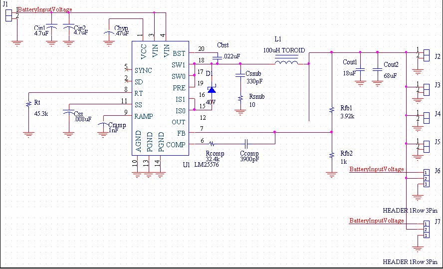

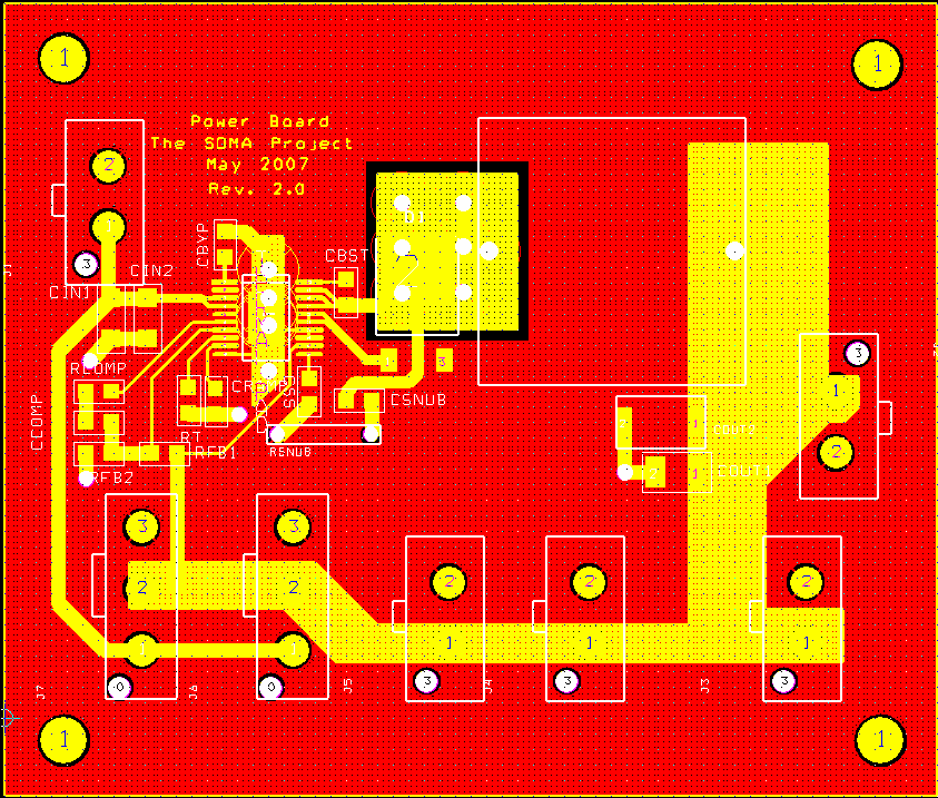

Step 6: The Circuit Boards: Power
The power board does what its name implies. It takes a 12-17V input and provides regulated 6V power to the rest of the boards. The reason for having a power board is it allows us to use a switching regulator, which can achieve over 90% efficiency. A normal linear regulator can only achieve around 65% efficiency. Since switching regulators don't provide as stable a voltage, we go down to 6V on the power board and then use a linear regulator to drop it again to 5V when it reaches the other boards.
The power board can not easily be tested as it is built, so you will need to stuff (solder the parts on) all at once. To test the power board, place the 40 Ohm power resistor across one of the 6V outputs of the power board to give it a load and give it 12-17V input. Most benchtop power supply should work for this, we'll discuss later how to use the iRobot Create(TM) battery to supply power to the additional boards. Use a multimeter to test the output, which should be within 0.2V of 6V.
The included pictures are for reference when assembling the board. The picture of a completed board is to give you an idea of what it should look like finished. You'll notice we had to use some 3pin headers in a couple of the two pin header slots. This is because we ran out of parts and didn't have time to order more. Also note that there are two output ports which are not needed for this project but are there for expansions.
The layout and schematic are what you'll need most to assemble the board. I've labeled all the parts on the layout to make it easier to figure out what goes where. Use the schematic for reference if you're uncertain about a part.

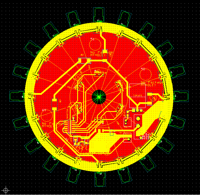

Step 7: The Circuit Boards: IR
The Infrared (IR) Board is simply an emitter and a receiver for infrared signals. It receives 6V power, unregulated power, and ground to power the components. The two smaller plugs are the input and the output for the board. The input is a signal generated by the Localization Board that controls the output of the IR LEDs. The output is an active high signal that is sent to the Time-of-Flight Board when an IR signal is received.
The first step in putting together the Infrared Board is to attach the power regulator, the capacitors for filtering power, and the power led and the resistor that goes with it. See the notes on the image for a reference of the location of these parts. The layout image has all the parts labeled.
Once the regulator and power led are in place go ahead and hook up a 6V power supply and ground to the board (the middle pin on the DF5 connector is the 6V input). The LED should light up. Also check the board with a multimeter to ensure you're getting 5V from the regulator.
Next, you'll want to connect the outer ring of IR LEDs, the 82 ohm resistors, the TIP122, the 4.7k Resistor, and the DF3 header that carries the transmission signal. Do a continuity check before you plug anything in, since these parts are going to draw a decent amount of current.
Once you're sure everything is soldered on correctly hook up the 12-17V supply and ground. You'll also need a signal generator to test this, so if you don't have one wait until the localization board is working to test this part. To test, set your signal generator to create a 36.7kHz 0-5V square wave in bursts of 11, 10 times a second. Attach the signal generator outputs to the transmission signal input on the board. Use an oscilloscope to check the voltage across the 82 ohm resistors. You should see the same signal being dropped across the resistors.
Now solder on the NAND gate chip, the other DF3 header, and the six IR Receivers (the PNA4601 parts). A basic test is to use the exact same setup as before and check the output signal. If it goes high on about the fourth edge of the 11 pulses and remains high until shortly after the 11 pulses end it's working. Once you have a second board assembled you can test distances by setting one board up to transmit and checking the output signal on the receiving board.

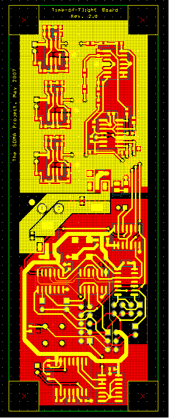

Step 8: The Circuit Boards: Time-of-Flight
The Time-of-Flight (ToF) Board is divided into two separate sections: an analog half and a digital half. The analog section receives very weak signals from the transducer. Each receiver's signal goes through two gain stages where the signal is amplified and centered between 0V and 5V. Next, each signal goes through another amplification stage for a total of 89dB, and rectified by the op-amp (which also smooths the signal when the transistors recover from saturation and cutoff). This much gain often results in the signal hitting the power rails--but that's OK--since it's only the arrival time, not the actual waveform that matters. The analog signal enters the digital domain when it passes through a comparator to turn the amplified and rectified signal into a clean 0-5V edge.
The digital half of the board itself has two sections: the microcontrollers and the completely separate transmitting circuitry. After the signal crosses over to the digital side of the board from the comparator, it is combined with the IR-on signal from the IR board through an OR gate where it then goes to the input capture on the microcontrollers. The microcontrollers gather data and send it back to the Localization Board through an SPI bus.

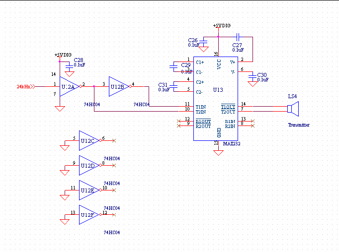

The transmit circuitry is very simple. The transducers must be driven at their resonant frequency of 24kHz for a short burst-this square wave is provided by the Localization Board. The signal is split once recieved by the ToF Board: one branch is buffered (by two sequential inverters) and the other is inverted; both then drive an RS-232 level shifter. By shifting one of the signals 180 degrees and level shifting them, the transducer is driven by +/-10V, so it sees a 20Vpp signal instead of just 5Vpp.
The ToF Board is one of the most difficult to assemble. There are a lot of small parts and it's the only board that has a serious analog portion with almost 90dB of gain, which means it's more susceptible to poor solder joints and other problems. If you don't have a soldering microscope, tweezers, and a good soldering iron for this board you're in for a lot of pain (you're in for a lot of pain with them, too, just not as much). On this board, perhaps more than any other, frequent testing is worth the hassle and will save you a headache down the road.
The half of the board with the copper pour on top is the analog half. Start assembly by soldering down the voltage regulator, associated capacitors, and the power LED and current limiting resistor. Continue assembly with the LMV358 dual op-amps and the surrounding resistors and capacitors. There are lots of tiny Rs and Cs--be careful! I found that it was easiest to solder down all the components of a specific value at a time then move to another component value. Once the first two gain stages (two stages and one channel per op-amp package) are verified to amplify and center the signal between 0V and Vcc, solder down the LMC6484 quad op-amp and surrounding Rs and Cs. Verify that this stage provides further amplification and rectifies the signal. The analog side of the board is completed by soldering down the LM339 comparator and again, all the Rs and Cs needed. Make sure to solder down all the components on the bottom side of the board and the connectors for the transducers.
The other half of the board, without the copper pour on the top, is the digital half of the board. Again, start by soldering down the voltage regulator and the capacitors that go with it. Once the digital half of the board is powered, solder down the 74HC32 quad OR-gate package and the connector to the IR board, and verify that the analog signals are successfully converted to the digial logic levels. Next, solder down the 74HC04 hex inverter and the MAX232 level shifter; verify that the 0-5V input to the ToF board is successfully shifted to +/-10V to drive the ultrasonic transmitter. All that remains are the clock and the three ATTiny44 microcontrollers. Start with the clock, making sure all pads have strong electrical connections. Solder down the three ATtiny44 microcontrollers. Before you can verify that the microcontrollers are programmable, you must attach all the headers, the pull-up resistor on the reset, and the big red reset button. Once the headers are all attached, erase and set the fuses on the ATtiny44 microcontrollers.

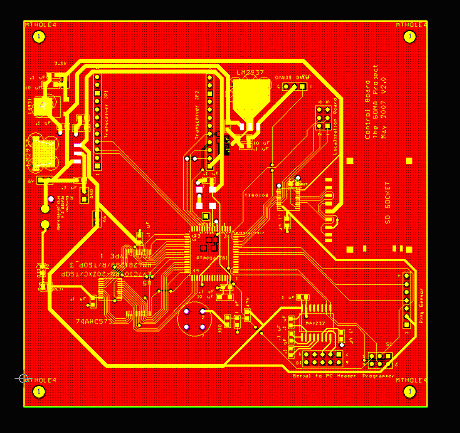

Step 9: The Circuit Boards: Control
The control board is responsible for the high level operation of the robot and for building the map. It communicates with the other robots using a Wi.232 wireless module. It communicates with the Localization Board over an SPI port. There is also a UART 10 pin connector for debugging on the PC. The board controls the ping sensor and the servo it's mounted on. Using data collected from the ping sensor and the Localization Board the Control Board builds a map and decides where it should go next.
As before, start by soldering on the regulators, associated caps, and the power LED. Soldering down all three regulators at the same time is fine, but if you want to be extra careful you can test them individually. Once they're down, use a multimeter to make sure their outputs work correctly.
The next step is to solder down the ATMega1281, the SRAM, and all the parts that go with those (the clock, caps, reset circuit, SRAM, etc.). Test the clock signal with an oscilloscope and then make sure the microcontroller can be programmed (see the programming section for how to do this).
Finally solder on everything else. Test for shorts to make sure nothing will blow up and this board is finished until the programming and debugging phase.

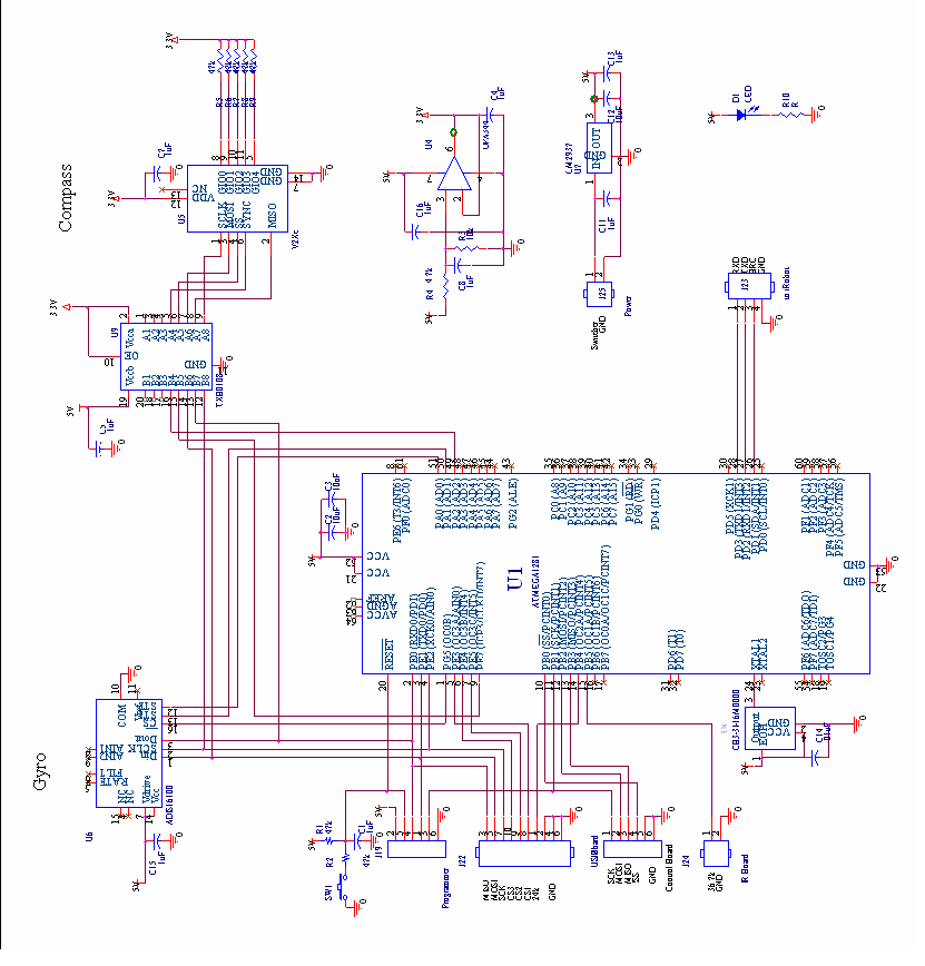

Step 10: The Circuit Boards: Localization Board
The Localization Board itself is relatively simple to assemble, but it handles a lot of things. The Localization Board is responsible for gathering data from many of the sensors, including sensors on the iRobot Create. The Localization Board also sends instructions to the Create using one of its USARTs. The main task of the Localization Board is to keep track of the robots' current position as well as the position of other robots.
The Localization Board works by controlling the Infrared and Time-of-Flight Boards, which are used to calculate the relative position of the different robots. The Localization Board generates a 24kHz signal for the ToF Board and a 36.7kHz signal for the IR Board. The signals last for about a dozen cycles, and are only emitted by one robot at a time. The other robots receive those signals, and because light travels around six orders of magnitude faster than sound, the ToF Board is able to time the difference between an IR signal arriving and an ultrasonic signal arriving at three different points on the robot. For a more in depth discussion of this method see the formal report (which includes pretty equations for how to calculate the distance and position of transmitting robots).
Another thing to note is that the Localization Board has space for a digital compass and a gyroscope. These were designed for and would have allowed more precise positioning, but due to time constraints were left off the final version.
To assemble the Localization Board, start with the 5V regulator, surrounding caps, and the power LED parts. Test the output of the regulator as in previous steps by making sure the LED comes on and that the output remains steady at 5V.
Once this is working go ahead and assemble the rest of the board (minus the compass and gyro). Make sure there are no shorts before turning on the power, and then test the board by attempting to program the microcontroller. You're now ready for the next step.

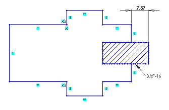

Step 14: Building the Layers - Expansion
There are 5 layers in this project, each made from 1/4" acrylic. The bottom most is the expansion layer, and ours contained nothing. It was made for future expansions. It does however act as the primary structural base for all of the other layers. The SolidWorks model shows how this based is attached. For this project, we used crazy glue to attach acrylic to plastic, and acrylic cement to attach acrylic to acrylic.
All of the screws used for the bases were 6-32. We bought an assortment of sizes, as the bottom layer needed to be screwed to the iRobot Create, which required 3/4" of clearance, while others were only used for board placement, and required 1/2" clearance.
Attached to the underside of the expansion layer is the PCB with the old pushbuttons. This proved to be the most accessible location for our layer design. Also, a caster wheel is added to the underside of the expansion layer for further stability. This requires 4 6-32 screws. Continue adding nuts as spacers until the addition of the caster wheel makes the robot stable.
A wall is placed on the expansion layer, as it provides some support for the next layer.
Support for the expansion layer comes from the two side walls. These are puzzle pieced to provide access to the Creates plastic side. An acrylic "hook" piece is made, with holes in it to screw directly into the Create. The wall in the back is also puzzle pieced, and glued into the expansion layer.

All of the SolidWorks files give exact dimensions of everything cut out.

Power is connected to a power switch and then to the power board of our system. From there, the power board delivers the correct voltage to each circuit board. The power board connects to all four of the other boards using DF5 connectors. The Time-of-Flight, Control, and Localization boards all get the regulated power from the power board and the IR Board also gets unregulated power for the IR emitters.
The Control Board connects to the Localization Board, the ping sensor, the servo, and the antenna. It uses a 6-wire ribbon cable for the SPI connection to the Localization Board. It used a 7-pin CST-100 connector for the ping sensor. For the antenna we used an SMA extension cable to run the antenna to the top of the robot. For the servo we used the connector that was provided on the Parallax Standard servo.
The Localization Board connects to the Create with a connector that we wired. On the Localization side we used a 4-pin DF3 connector and on the iRobot side a Mini Din connector. The Localization Board also connects to the Ultrasonic Board using a 10-pin ribbon cable connector for all the Time-of-Flight/Localization connections. This includes the SPI connection and 24kHz signal. It also connects to the IR board a 26.7kHz signal using a 2-pin DF3 connector.
The Ultrasonic Board connects to the IR Board and all the transducers using the 2-pin DF3 connectors.

In order to gather map information from the swarm, a PC is connected to a Wi.232 development board to communicate with the swarm. Connect the Wi.232 development board to a PC and install the drivers and associated software. To verify the PC can communicate with the robots, the Wi.232 evaluation software can be used. Start the program (downloadable from the bottom of this step), and go to the "chat" tab. Turn on a robot, and packeting data from the robot should appear in the chat window on the PC.
To actually visualize what this data means, use the SOMA observation station program. In order to use this program, glut32.dll is required. This is easily obtainable by searching for it on google. This program displays a map of all the data the robots have gathered in a window. Each robot displays on the screen in a different color. As the robots move around, they display white areas, indicating areas they know are open space. As the robots explore, these lines will become more and more solid with more well defined edges where obstacles such as walls, tables, and other furniture are explored.
Set up each of the robots in an open space all facing the same direction and spaced about two feet apart from each other. This will allow for them to start exploring without getting in each others way too much. Once all robots are set up, turn them on one at a time. After turning on the first robot, it will show up on the PC, but not move. It initially waits for there to be at least two robots before either starts exploring. Once you turn on a second robot, it will also show up on the PC, and the first robot will start exploring. It is possible to keep turning on more robots, as they will join the network and continue exploring.
