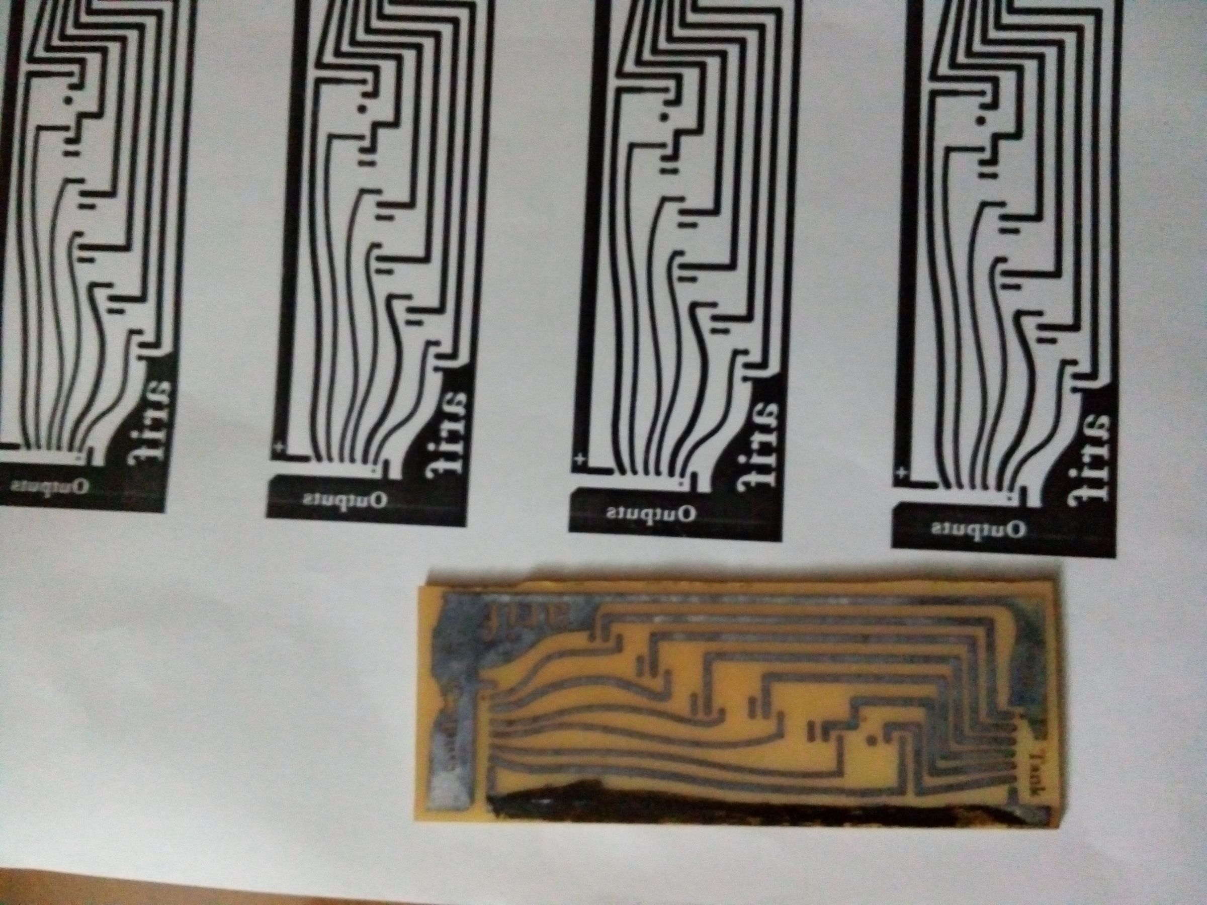

6 years ago
I have noticed , this is only good where the copper is single plane, what about parts separated. also some copper is not etched and left as a dust of board.
I experimented and found these steps to work for me:
I etched pcb in 2 steps,
Step 1: etch away all major copper via salt water electrolysis.
Step 2: etch remaining copper dust via hot Vinegar+hydrogen per oxide + salt water
