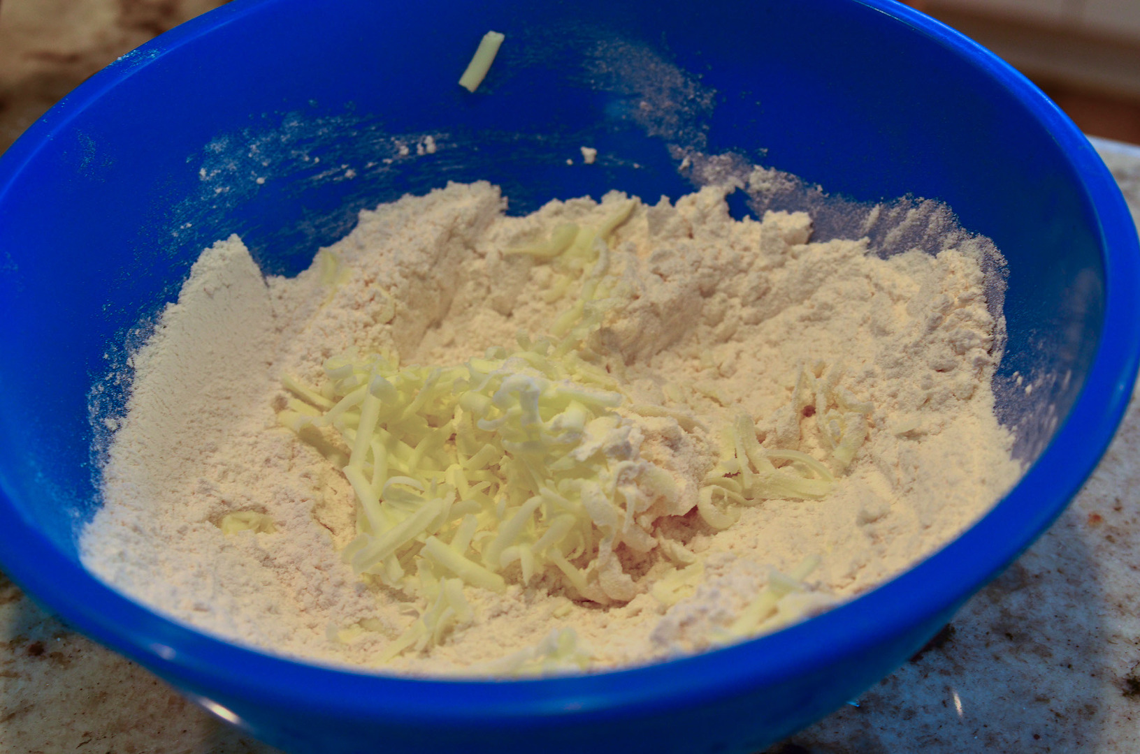

- This can be the hardest step. The goal is to turn your fat into a bunch of little pea-sized pieces coated with the dry ingredients.
- Preferred method: If you're using butter, it's easy: just grate the butter with a cheese grater.

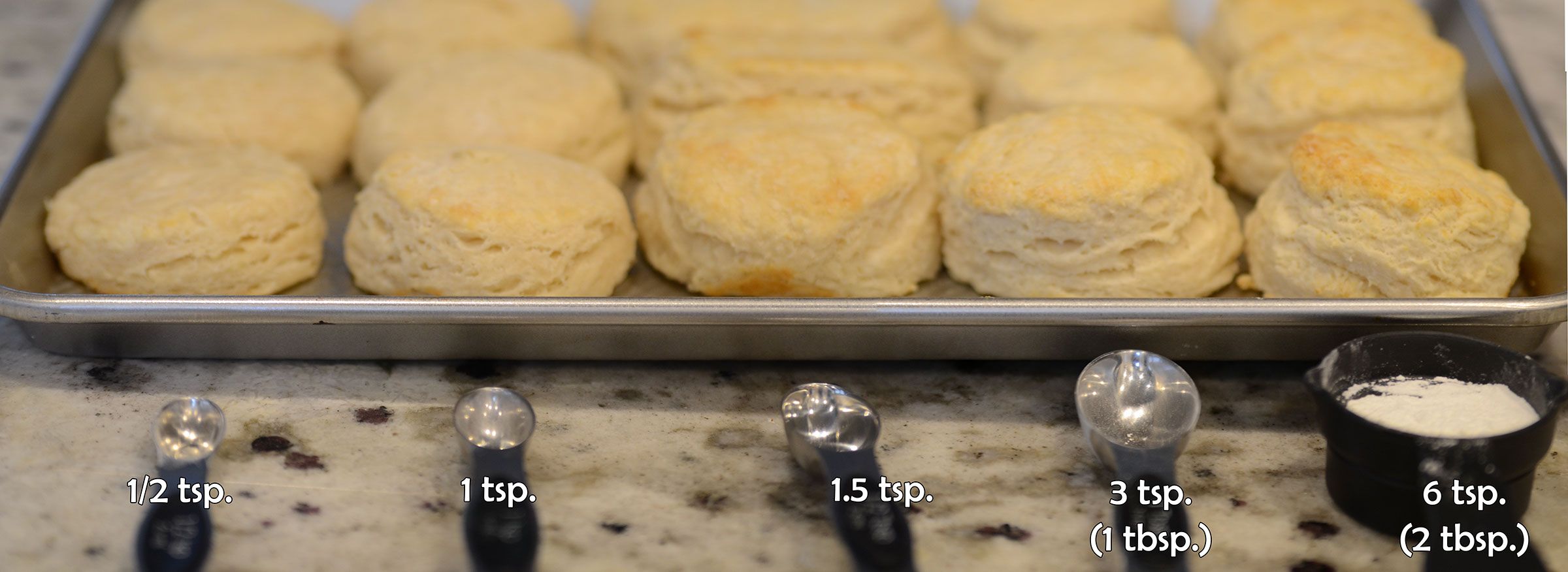

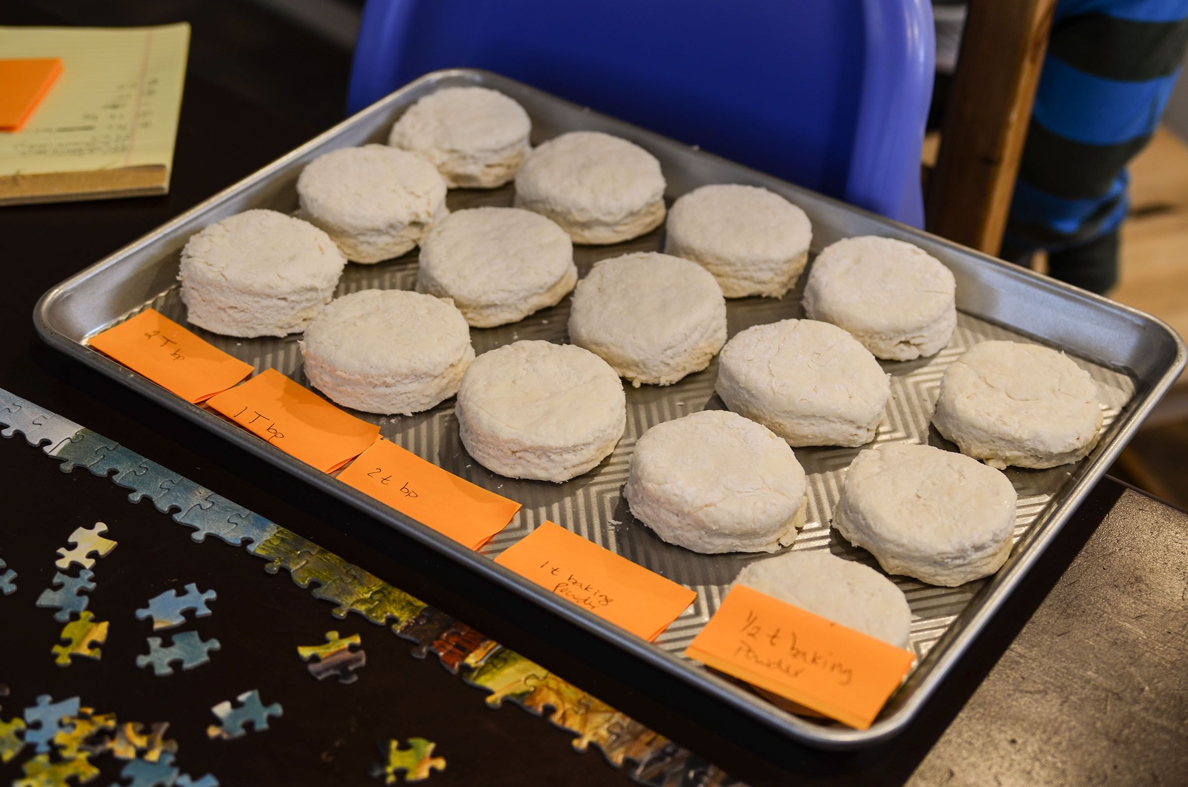

To find out, I made five different batches of biscuits. The only difference between the batches was the amount of baking powder used:
- Batch 1: 1/2 teaspoon baking powder
- Batch 2: 1 teaspoon baking powder
- Batch 3: 1.5 teaspoons (1/2 tablespoon) baking powder
- Batch 4: 3 teaspoons (1 tablespoon) baking powder
- Batch 5: 6 teaspoons (2 tablespoons) baking powder
I then took a time-lapse video of the biscuits as they baked. The pan has three representative biscuits from each batch. Oven temperature is 425 F.
The video shows pretty clearly that a lot more rising occurs when you use more baking powder. This picture, taken right after the biscuits had finished baking, shows the same thing:
But what about taste?
Both taste testers (my wife and I) thought that batches 1 and 2 (with only a tiny amount of baking powder) were noticeably denser and moister than the others. The texture wasn't the nice, flaky, classic biscuit texture we both like.
For batches 3, 4 and 5 (with half to double the base recommended baking powder amount), the taste difference was almost indistinguishable. My wife thought the batch with the most baking powder was best, while I thought it tasted a tad too salty and chemically. My favorite was the middle batch, with 1.5 teaspoons of baking powder, but my wife thought this one was a little too dense.
Conclusion: More baking powder makes the biscuit rise more (imagine that!). About 1 tablespoon of baking powder per 2 cups of flour seems to be about the right amount, but even halving or doubling this amount should not ruin your biscuits.

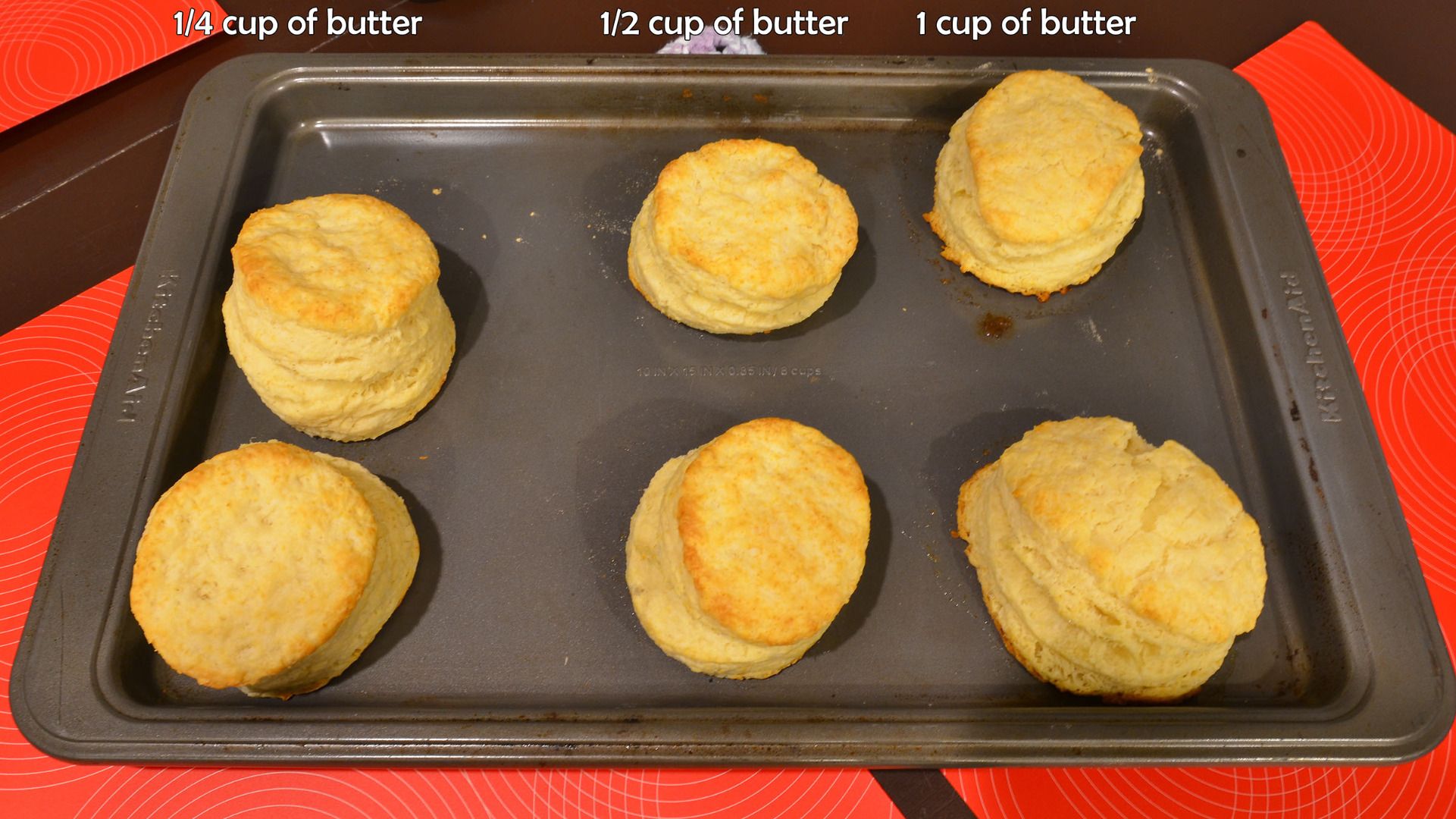

To find out, I made three batches of biscuits that were identical except for the amount of fat used (in this case, butter). Each batch uses two cups of flour and normally makes 8 biscuits, but I only cooked two biscuits from each batch so that I could make sure the baking conditions were exactly the same for all of the biscuits.
- Batch 1: 1/4 cup of butter (1:8 ratio)
- Batch 2: 1/2 cup of butter (1:4 ratio)
- Batch 3: 1 cup of butter (1:2 ratio)
I then took a time-lapse video of the biscuits as they baked. The pan has two representative biscuits from each batch. Oven temperature is 425 F.
As we saw with the liquid experiment, "drier" biscuits tend to rise more (in this case, the biscuits with less fat tend to rise more). in this case, it appears that the biscuit structure is just a lot more stable (structurally speaking) when there's less butter. When you get a lot of butter, you're kind of filling your biscuit with holes, which makes it unable to bear its own weight to rise very far.
So, you definitely get flatter biscuits when you add more butter (incidentally, the same is true with cookies... if your cookies are running all over the pan when they bake, just reduce the amount of butter/shortening and they'll hold their shape much better).
This was a tough one. Increasing the amount of butter definitely makes the biscuit "taste" softer, more crumbly, and more flaky. I usually associate flakiness and softness with size; you expect a big biscuit to be fluffy and soft, and a biscuit that doesn't rise to be dense. But, at least right out of the oven, the super buttery biscuits really melt in your mouth.
But the biscuits with 1 cup of butter seemed too rich to my wife and I, and I suspect that after cooling down, they would be dense and gross. The biscuit with very little butter wasn't as soft and flaky, but it was more structurally sound.
Conclusion:
None of these biscuits were bad, but again, the middle option seems to be the best choice. A ratio of 1/2 cup of butter to 2 cups of flour (1:4) seems to work pretty well.

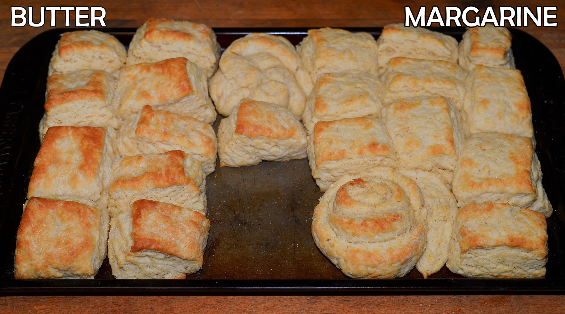

Step 6: Butter Vs Margarine
All biscuit masters agree: if you're going to use butter, use real butter, not that fake crap (margarine).
But margarine is usually several times cheaper than butter, and some argue that it's healthier. Could it really be all that bad for making biscuits?
To find out, I made two batches of biscuits that were identical except for the type of fat used.
- Batch 1: margarine
- Batch 2: butter
I cooked both batches on the same cookie sheet at 425 F, so baking conditions were identical. I had six taste-testers, and I did not tell them which biscuits were which until they'd given their opinions.
It was difficult to tell any difference in appearance between the biscuits. Both turned out pretty nicely: fluffy, flaky, and crispy on the thin outer crust.
What did the taste testers say?
- 5 of 6 taste-testers preferred the margarine biscuits
This surprised me. I asked how sure everybody was of the difference? Three of the five that chose margarine biscuits were only 20% sure of their choice. One was 80% sure, and the last (a smart alec) was 64% sure.
What reasons did the un-witting margarine lovers give? Better texture and taste.
What about the dissenter, who liked the butter biscuits better? She was also only 20% sure, and said that the butter biscuits (which she did not know were butter biscuits) were moister.
Conclusion:
If you're a purist and just can't stomach the "fake crap", then by all means use butter. But if you want to save a few bucks and a few calories, margarine is a great alternative that may even make the biscuits taste better.
