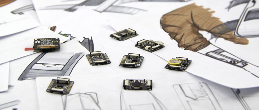

For electronic part.
* [Grove - Moisture Sensor](http://www.seeedstudio.com/depot/grove-moisture-sensor-p-955.html): It looks like human legs! under side of the main body.
* [Xadow - Main Board](http://www.seeedstudio.com/depot/xadow-main-board-p-1524.html): really small board! Using Arduino programming it.
* [Xadow - LED](http://www.seeedstudio.com/depot/xadow-led-p-1518.html): Small and beautiful, to show the moisture of soil detected. From 0-5, dry to wentt.
Of course, you can find other arduino & sensors if it matches the size of craft.

Xadow modules are connect using FFC cable, so it's easy to bend, don't forget the direction(let coner of boards towarding same side), but disorder is allowed.
A little bit hard to add the grove part. Add a grove dock on the breakout board (I2C interface), then use A5 pin connect ADC.
