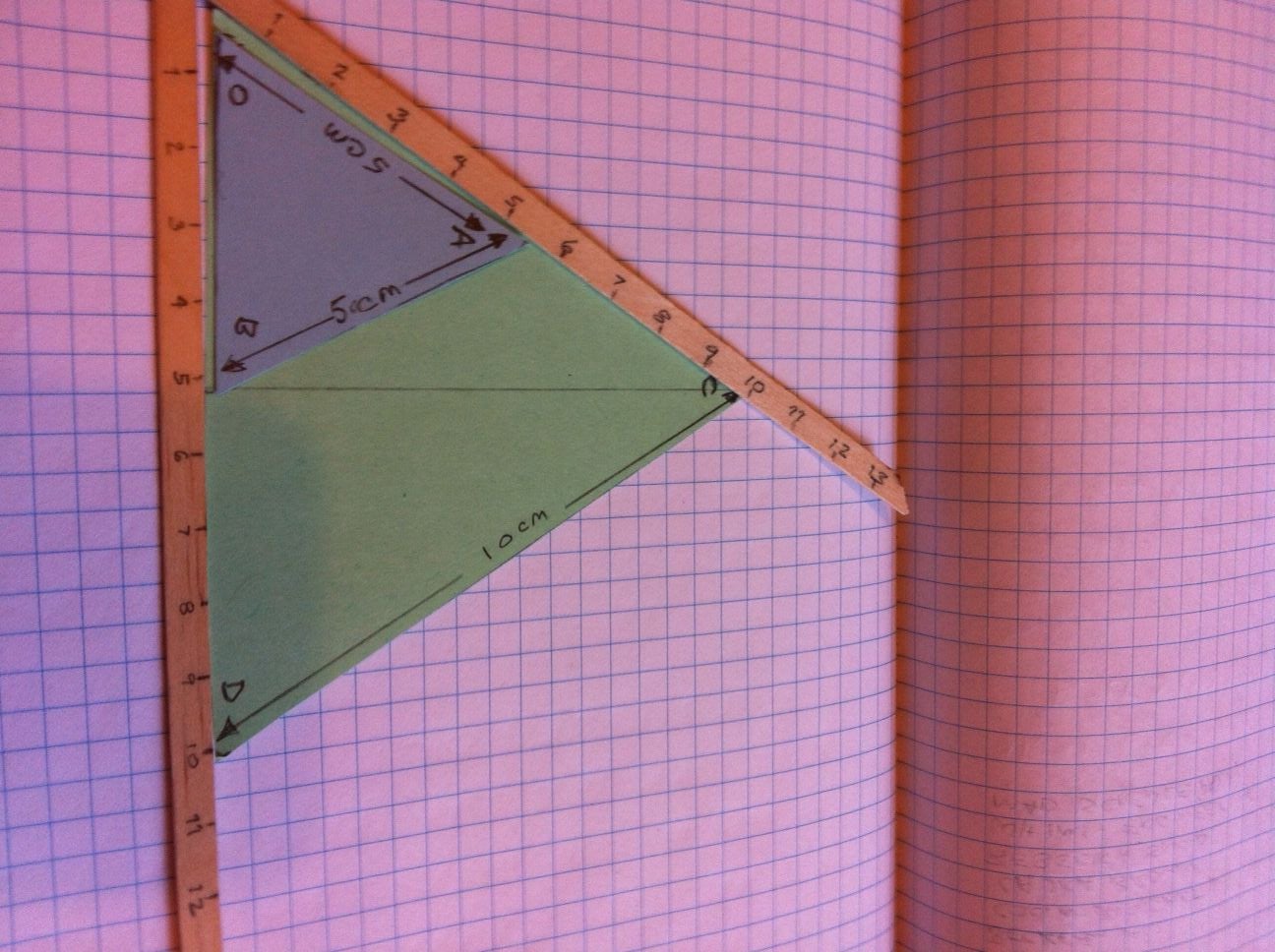

Step 3: Set the Angle
The proportional scale of the vector works on the principle of similar triangles. Similar triangles have sides that are proportional. The angle for the sector will be set at 60 degrees. When you measure from leg to leg, you are essentially creating an equilateral triangle.

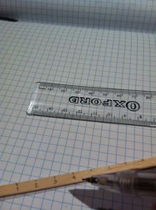

Step 4: Mark Off Increments
Starting at zero, mark off your increments. The coffee stirrer is slightly longer than 13 centimeters, so I used centimeters as the unit of measure.
Step 5: Check Your Measurements
Even though we're not using this sector for navigational purposes, it's best to check each of the increments to see if they create equilateral triangles. The goal here is practical precision (good enough for who it's for). With patience and a steady hand you should be able to mark off millimeters.

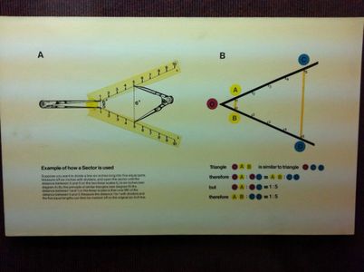

Check out the Science Museum's chart for a simple, and graphically satisfying, explanation of the instructions:
Suppose you want to divide a line six inches long into five equal parts. Measure off six inches with dividers, and open the sector until the distance between the 5 and 5 on the linear scales is six inches apart. By the principle of similar triangles, the distance between 1 and 1 on the linear scales is then one fifth of the distance of the distance between five and five. Measure the distance 1 to 1 with dividers and the five equal lengths can be measured off the original six inch line.
In our similar triangles from Step Four, you can see with the linear scales how the different sized triangles are proportional.
