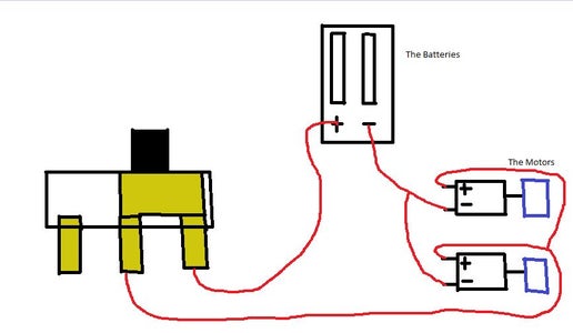

Step 7: The Wiring
You might think this is the worst part, but it is quite fun! So you'll need to grab that battery holder and the switch. First, the battery holder has two metal leads on it near the bottom. There is a positive lead and a negative one. The negative one goes directly to the - of your motor. You can go ahead and use two pieces of wire and attach one to each lead on the battery holder. Once you have them on there with hot glue, hot glue the holder to the base.
The Switch- The switch has three leads coming out of the bottom of it. Above is a drawing I made of one. The goldish color represents conductive material, which mean electricity can flow through it. The top black part of the switch (that you move) is connected to the large conductive piece. When you move the switch to the left or right, you are connecting either the left two leads or the right ones, allowing electricity to flow through it. So if we want the switch to control the electricity going to the motors, we need to put the positive wire coming from the battery holder to one of the end leads. We also need the motor connected to the middle lead. So I put my battery on the far right lead. So, when the switch is to the left, it is connecting the motor to nothing, so it will not run. But when it is to the right, it is connected the the battery which supplies electricity and both motors move.
I have made a small diagram showing where all the wires go. It's very easy to read. Red lines are wires. Connect all the wires by twisting them together and then putting some hot glue on the connections.
