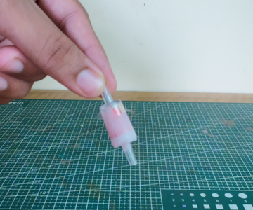

  3. Check Valve

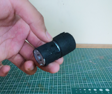

  4. 6V DC Mini Air-Pump

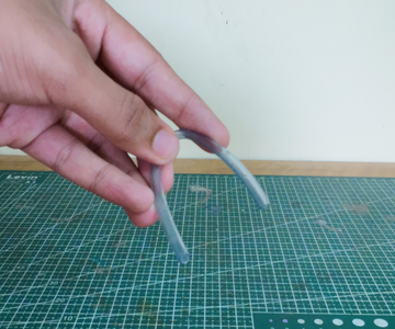

  5. Silicon Tube for Air-Flow

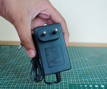

  8. AC to 12V 5A DC Power Supply
  9. LM2596S DC-DC Buck Converter

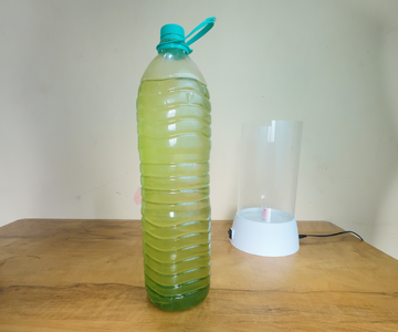

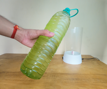

Step 3: The Algae : Scenedesmus
I have chosen the Scenedesmus algae for this Photobioreactor. I had already grown a culture of 2 Liters of Scenedesmus for around 4-5 days, you can however introduce a fresh batch directly in the photobioreactor as it is intended for the same.
More about Scenedesmus :
Scenedesmus is a genus of green algae, in the class Chlorophyceae. They are colonial and non-motile. They are one of the most common components of phytoplankton in freshwater habitats worldwide.

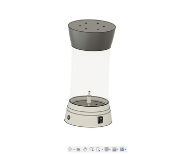

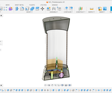

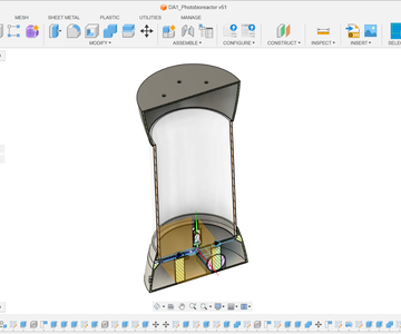

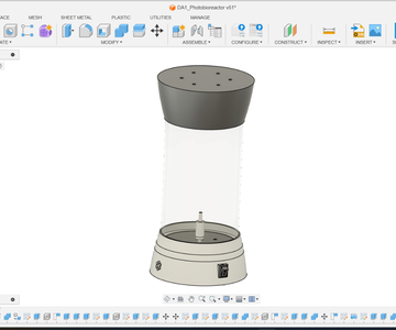

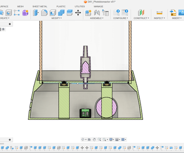

Step 4: CAD Time

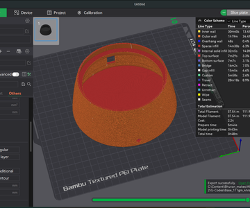

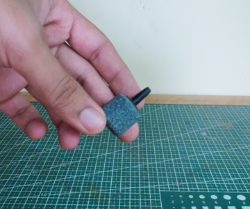

The design of version 1 Photobioreactor has been kept intentionally simple to be printable without support material. A slight curve was introduced on the base profile to make it a little presentable as a desk version. I have used Fusion 360 to design this Photobioreactor, however you can use any design software of your choice. The base encloses and firmly keeps the acrylic container. I have introduced an inlet from the base for the air pump to continuously agitate the algae and infuse air in the substrate to help the algae growth.

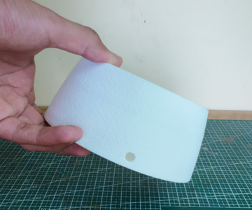

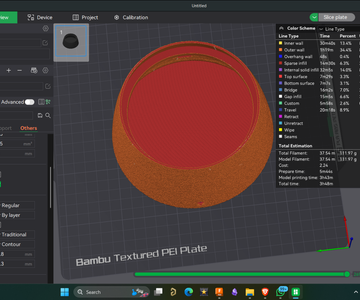

Step 5: 3D Printing

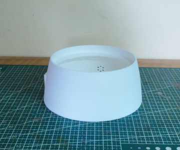

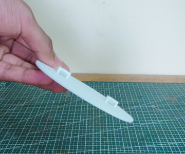

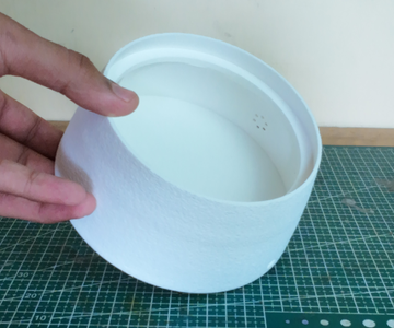

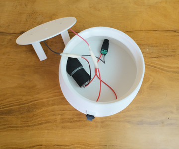

I 3D Printed the base compartment of the Photobioreactor to house all the electronic components securely and hold our acrylic cylindrical container firmly. This design has been 3D printed on a Bambu Lab A1 3D printed but you can use any FDM 3d printer of your choice, the files have been attached !
Step 6: Assembly

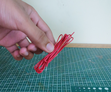

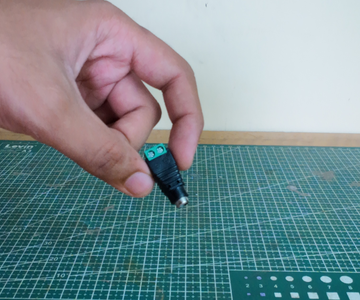

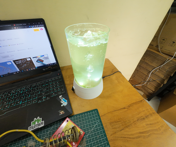

Next I assembled all the electronic components inside the enclosure while securing the container for Algae over it in the designated slot.

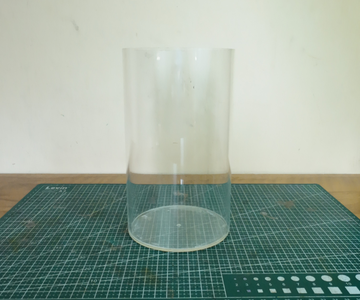

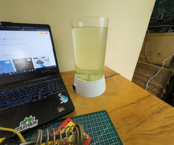

Step 7: Cleaning the Container
It is essential to clean the insides of our cylindrical acrylic container before introducing our algae inside it. Hence I have used some ISO Propyl alcohol on a tissue paper to properly sanitize the insides of the acrylic cylinder.

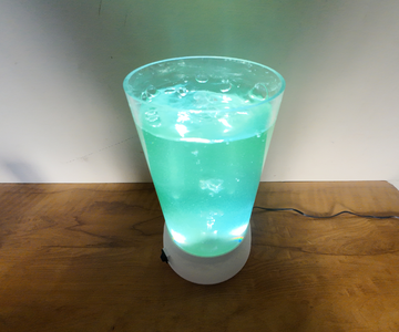

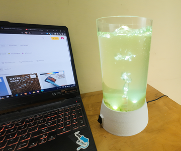

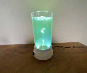

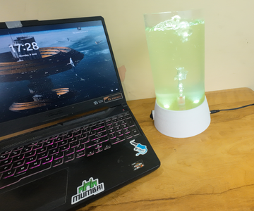

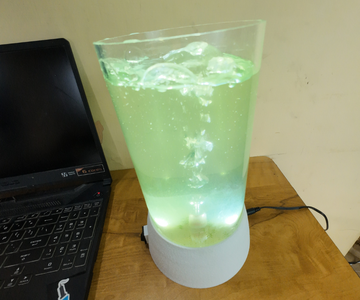

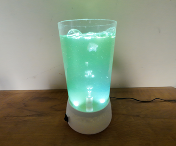

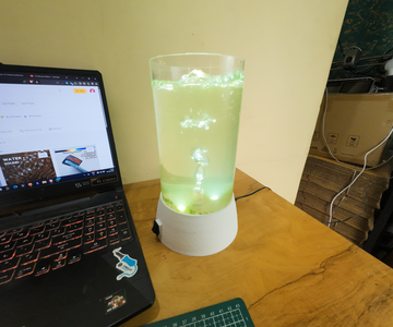

Step 8: The Photobioreactor Is Ready !
And finally here is the complete photobioreactor, a simple and easy to reproduce design intended for indoor use to grow algae of your choice, parameters such as number of LED lights, air pump flow etc can be controlled based on the requirements for different species of Algae.
