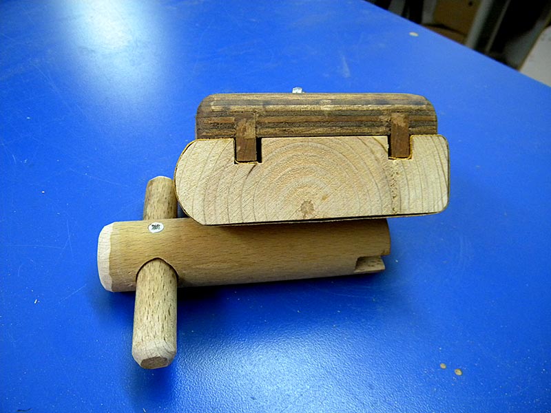

I have also made a drill press table from an old office shelve together with a plywood fence that pivots at one point and a stop block. Some home made hold-down clamps run into the two T-tracks which are nothing more than simple curtain aluminum tracks. The drill press table has two ¼ (6mm) plate inserts on top each other, one has the standard drill press hole opening and the second plate a larger hole to fit my drill press spindle sanders.
Another accessory I made for my drill press was to attach over the drill press table a piece of plywood base with two homemade knobs to hold onto the t-tracks and my drill press vice mounted on it.

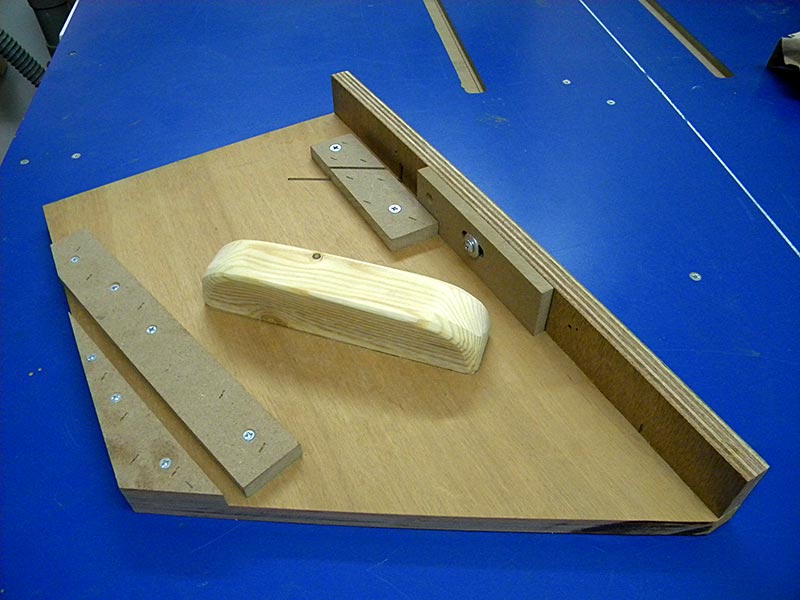

Step 8: Cross Cut Sled
My cross cut sled is 2X2 feet of 1/2 plywood, 2X4” fence and an acrylic piece for safety. A mixed design from various ideas runs on metal miter track bars and its true 90º, can do without it.
