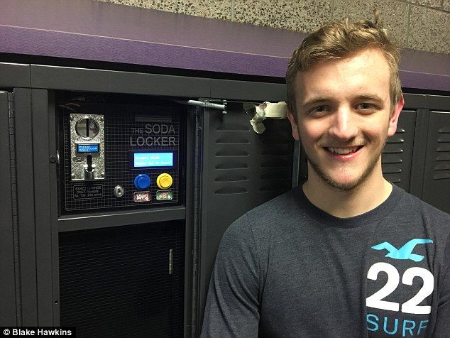

Step 3: Creating the Control Panel - Thanks to the School Laser Engraver
You can't make a vending machine out of a Nike shoe box. Lately, I've been taking advantage of our school's new Epilogue Mini 24-inch laser cutter. I decided to use black acrylic for the front face of the vending machine. It cuts nicely, and it looks pretty clean as well. After programming the control panel, each component needed a home. I had to make sure nothing ran into anything else from the back side, given that things like the coin acceptor and battery take up a substantial amount of space.
I did a quick mock-up in Photoshop before drawing the panel in CorelDRAW. This is a great time to name the machine! I liked "The Soda Locker." I ended up liking the engraved grid look in the background with rounded rectangle borders. I cut a few holes for the button, keyhole, screen, logo displays, and coin acceptor. Then I mounted everything in its designated spot. I also put two pieces of clear acrylic to cover the logo displays.

Step 6: Money Cheat?
It didn't take long for me to realize there would occasionally be an extra 5 cents in the machine after being a while. This was NOT good. After trying to diagnose the problem, I found that after pulling a blanket over my head, touching a quarter to the front face of the coin acceptor would activate a pulse or two giving you 5 cents, just for static electricity! I'm not an electrician, but I assumed that grounding everything, including the front plate would fix the problem. However, the lockers are painted. I didn't want to modify the locker at all, so grounding wasn't going to work. I decided to fix the problem with a bit of programming.
I started by measuring the distance of time between each pulse for a coin. It ends up being about 130ms apart, as long as you use the fast setting on the coin adapter. Then I modified the coin program sketch to check to see if each pulse is 130ms apart from the last pulse. If this is true, then one 5 cent pulse is added to the coin value. But, if you think about it, the very first pulse from any coin has a greater distance of time from it's last pulse. The last pulse was the coin inputted before. So, for instance, putting a quarter in counts for 4 pulses, giving you 20 cents. Nickels didn't even work, because one pulse couldn't possibly be 130ms apart from the last, unless you put two nickels in that quickly.
To solve this, I just reprogrammed the coin acceptor to pulse twice for nickels, three times for dimes, and six times for quarters.
What did all of this gibberish do? Now, unless you can shock the coin acceptor with static electricity at least two times, exactly 130ms apart, then there is no way static electricity will ever count for a coin.

After day one, the vending machine was a hit! On average, 6 cans are sold in just one passing period. Although to me, it was far more rewarding to hear "Dude, have you checked out locker 808 yet?" as students passed each other in the hallway.
This project has taught me so many things including Laser cutting skills, new programming techniques, and put my mechanical engineering abilities to a test. With this being my last semester of senior year, I'd like to eventually buy a locker of the same style and keep the Soda Locker with me in the future. Then when somebody at a reunion asks "Remember locker 808?" I can say I've kept it all along.
