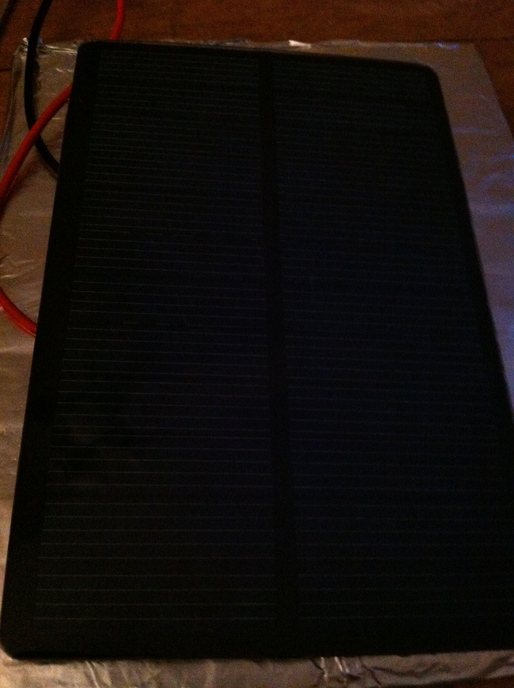

1X 12v Monocrystaline Solar Panel from
Amazon $20

Take the positive and negative ends of the solar panel and attach it to the two paper clips that are in the holes under the solar part. Connect the positive to the positive and the negative to the negative. Then take battery leads and attach them to the battery and the two paper clips under the battery part. Finally connect the cigarette lighter adapter from the inverter to the other cigarette lighter adapter with the leads. Then take the positive and negative ends from the inverter and attach them to the positive and negative paper clips where your output will be.
