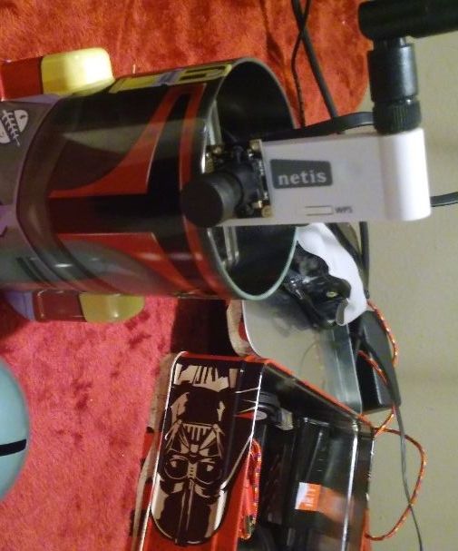

Step 9: What's Next?
The BoBoBot?
The Bobofet Robot.
The Remote Accessible.
The 5 Megapixel 1080 High Definition Security Camera Bot.
WiFi
Cellular
Bluetooth
Lithium Ion Battery Powered USB 5v
Hotspot? Why not!
Stay Tuned...
