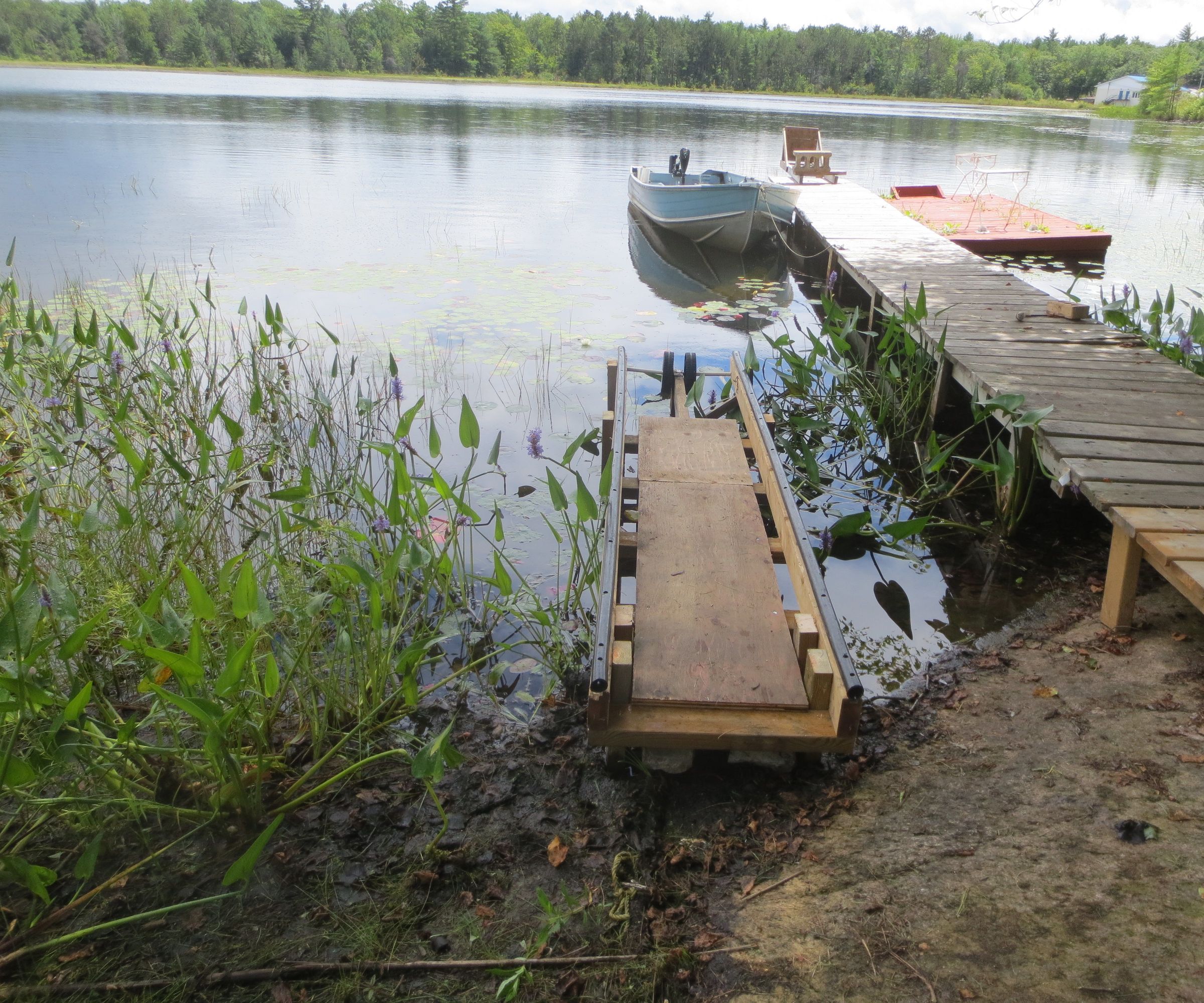

Step 4: Get Water to the Tub
Difficult to see but mounted a submersible pump to the side of the dock and ran sump pump flexible hose to a high flow water filter (shown next photo) then looped over the tub’s edge.

Step 9: View of 'The Spa' From the Lake
