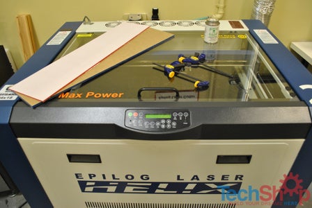

Step 1: What You Need
For this project, I used 2 different colors of acrylic. Choose 2 of your favorite colors. I've seen similar types of spanking paddles sold online with just a single sheet 1/4" acrylic. We will be using 3 separate layers to provide more mass and a more rigid paddle. I advise against the single layer paddles since they do shatter if you spank someone hard enough. Practice safe spanking.
Materials:
1x 1/8" acrylic 15x6
1x 1/4" acrylic 15x6
Acrylic Cement
Tools:
Clamps
Laser Etcher
Materials:
Acrylic Cement
Tools:
Clamps
Laser Etcher

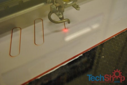

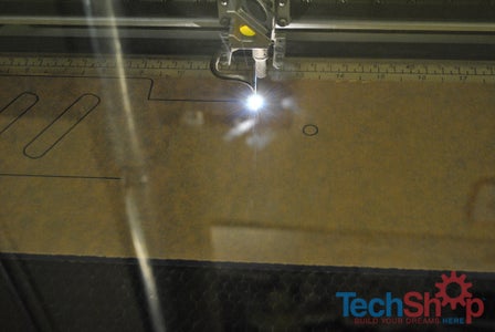

Step 3: Fire in the Hole!!! Its Time to Cut.
Here is the middle layer being cut out. This is the 1/8" piece. I leave the protective film on while I do my cuts.
Settings for a 60w laser (your settings may vary)
Vector cut
Power 90
Speed 17
Freq. 5000
Vector cut
Power 90
Speed 17
Freq. 5000

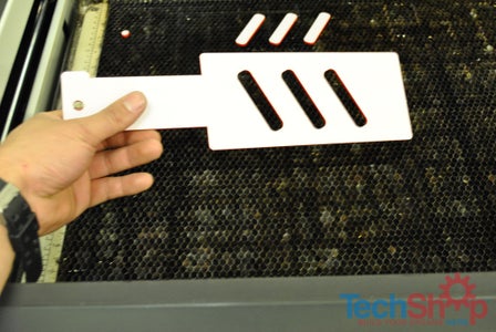

Step 4: Fire in the Hole Part Deux
Here is the 1/4" layer being cut. We going to cut 2 pieces out of this. These will be the "bread" of our sandwich. Again, do not peel off protective film.
Vector cut
Power 90
Speed 12
Freq. 5000
Vector cut
Power 90
Speed 12
Freq. 5000

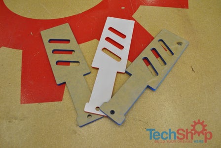

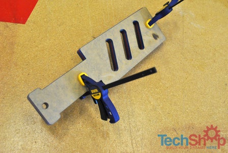

Step 5: Time to Peel
Here are the 3 pieces laid out. Now its time to stack them on top of each other with the thinnest layer (1/8") in the middle. Make sure the design lines up and just peel the protective film from the sides that are going to be glued on.

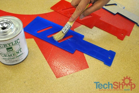

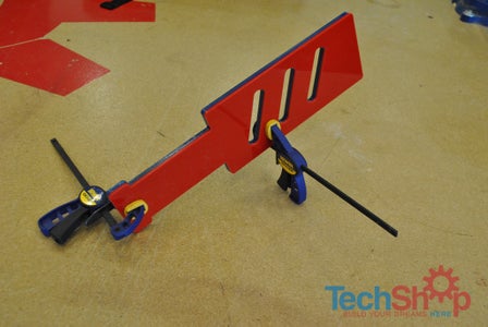

Step 6: Glue and Clamp
Now we can use the acrylic cement to glue our pieces together. I find that a paint brush is the best way to apply the acrylic cement. You can do 2 pieces at a time or all 3. Once aligned, clamp the pieces together. Wait for it to set for at least 15 min.

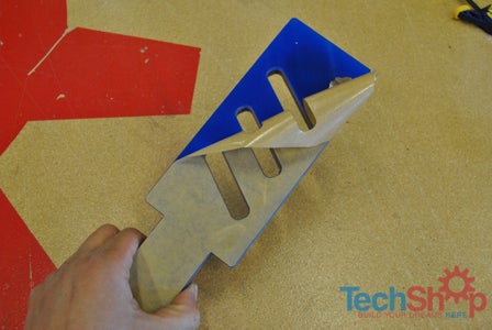

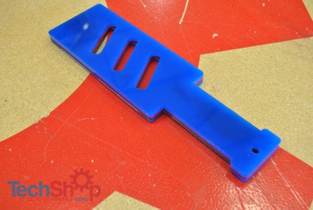

Step 7: Peel the Outsides
Another reason for not peeling the protective film on the outside parts of the paddle is that just in case you spill acrylic cement or get some on your fingers, it will protect the outside finish of your paddle. So just peel it off after the acrylic cement dries and you have yourself a finished paddle.
