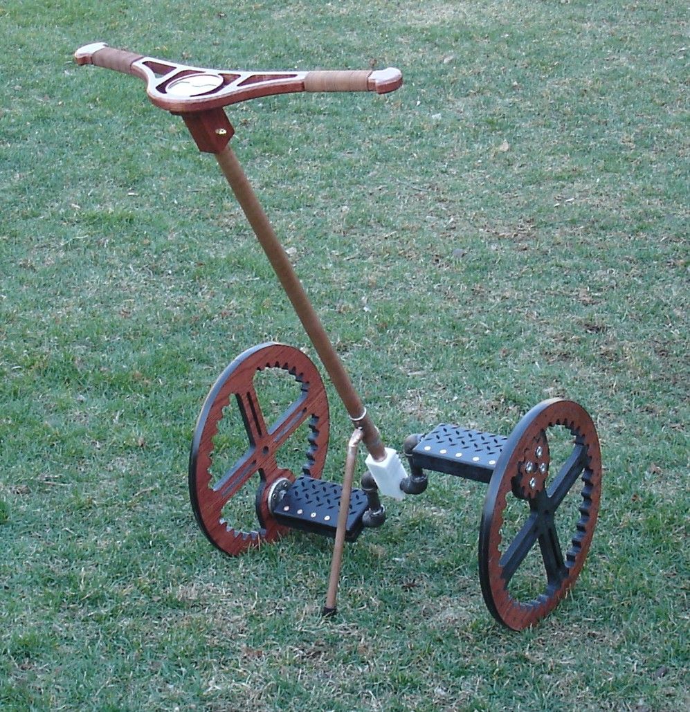

Introduction: The SteamRoller Riding Contraption
This a self balancing two wheel, two person vehicle. It self balances because the center of gravity is located below the center of the wheels.
Each rider controls one wheel. Pedal together and you move in a straight line forward or backward. Anything else is a turn including a spin in place by pedaling in opposite directions. I guessed a top speed of around 7mph would be a good start. I set the gear ratio accordingly. It was designed for kids around 5' tall, but it can easily handle taller. I am 5'6" and about 160lbs. I rode it with my daughter and it worked well.
This instructable details how to make a basic version. I designed everything in Pro/E. I have exported all the parts to DXF format so you can access with free software like QCAD. The drawings have basic dimensions for overall reference. They are 1:1 so you can scale off them or add additional dimensions. There are also PDFs too. I used my homemade CNC router so I added a lot of details that are not required. Need more info, detail, pictures...just ask.
The project took me about 16-20 hours over 3 weeks to build. A lot of that was design and testing, so it could take you less time. I had a lot of left over and found material that I used. If you started from scratch this could cost $150 to $200 to build. The bearings and drive train parts are the most expensive. I bought them at a surplus store. Hopefully you can find them cheaper.
The design worked pretty much as intended without any major problems. I did learn a few things along the way. I added "possible improvements" sections to each step that might make your version better and easier to build.
The working name is SteamRoller due to the steampunk look. The kids like Wheels of Doom and Portable Porch Swing. Does anyone else have any suggestions?

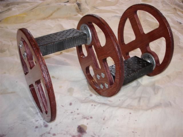

Step 3: Wheels
The wheels should be as big as you can cut from the plywood. I made mine 46" dia. because that is the biggest my router could cut.
The bearings I got were are aligning. This means the bearing axis will tip away from perpendicular as need to align to the shaft. Therefore the wheel will not stay straight unless you put one on each side of the wheel. This will prevent the wheel from canting on the axis. If you can find a better cheaper solution, let me know.
Mark the center of the wheel. Use a bearing block to mark where to drill holes for the bearing mounting holes. Draw the diameter and cut out. I made some spokes to lighten up the wheels, and give visibility to the sides. They also help with the steampunk look.
I used a 1/4" radius bit in my hand held router to put a small radius around the both sides of the perimeter of the wheel. This allowed the tire to fit smoothly without sharp bends.
Mount a bearing block on each side of each wheel. Use a pipe to temporarily line them up.

Step 4: Pedals
The pedals shafts are made from 3/4" thick wall copper pipe and 90deg fittings. The pipe has a 7/8" O.D. that works with the pedal shaft bearings.
Cut all the pieces and liberally flux all the mating surfaces. Put all the parts together to make sure everything lines up, is square and the ends that go through the bearings are on the same axis. I suggest cutting the center vertical piece last in case it needs to be adjusted in size. Keep all the pieces together while brazing. This will make sure they stay square while brazing and will reduce the heating time. I suggest placing an extra fitting on the ends to keep that piece on the same plane. Don't accidently braze those pieces on.
The outer diameter is slightly larger than the I.D. of the 7/8 bearings. I lightly sanded them down to fit though the bearings and shaft collars.
The pedals are made from 2 pieces of 3/4" wood screwed together and drilled 1" dia. This will allow them to be replaced if they are ever broken.

Step 8: Riding
I was worried about how people would mount the thing, but it is not an issue. You just kind of crawl in. It helps to have someone steady it, but it is not required. With someone's weight way forward the nose contacts the ground and this keeps things stable.
The physics work like this: The pedals allow you shift the center of gravity (CG) of the porch swing forward or backward. The wheels then rotate to return the CG to normal. Climbing hills or getting started on soft ground will require a greater shift before it will roll. This can get a little scary (but fun) as your feet start to point to the sky. New riders might need a push if they get too stuck.
Some small kids who stretch to reach the pedals or don't have much weight behind the axels tend to rid very low in the front and may tend to bounce the nose. I added a little box to the top of the back of the seat. This allowed me to add and remove a brick or two of ballast to get the nose up as needed.
Coordination to go straight is not that tricky. Either rider usually adjusts a little to correct the heading. It is fun to watch kids riding for the first time working out the coordination. Some kids tend to just stop pedaling and freeze when they don't know what to do. This of course causes the thing to immedaitely pirouette on that wheel.
It occured to me that this would be relatively easy to motorize with some wheel chair motors. A joystick with some relays could control it. I think I will keep mine old school though.
