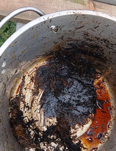

I ended up putting up a temporary frame on the side to hold the pot. That way, I have good access to the pot. The main job in the first part of the year was steaming soil to kill weed seeds and pathogens. Last year, I showed that steamed soil has huge benefits when you grow lettuce. (20% faster growth rate when I transplanted lettuce seedlings into steamed soil!) so, if it could be done efficiently and quickly, steam sterilization by solar cooker, could become a "thing". I had a 14 liter pot, that I painted black to absorb the heat. First, I put damp soil in it. But it took a long time to get hot and steamy, and also, the soil at the bottom burnt. Next I put lawn mower cuttings at the bottom, with some water, then soil above, and some of the lawn mower clippings burnt and steaming was still slow! So, I was accidently making biochar! The outside of the pot at the bottom where the light rays struck it was getting very hot, (above 200 C sometimes) and I thought that was a bad thing because metal at 200 C is losing heat quickly to the air by convection and radiation. How to fix that? So, I made a little wooden support "cross" about 5 cm (2 inches) tall and over that I put diamond mesh and a splash guard for a frying pan that fit snugly in the 14 liter pot. Then I filled it up to the wire with water. I was afraid that soil would fall through into the water, so I added a layer of lawn mower clippings first, then a shovel of soil, then another layer of lawn mower clippings, then another shovel of soil, and layered it to the top. Last layer was soil. It worked! The metal of the pot at the bottom got to 110 C max, now. and that meant that the water quickly took the heat away. After a few minutes, I could hear bubbling. Eventually steam came out of the top. I used an oven thermometer to check the temperature at the top in the middle down a couple of cm. If this was above 95 C, I deemed the soil "steamed" and took out the batch. I had another pot of almost the exact same size and for a while I exchanged pots. But here is the thing. Roughly half the water in the chamber boils off and ends up in the damp hot soil, after a couple of hours when the soil is steamed, you have significant hot water down there in the chamber. I found a better option was to empty the soil out of the pot, top up the hot water in the chamber, and layer lawnmower clippings and soil back into the same pot. That mean I kept the heat of the water and the bottom of the pot for the next batch. On a sunny day, it ended up that I could steam about 4 batches of soil (roughly 40 liters). I filled planters with it, and used steamed soil in some sections of my greenhouse, I also dug out soil to about 15 cm deep (6 inches) in one area, and I topped up a planter for the top 9 cm (3 1/2 inches). This was to see the effects of doing it different ways. In all cases there was a massive reduction in the amount of weeds that emerged. And plants generally did really well
