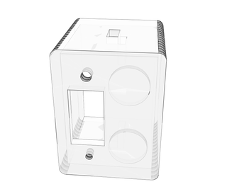

Step 8: The Case - 3D Printed Version
Now that the electronics are finished and working. Now there are a couple of options you have. First is the template above which you can stick to wood and cut out using a jigsaw. The second option is using the ".stl" files or the "Autodesk123D" that I have attached here. However, I haven't printed this out personally and do not know how well the print will hold up. The files are editable, so you can make any changes you feel like!
