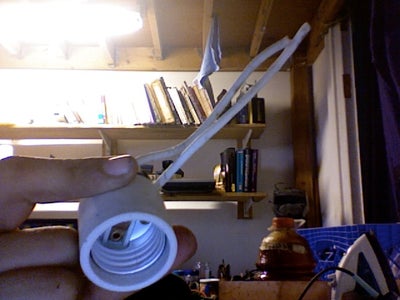

Step 1: Urban Recycling
Here's how this part of the instructable is free!
The alley behind my house fills up with all manner of cast-off junk on trash days - windsurfer masts, foam Sox #1 hands, dishwashers, lamps, and more. Every single week. So I waited around until someone threw out one of those tree lamps and harvested its three low-hanging Edison socket-fruit.
Free Edison sockets!! Did you know light bulb sockets were called Edison sockets? I didn't. I like the term a lot.
I didn't exercise the patience to wait for another trash day, though, and just picked up the rest for around $0.40 each at the Urban Ore Ecopark, which is this gigantic urban recycling center that takes, sorts, and resells useful junk of every color, in Berkeley, CA. Go there.

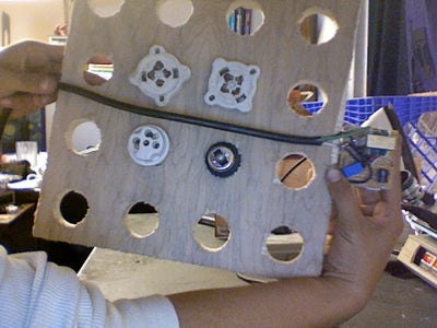

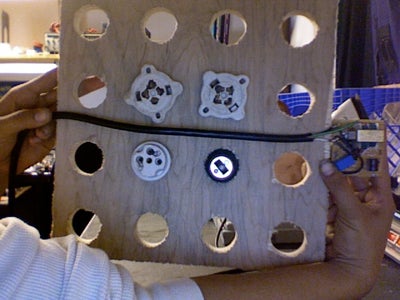

Step 2: Scaffolding
I put sixteen holes on a grid into a plate of plywood.
I started having visions of different microcontrolled sunshine modes, including red, blue and green lightbulbs, and the possibility of playing "snake" on the alarm clock when I wasn't just trying to wake up. Maybe if I added a UV blacklight, I could even get a little sun-tan from my alarm clock, in January in Boston! Hah, music-wakers!
With a little more forethought, and I would have remembered to add a slot for the Mr. Coffee Timer's button/clock interface, and a place to hold a bunch of solid state relays.

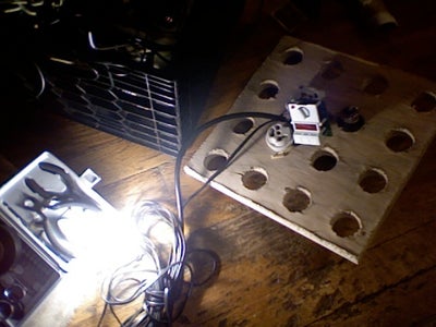

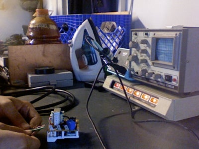

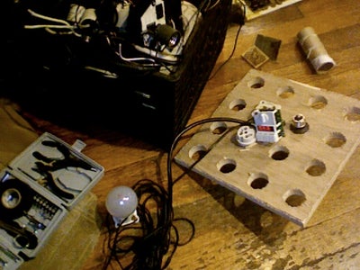

Step 3: Test
To test out if the Mr. Coffee Timer worked, I put the two hot lines on the inputs (marked Line N and Line L), and connected just one lightbulb socket (with lightbulb) to the hot and the "HTR" output.
Sure 'nuff, the thing works! I can switch 120V AC when I say it'll switch! I harness the power of Tesla!

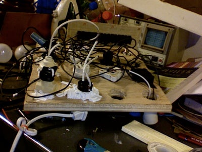

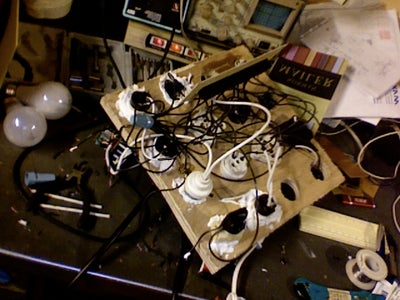

Step 4: Caulk
So, what do 16 light bulbs mostly produce?
A: A lot of heat.
And that's why I can't use hot-glue on these light bulbs sockets!
Don't use hot glue, or do, and find out why.
I normally use hot glue for everything. This calls for something else. The glue options in my house include: hot glue, superglue, wood glue, gorilla glue, rubber cement, and caulk.
None of the rest will really bond sockets to wood holes in quite the way I want, except the caulk. I load the gun with a fine tube of brilliant white acrylic glue with silicone, and smoosh it in big gobs around the sockets, Two hours of curing later, and I have some fine bonds.

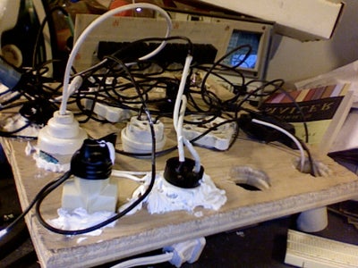

Step 5: Wires
Now, 16 more times!!

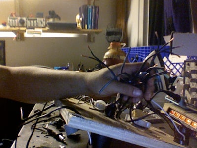

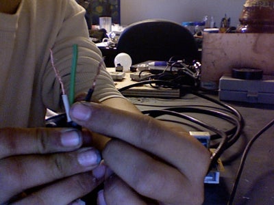

I soldered the incoming power lines (wall plug) on the timer, and then ran separate "hot" and "on" lines to each light socket.
The best thing you can do while doing all that soldering is listen to the Capstan Shafts ask "Negative Man, what's the Anti-matter?" and profess, "You run the disco of my heart!"

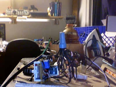

How do you connect 16 "hot" socket wires, and 16 "on" socket wires to the power? WIRE NUTS! They're the best ever! You can just screw them onto a bajillion wires, and bam! They're all connected!
I'll make an insulating plastic box for the timer later. You could use a metal box instead, as long as you grounded it.
About halfway through the wiring project, I think about how little I'd like me or my roommates to get shocked by 125VAC as an alarm clock, and electrical tape everything metal.
That's it! Set the time and go! Wake up basking in the glory of your winter-sunshine!

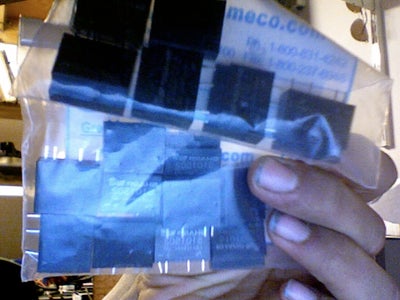

Today this whole stack of solid-state relays arrived! These little guys let you switch really high voltages. I got some 1.5 amp relays for around $3 each on jameco.
I rip the plastic bag and spill the new relays out on my desk like delicious little silicon candies.
Now I can use an AVR microcontroller to program in any light pattern I want! I can wake up to mad-flickering, circle-chasing, vintage "snake", or Times-Square light chaser modes!
If I switch the lightbulb on-and-off fast enough (PWM), I can even get it to appear to dim and slowly turn on.
I can just unscrew one the wire nuts and connect each lightbulb to power via one of the solid state relays. Then, I control the relays with some swift AVR programming, and I'm set to rock & roll!
