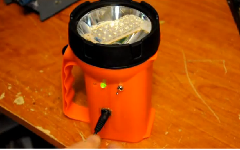

HERE IS THE FINAL PRODUCT:
What The Circuit Does:
Unfortunately, super capacitors can only be charged to lower voltages; typically around 2.5v or 2.7v as a standard.  If you place some super capacitors in series, you can charge to higher voltages, but you lose a tremendous amount of capacitance.  When you plug this device into a wall transformer ((I designed this device around a 9v@1A transformer),  the on-board microprocessor turns on a relay that connects power to the capacitor bank.  The series super capacitors then charge to 5.2v through the relay contacts.   The capacitors an be interchanged to use higher or lower values, depending on how much you want to spend.   The voltage on the capacitor bank is constantly being sampled by an ADC (Analog to Digital Converter) that is embedded in the microprocessor.  When the voltage exceeds a value of roughly 5.2v, a flag trips in software, and the MCU turns off the charging relay, at which point the green LED indicator will start and continue to blink as an indicator to show the user that the caps are charged.  You can leave this device plugged in for as long as you want, and the caps will be very much safe and sound.
When the caps are charged, the user can flip a switch that connects power from the capacitors into a DC-DC voltage booster.  The voltage booster takes the 5.2v from the capacitor bank and boosts it to a calibrated 8v.  The output voltage from the booster can be boosted anywhere from 3.4v to 34v, and is easily calibrated by an on-board 10-turn variable resistor.
Since I've calibrated the booster to output 8v, as soon as you flip the switch, the output of the booster will provide a constant 8v to the LED bank that acts to emit light.  The LED bank is meant for 12v, but works great at 8v, and consumes MUCH less current. However, the LED bank is much brighter at 12v.  The booster will continue to source power to the LED bank until the capacitors drain down to 3.4v, at which point the circuit shuts down.  At this point, if you can plug it in again, to charge back up to 5.2v.
When the booster is tuned to output 12v, the circuit consumes quite a bit more current, but the light output is much greater.   If you're going to consider maximum brightness, you're going to want to use 2x 400f 2.7v caps in parallel with one another.  I also took the liberty of hooking up a $1 LED flash light head that I purchased from the dollar store directly to the capacitors as opposed to the booster, and it lasts MUCH longer.  See the video.

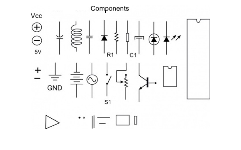

Step 3: Schematic Diagram and Explanation
Before I begin talking about the schematic, let it be known that there are four hardware blocks to this circuit:
1) The wall transformer
2) The charger board (Connected to the capacitors)
3) The voltage booster board
4) The LED bank
You can follow along with the picture, as I will be EXTREMELY THOROUGH with my hardware Explanation.  The wall transformer, booster, and LED bank are all stand-alone products.  The charger board is the circuit that has to be created in order to get everything up and running, so let's talk in detail about the charger circuit.
THE POWER SUPPLY:
As you can see, the power supply circuit is relatively simple.  We have our DC power jack that connects to the wall transformer.  This voltage source provides power to the capacitor bank through a current limiting resistor bank and a diode.  As well, this 9v source is connected to a 7805 5v regulator.  The output of this regulator is a smooth 5v, which acts to power our micro controller (PIC10F222), as well as our 5v relay.   This regulated 5v source is labelled VCC in the schematic.   There is a 10uf capacitor on the input of the regulator, as well as on the output.  These caps are just used to stabilize the output.  There is also a 0.1uf capacitor on the output that is used as a decoupling capacitors.  It acts to filter out any unwanted noise at the output; high frequency spikes, and what not.
THE CAPACITOR CHARGING RELAY AND DRIVER:
When power is applied, pin#4 of the PIC10F222 goes from 0v to 5v, which activates the relay through a simple driver circuit.  I've used an NPN transistor (2N2222) and a 10k resistor.  When 5v is applied to the base of the transistor through the 10k protective resistor, power from the collector sinks through to the emitter of the transistor, which is connected to ground.  The collector is connected to the relay coil, and to the anode of a 1N4001 diode.  I'll get to the diode in a second.  The secondary end of the relay coil is connected to the regulated 5v supply (VCC).  When the base of the transistor is activated, power sourced by our VCC line sinks through the coil and through the transistor to ground, and therefore completes the circuit.  The coil is then magnetized, which acts to switch the common pin of the relay (CO) to the normally open pin of the relay (NO).  When the microprocessor turns the relay off, the magnetic field along the relay collapses, and a large voltage spike occurs.   The cathode (negative end) of the diode is connected also to our VCC 5v source.  The diode acts to protect the circuit from this voltage spike.  It is very necessary.  Make sure that you don't place the diode in the wrong way, or else you're going to have a short circuit when the relay turns on, and that will reset your device.
The common pin of the relay is connected to the cathode (negative end) of the 1N4001 diode on the power line, just after the resistor bank.    This diode is to ensure that there is no back powering from the capacitor bank.  This diode will ensure that current will only flow into the capacitor bank from the power supply, and not backwards from the cap bank into the power supply or regulator.  When the relay is activated, the common pin connects to the normally open pin (NO), which is connected to our capacitor bank, which enables the charging of the capacitors.  When the relay turns off, the common pin is re-connected to the normally connected (NC) pin of the relay, which cuts off the charge to the caps.
THE MICRO-CONTROLLER AND THE ADC:

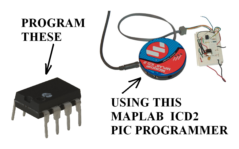

I've chosen the PIC10F222 for this project.  This is a programmable microchip that I've programmed in my lab at home.  It requires a regulated 5v (VCC) on pin#2, and our DC ground to pin#7.  I employ only three of the four onboard I/O ports.  The first is  GPIO1, which is configured as an output (Pin#4).  This acts to activate/deactivate our relay.  The second I/O port is GPIO0, which is pin#5.  This pin is configured as an input, and is programmed to work as an analog to digital converter (ADC).  When the power turns on, the relay turns on and charging commences.  From there, the ADC is constantly sampling the charge on the caps through a resistor divider network made up of 2x 10k resistors along the charge line after the diode.  Why is this needed, you ask?  Since we'll be requiring that the capacitor bank be charged to more than 5v, we need to divide the voltage value on the caps in half, as if you place a value higher than 5v on the ADC line, you're going to damage your chip.  With the resistor divider in place, the ADC will see half of that voltage only.  In programming, the ADC is looking for a voltage higher than 5.2v, so as soon as the voltage  on the caps reaches 5.2v, there will be 2.6v on the ADC line.  The second the charge on the caps reaches this charge level, the MCU instructs GPIO1 to go LOW, which turns the relay off and disables the charge to the super caps.  Lastly, GPIO2, which is pin#3 acts as an output, which acts to flicker the green LED indicator on and off when charging is about to commence, and when charging has completed.
THE INTERFACES:
There has to be a good way of connecting our capacitors to the charger board, as well as our booster board and LED bank.  There are two (2-pin) terminal blocks that can be used for the two capacitors, and a 3-pin terminal block for the LED bank and the booster.  The 3-pin terminal block has two grounds, and a lead connected to the positive lead of the capacitor bank.  The positive lead of the capacitor bank will be connected to the VIN (Voltage input) of the voltage booster.  One of the ground pins can be connected to the GND (ground) pin of the booster board.  The output pin of the voltage booster can be connected to the RED (Positive) wire of the LED bank, and the BLACK (negative) wire of the LED bank can be connected to the secondary ground pin of the 3-pin terminal block on the charge board.  So now ALL ground are connected.  This is very important.  The power of the capacitor bank is connected to the input of the voltage booster, which we have calibrated to 8v.  The output of the booster, which is boosted to 8v, is connected to the LED bank, which provides it power.  The booster will keep boosting to 8v until the voltage on the capacitors runs below 3.4v.
Step 4: The Software
The software that can be programmed into the PIC can be found here:
http://www.electroniclessons.com/Capcharger.txt
However, I have the main source code commented below so that you can follow along with ease =)  I used my trusty MPLAB ICD2 PIC programmer to program my PIC.  You don't need this programmer specifically, but you will be requiring one of the 1000s of PIC programmers that are available out there.  The PIC ICD2 can be purchased through http://www.microchip.com.  You can also google MPLAB ICD2, and you'll likely be able to find some deals.  It is very easy to use, and you can use any of my source codes by copying and pasting the templates that I provide in my instructables.
Here is the commented main source code:

    Hi great project thanks for sharing,just wondering can i use PIC12F683 chip instead
