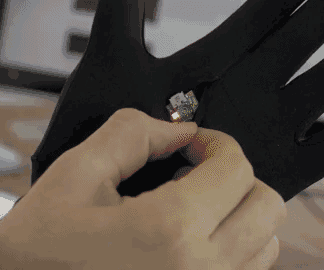

Introduction: Bluetooth and IMU With the Tactigon Board - Arduino
This series of articles will explain how to use The Tactigon’s integrated sensors and communication interfaces to create a simple gesture controller.
Source code available here on GitHub
In this article we’re going to learn how to use simple Tactigon’s functions to send accelerometer data and quaternions over Bluetooth Low Energy (BLE from now on).
