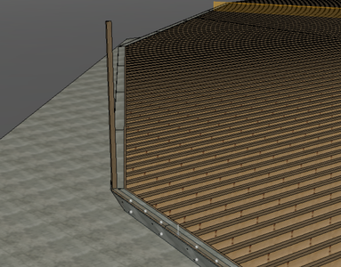

For my floor joists I used i-beams, which consist of two narrow strips of wood sandwiching a tall strip of wood, resembling a very tall hamburger. I patterned the i-beam and cut it to fit the hexadecagon. As I drew out, I covered a quarter of the floor with these joists and then used the circular pattern to make 4 groups of them, covering the entire first floor.
Around the perimeter of the ground floor I sketched and extruded precast concrete parts to protect the edges of the joists from weathering. I used the rectangular pattern tool to cover a side, and then circular patterned the concrete around the ground floor.

After all the joists were in position and I had joined the precast concrete parts with the loft tool, I distributed studs around the outside and inside of the ring. Online I found that stud spacing should be around 400mm, so I followed this spacing when I used the rectangular pattern and circular pattern tools (once again, I mirrored the studs first and then used the circular pattern to create 8 copies around the ring).
The floor consists of a lower layer of plywood and an upper layer of concrete tiling to protect the plywood.

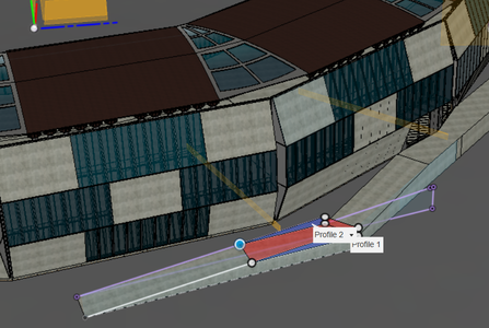

Step 20: Balconies
The balconies on the third floor allow those living in the upper levels of the building to view the core of the Eye from above. I first sketched and extruded a concrete platform and supported it from below with steel forms. I then swept a glass fence and railing around the platform and finally covered it with a mahogany awning, shielding the balcony from the harsh sunlight. I used the circular pattern tool to make sure every room had a balcony attached to it.
